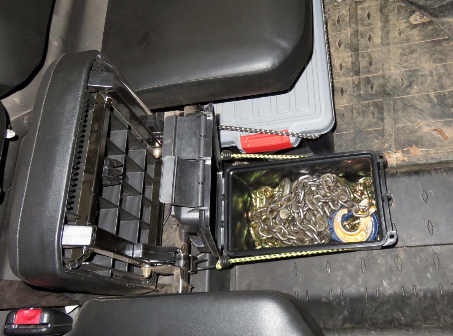

In our UTV, we purchased a plastic ammo box and store in beneath the seat as seen in photos. There are 2 choker chains in the box, one rather short and the other 15ft long. Yes they are smaller gauge chains for UTV use. 5/16 grade 70

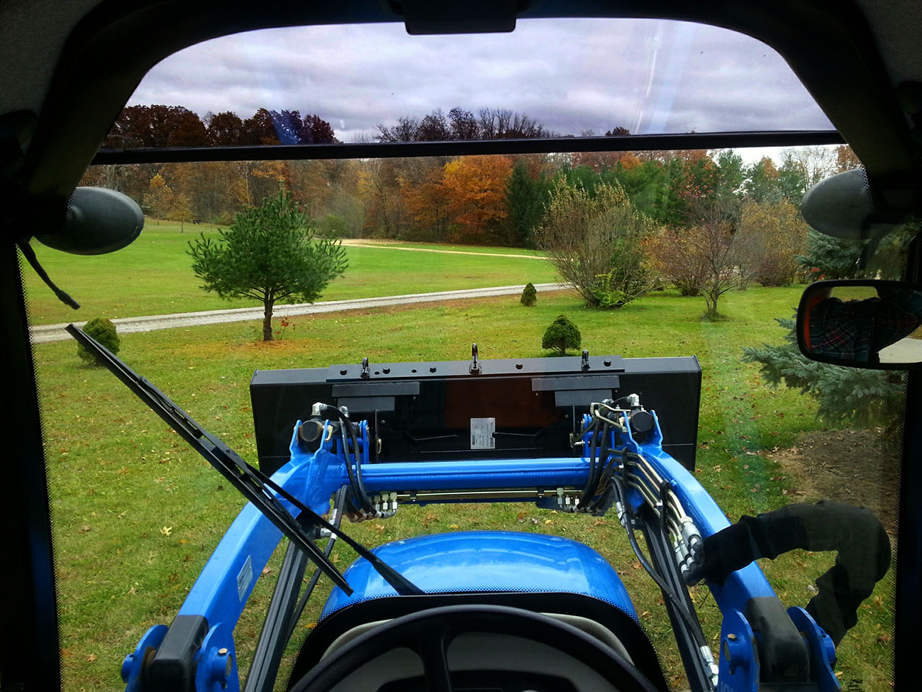

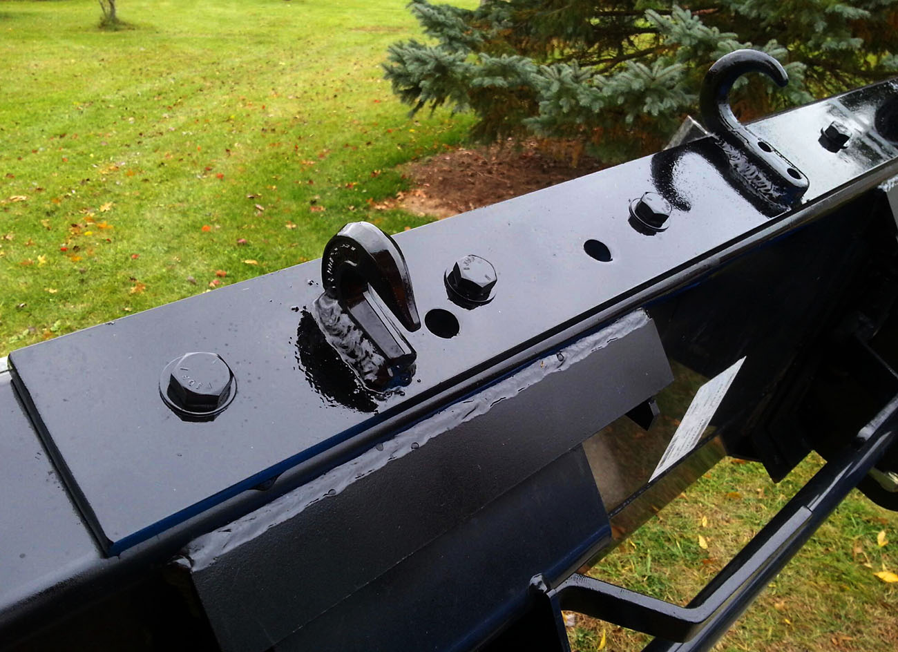

So many great ideas. Since fabricating a long steel bar that I welded on 3 seperate hooks that are bolted to the top of my loader I always keep a 16' long 3/8" chain looped around the outer two most hooks nice & tight. Works well because the chain is never inside the bucket, tight enough not to rattle around and scratch paint and is always available to pull someone of something out. Don't have a pic of the chain wrapped around the hooks but here is the newly installed bar stock & hooks.

Nice fabrication job!
Maybe a slight risk, but one I'd stay alert for, is the chain loosening and dropping down off the hooks onto your hood unexpectedly when the bucket is raised to full extension and rolled back.

Thanks ! That is a very good observation and something that I will certainly keep an eye out for and had not considered even though I try to keep the chain pretty tightly wound.
