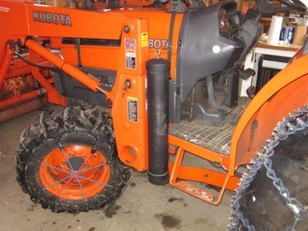

I also learned this trick here on TBN. Four inch dia. PVC bolted to the loader arm supports. I have chain in the left one and rope in the right one. Drain holes in the bottom.
How did you bolt them on? reach down from the top some and then up from the bottom before you cap the pipe? Nice ice chains bty I use duel ladder style on my bota good job.

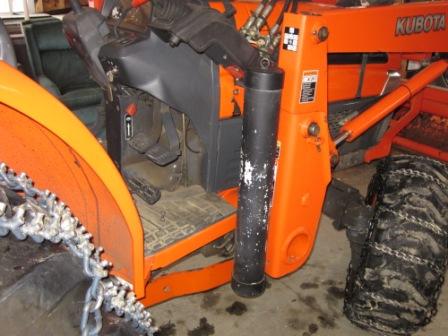

Because of this forum I came up with my version of some one else's great idea. The upright for the loader assembly has holes in it at the bottom. I used six inch PVC thick wall pipe with a slip end cap, glued on of course. The cap has a drain hole in the bottom I drilled. Two large bolts go through the loader frame into two holes I drilled in the six inch pipe. At the top I fabricated a brace bracket out of flat stock. I am really pleased with it.
Nice work I need to attempt something I have seen a couple like yours and I think that way is the ticket. The only difference is I may do it to my Farmi winch instead. That is when I need my chains most often. For every day yanking I keep a 5/16 x 10 ? on the floor by the rear diff lock lever.,,,but it bugs me by moving around some.

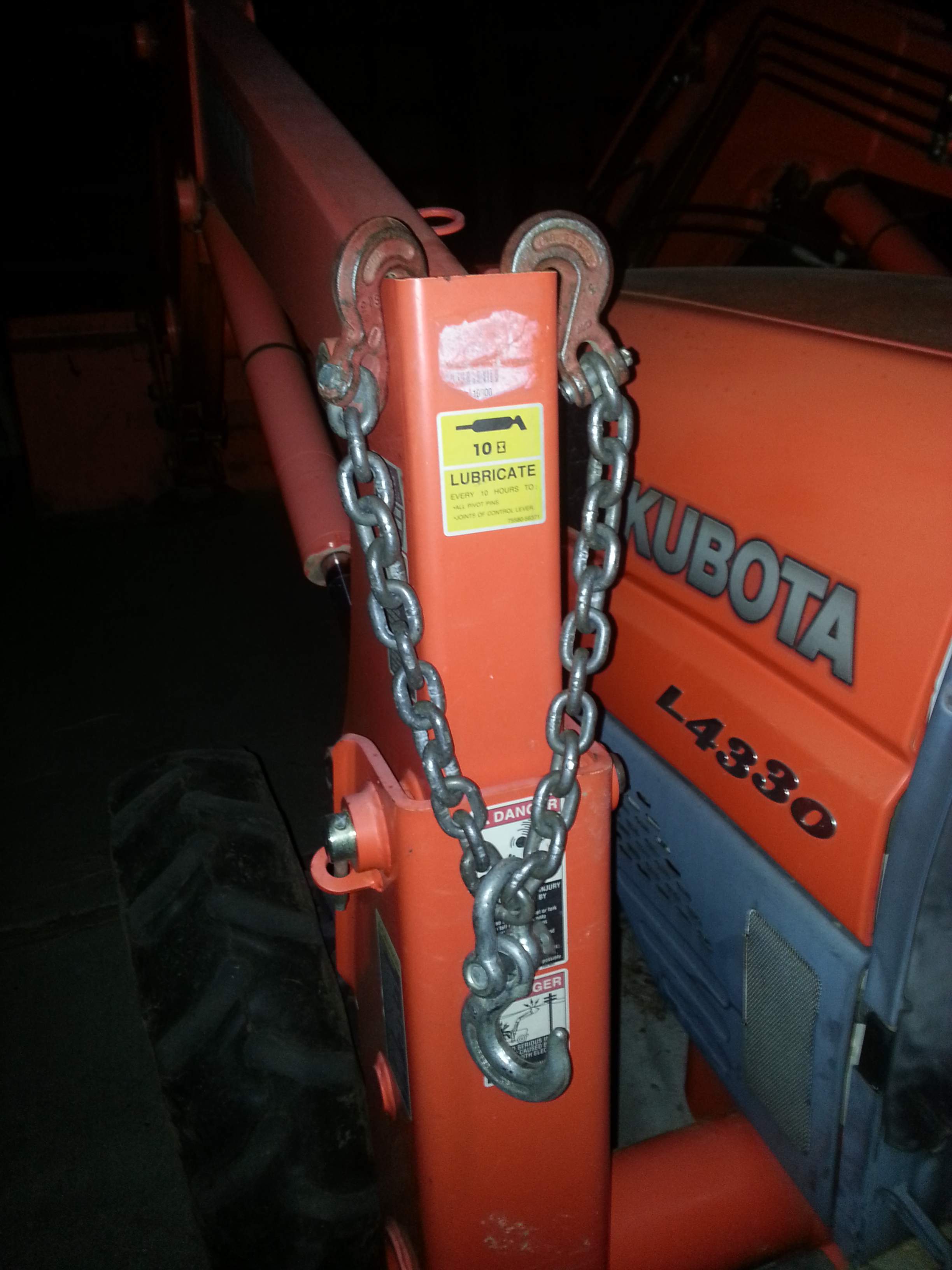

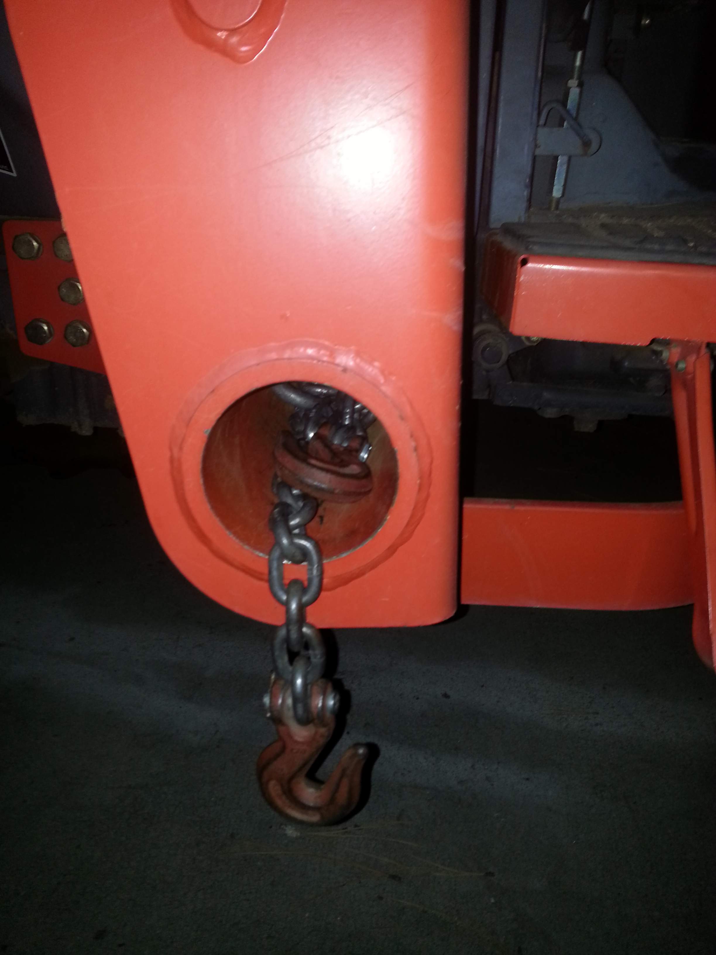

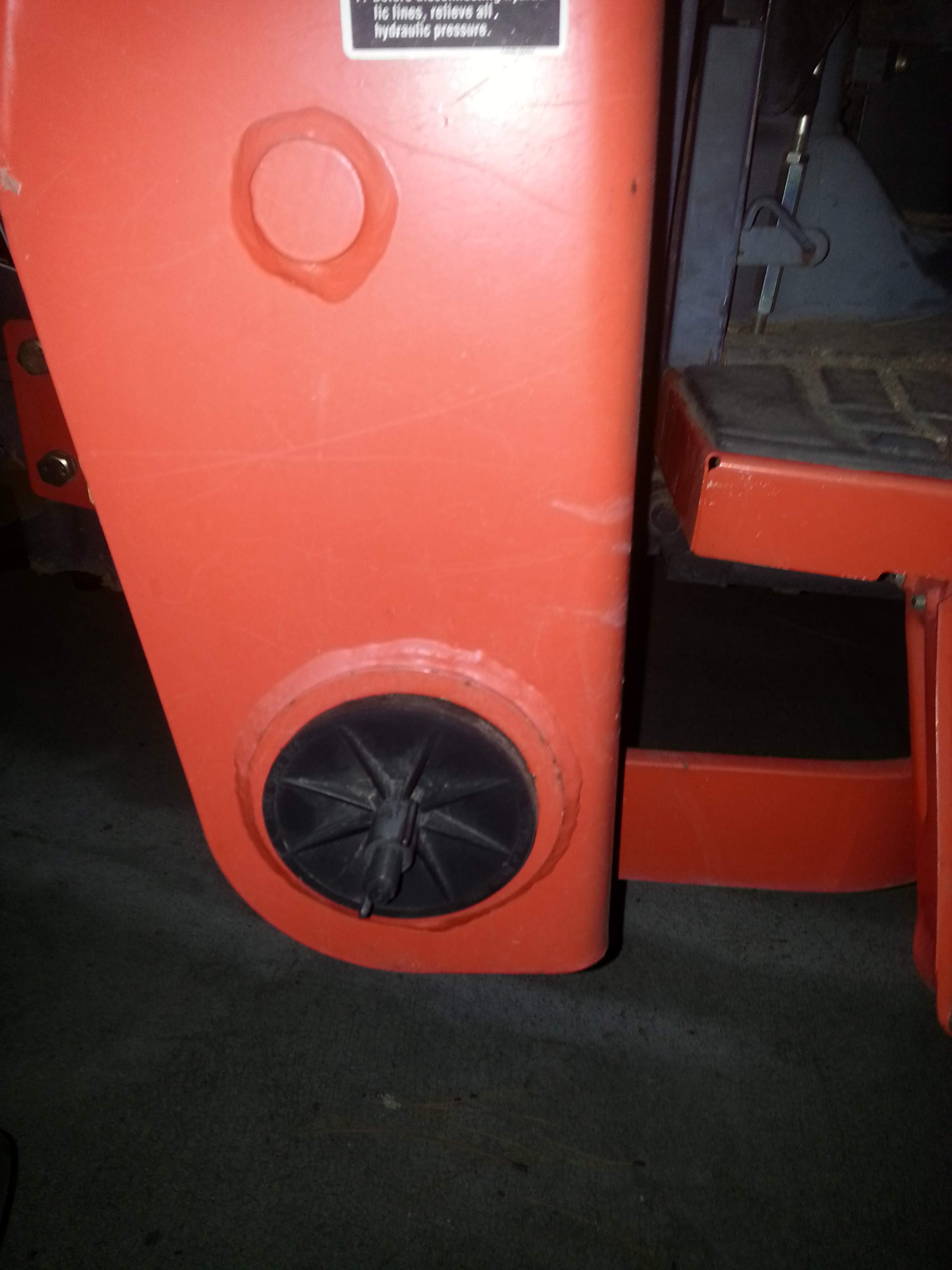

I have a Kubota Grand L 4330 with the LA853 loader. I seal the tubes on the bottom of the loader frame with 4" pipe plugs and store my short chains in there. But, make sure that you plug the back side of these tubes as well, or your chains can slip out. Because of the tight space there I had to disassemble the inside plugs and reassemble them in place.
I have a short chain that I use all of the time. About 2 feet long, with grab hooks on each end, and a slip hook on a clevis. This fits securely in the tube on the left side, right where I need it as I climb off the tractor.
On my tractor there is a long tube brace between the loader arms but it is of a slightly larger diameter. You can sleeve this with 4 inch PVC and use standard pipe plugs there too.

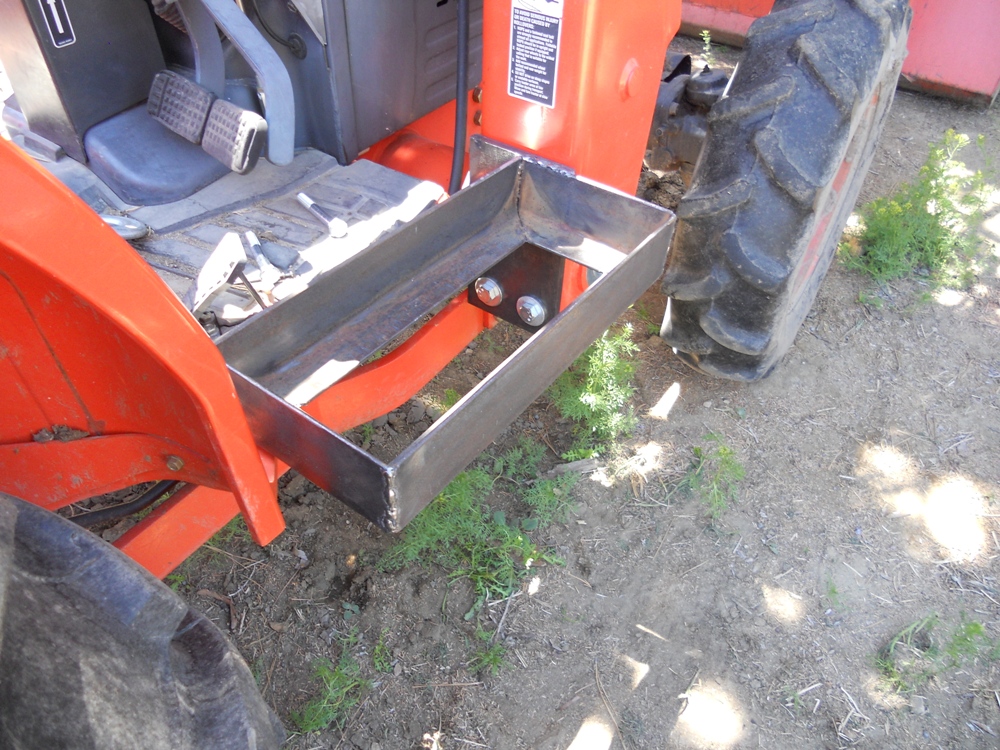

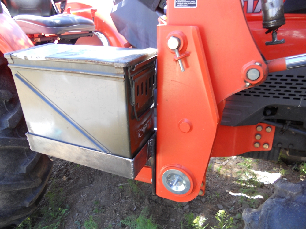

I also fabricated a mount for an ammo can, fits perfectly for the location to the right of the floorboard. I never climb on the right side anyway because of the loader joystick so it was dead space. Haven't painted my mount yet because i am still brainstorming what else to add to it. I designed it to attach to the loader frame using holes that were already there.

I too have the hollow tube Idea.... but what did you use to plug the hole up ? That black gadget looks familiar but I cannot place it ? Thanks Jeff
