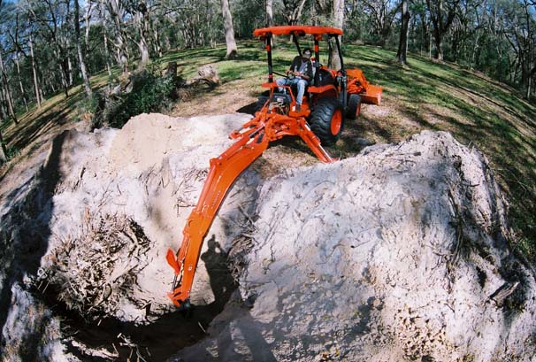

Our Kubota L-39 injects a good dose of "Stump-B-Gone" on a six ton stump! :D
