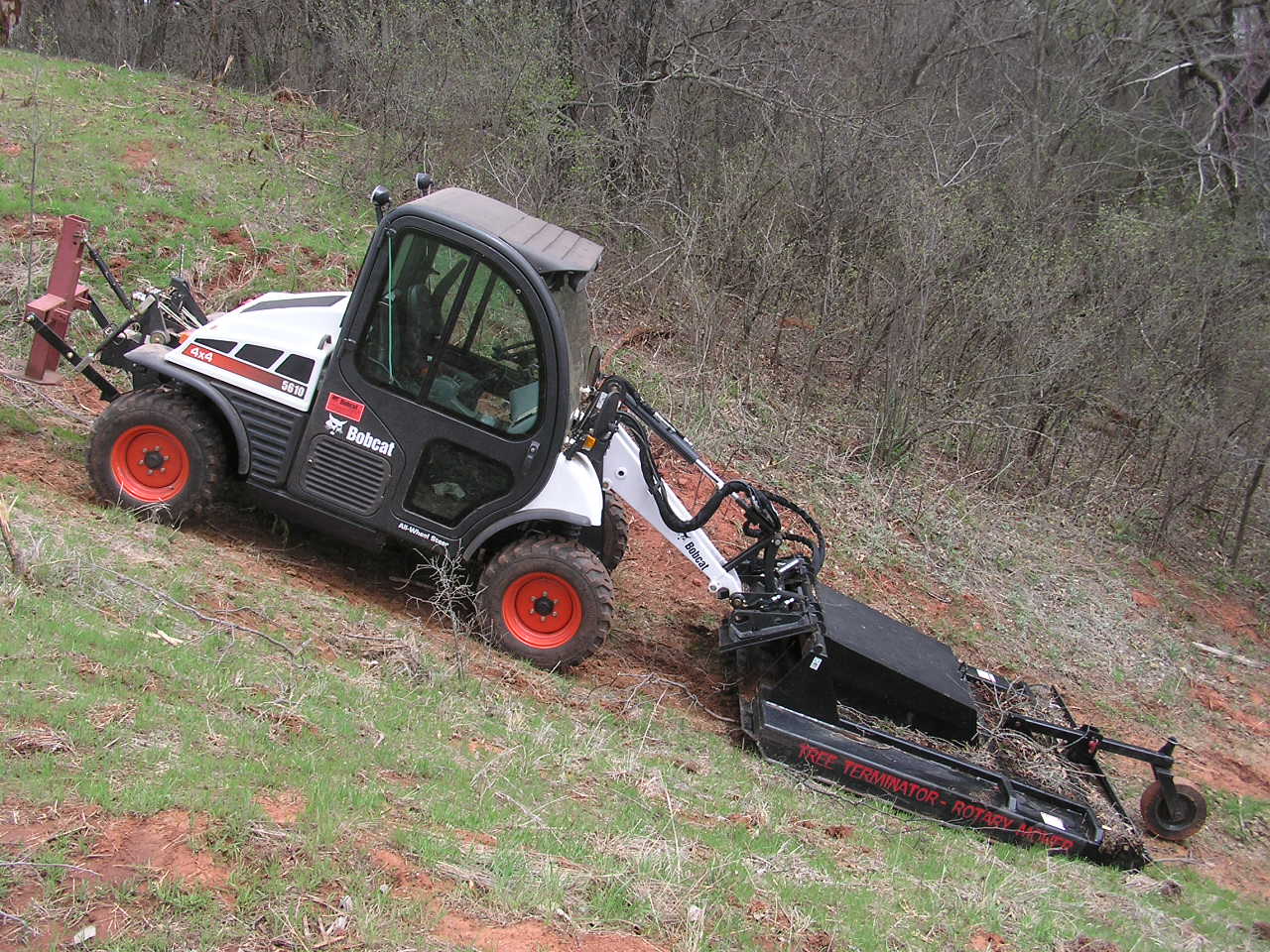

Four wheel independent suspension, four wheel steer and four wheel drive.
Don't worry about side hills!
Anything steep enough to roll it, I would be too puckered to drive on! :laughing:

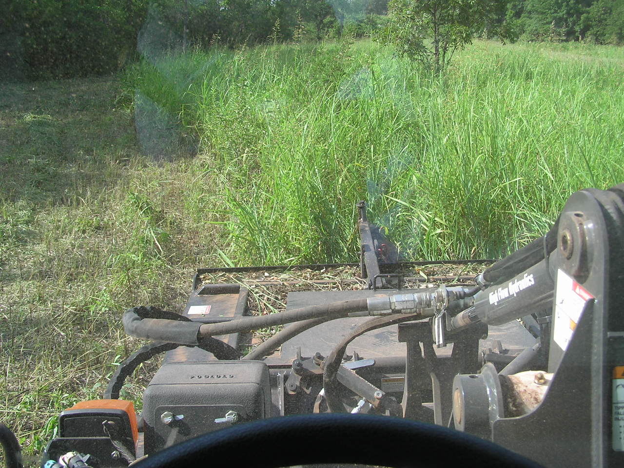

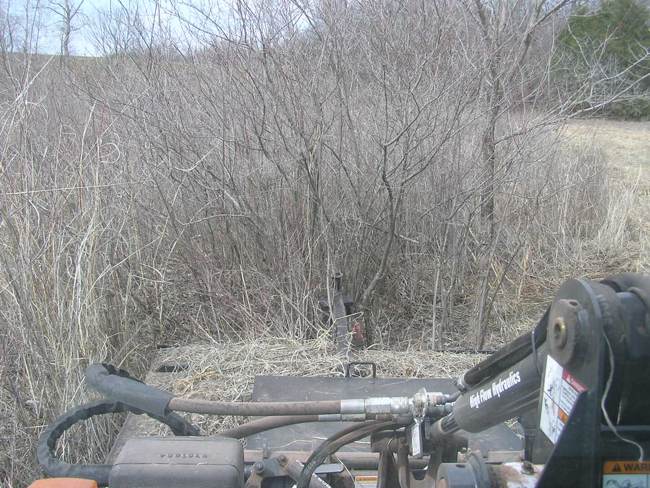

Out front 7' brush hog, easy to see what you are cutting.

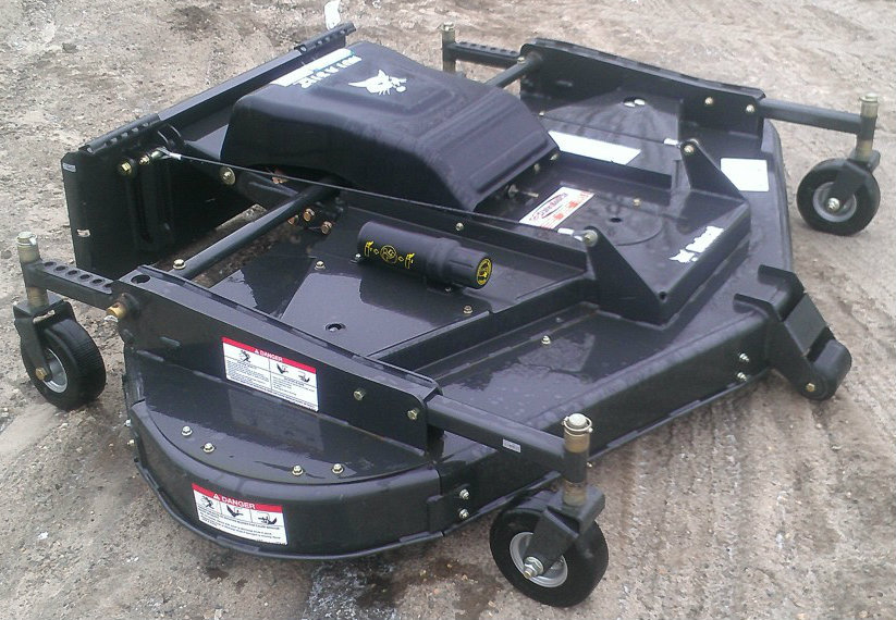

For grass and small brush, use the 90" Finish Mower out front. Mower Attachment - Bobcat Company
This picture from Google Image Search.

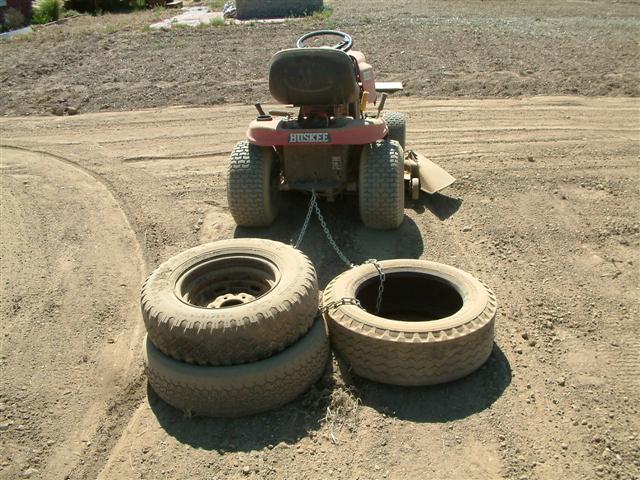

3) Use my Huskee riding mower and a tire drag to bust up the large clods

4) Use a carpet drag to smooth and level the surface

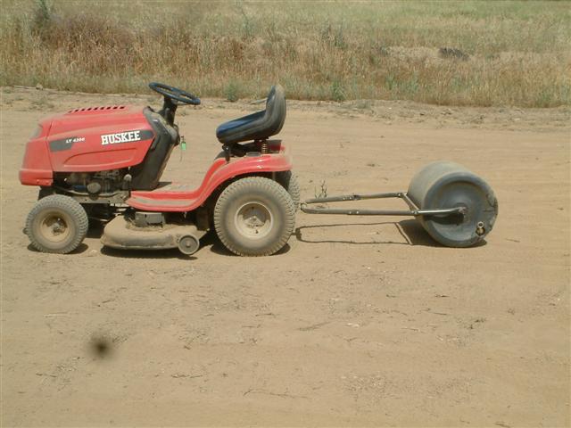

5) Use water-filled roller to compact the soil
I used the riding mower for the finishing steps since the Kubota has ag tires that would mess up the planting surface.
