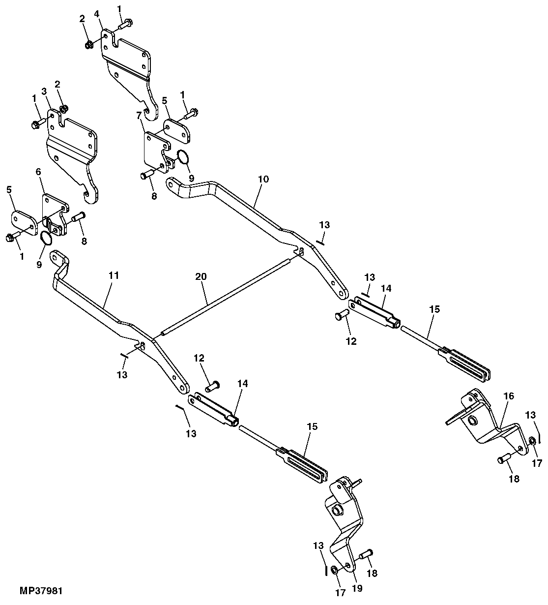

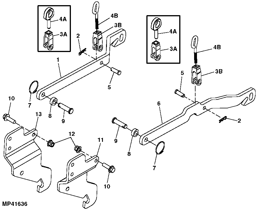

   / How do you like your 62D drive over mower deck? #28
They are totally different.
Greg
   / How do you like your 62D drive over mower deck? #29
JeffinNE said:
From what I understand there are 2 different 62D mowers----one fits only the 2320 and the other fits the 2520 and 2720. Supposedly the 62D for the 2520 won't fit on a 2320?
The deck for the 2320 will have the model number "62D1", while the one for the 2520/2720 will be a "62D2". I believe one of the differences is the positioning of the ramps because of the different front wheel track width.
