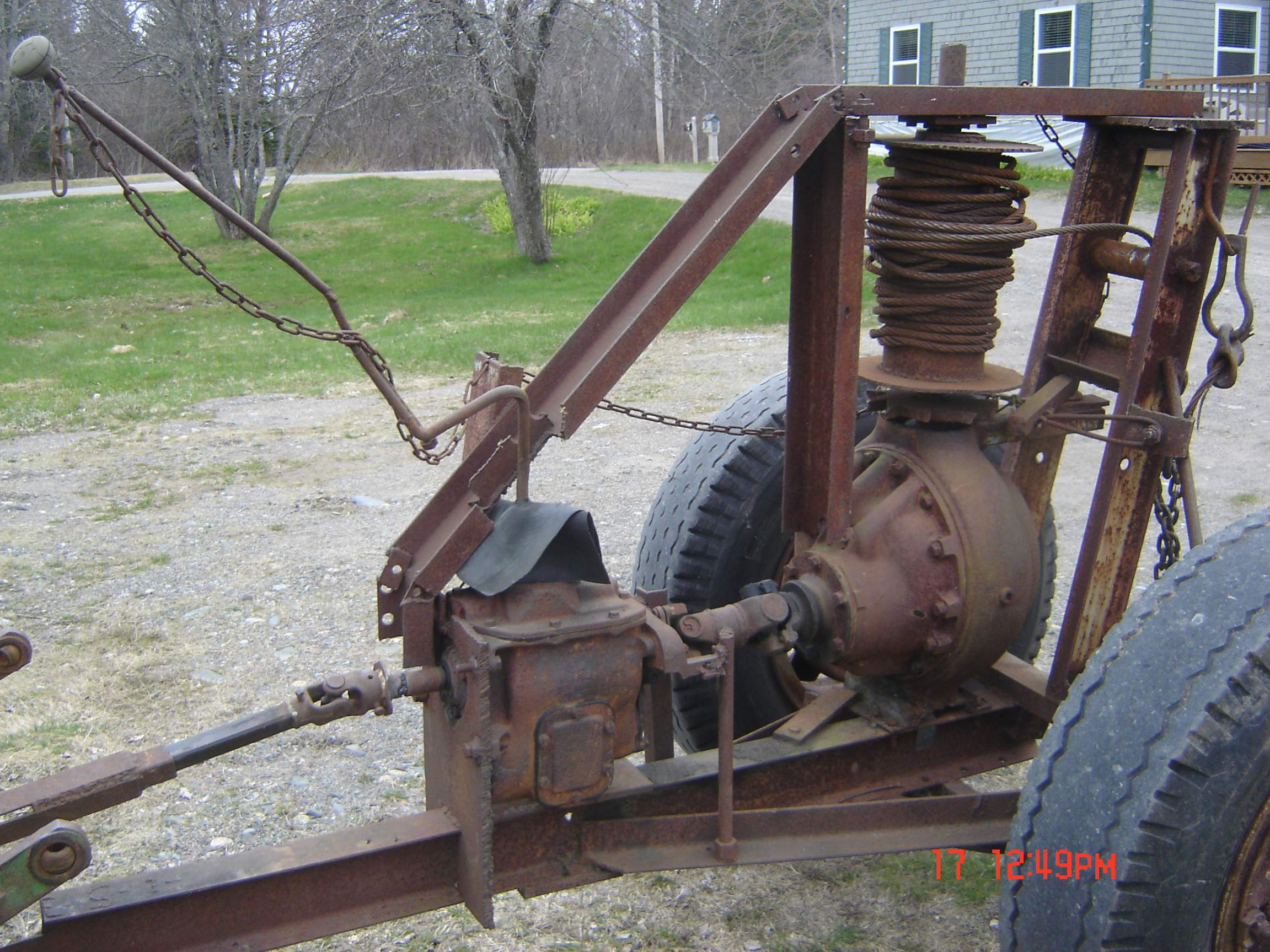

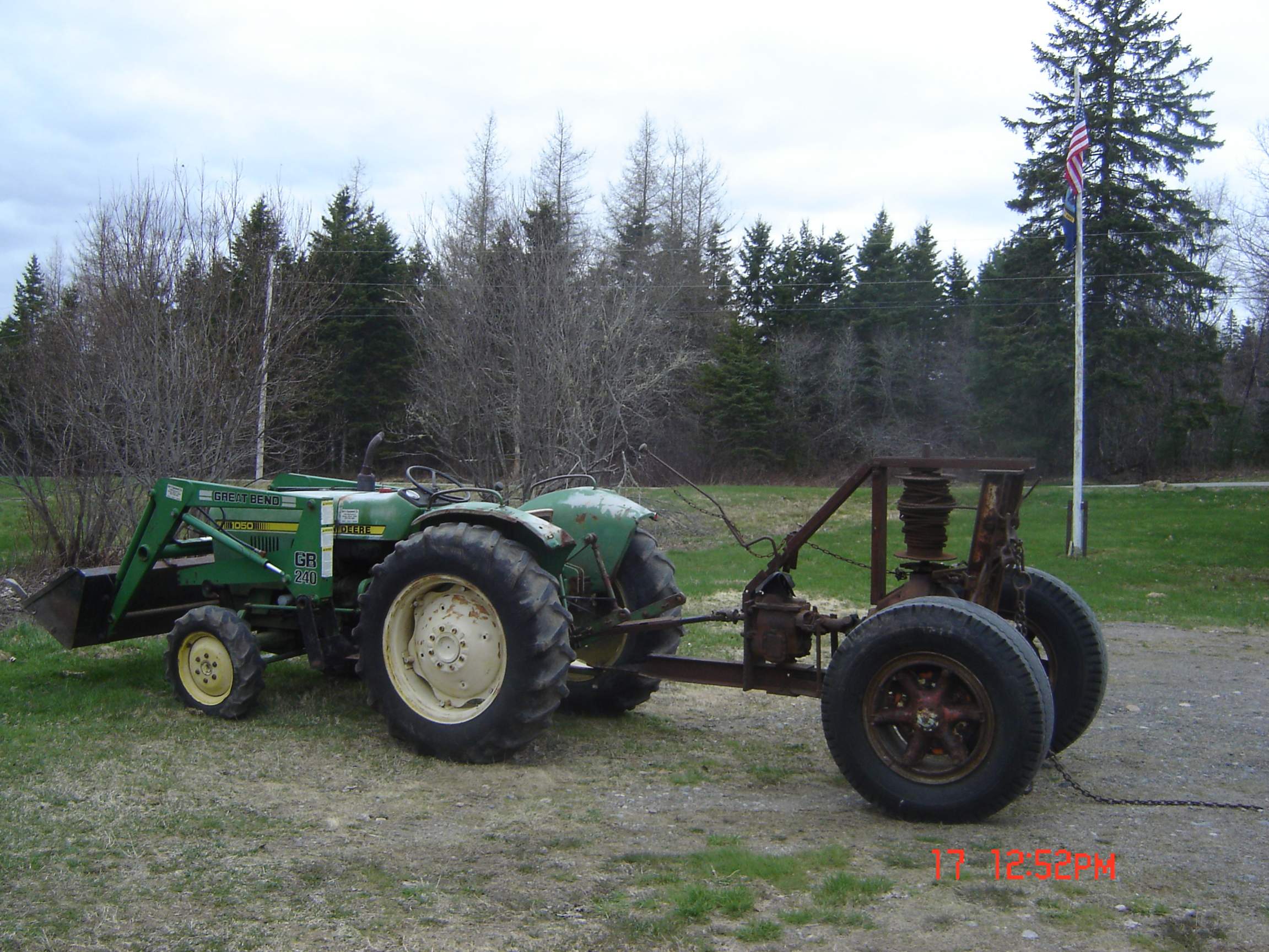

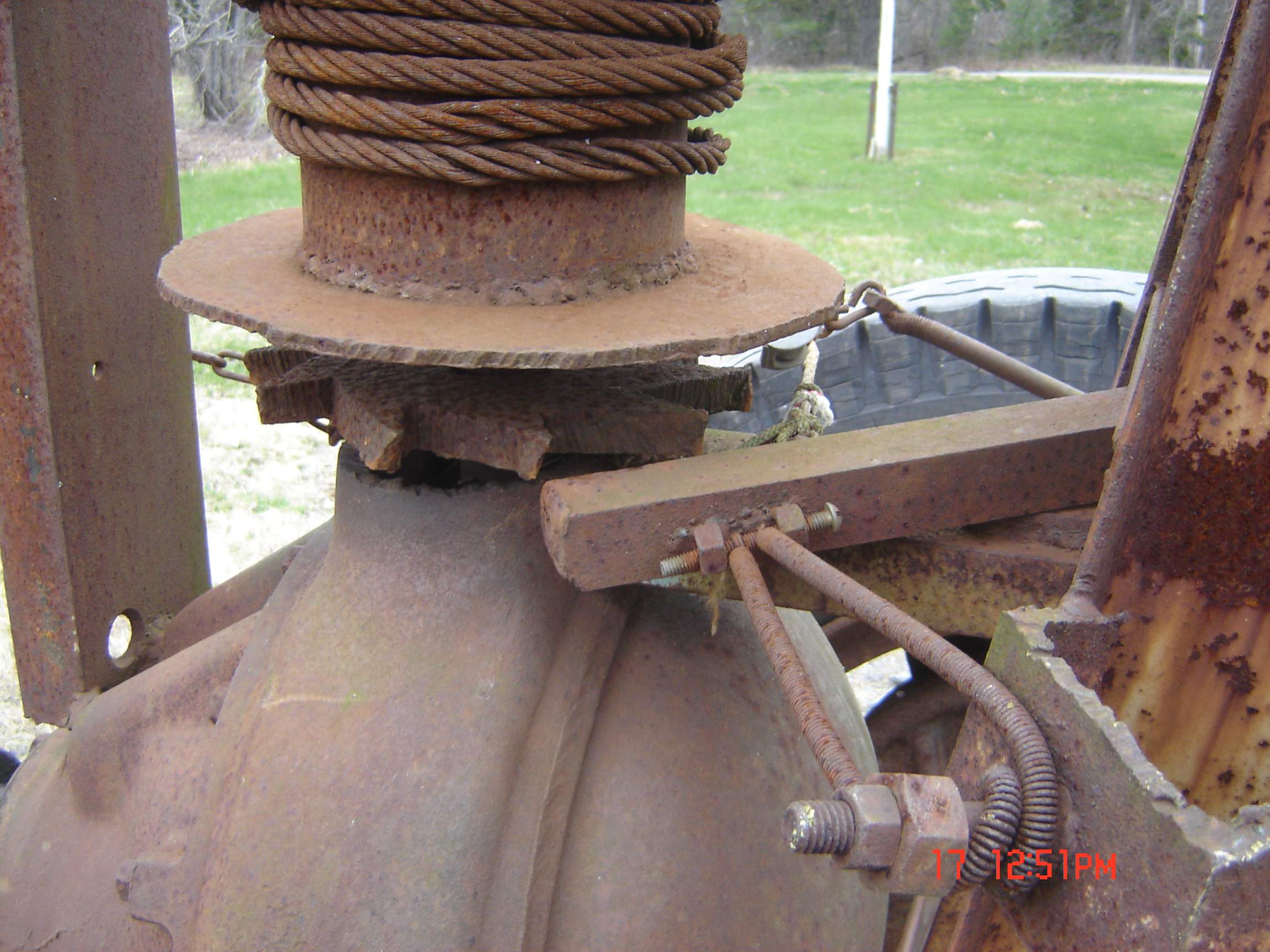

I needed a winch about 30 years ago and didn't have the budget. But, I did have a welder, torches and access to lots of scrap and old parts, so I made a winch. The arch is a narrowed front end off a 1950ish GMC tractor. The winch is made from a 67 chevy pickup trans with granny low and a rearend out of a 53 International schoolbus. One side of the rearend is capped off to keep the grease in and the is axle welded to the cap, forcing all the rotation to the top axle. Winch drum is well casing. Drum lock works like a come-along latch - click, click, click when winching. The butts of the logs are lifted off the ground and the weight transfers to the little trailer arch. If the ground is good you can skid 5 or 6 trees at a time. Never tried to figure out what it's capacity is, but I can tell you that it will winch a white pine 3 foot at the butt and 50-60 feet long if you wedge a rear tractor tire against a treee. Turns a 35 hp tractor into a mini skidder.

I like it. None too pretty, but it looks like it really pulls. And very little risk of standing your tractor on end.
