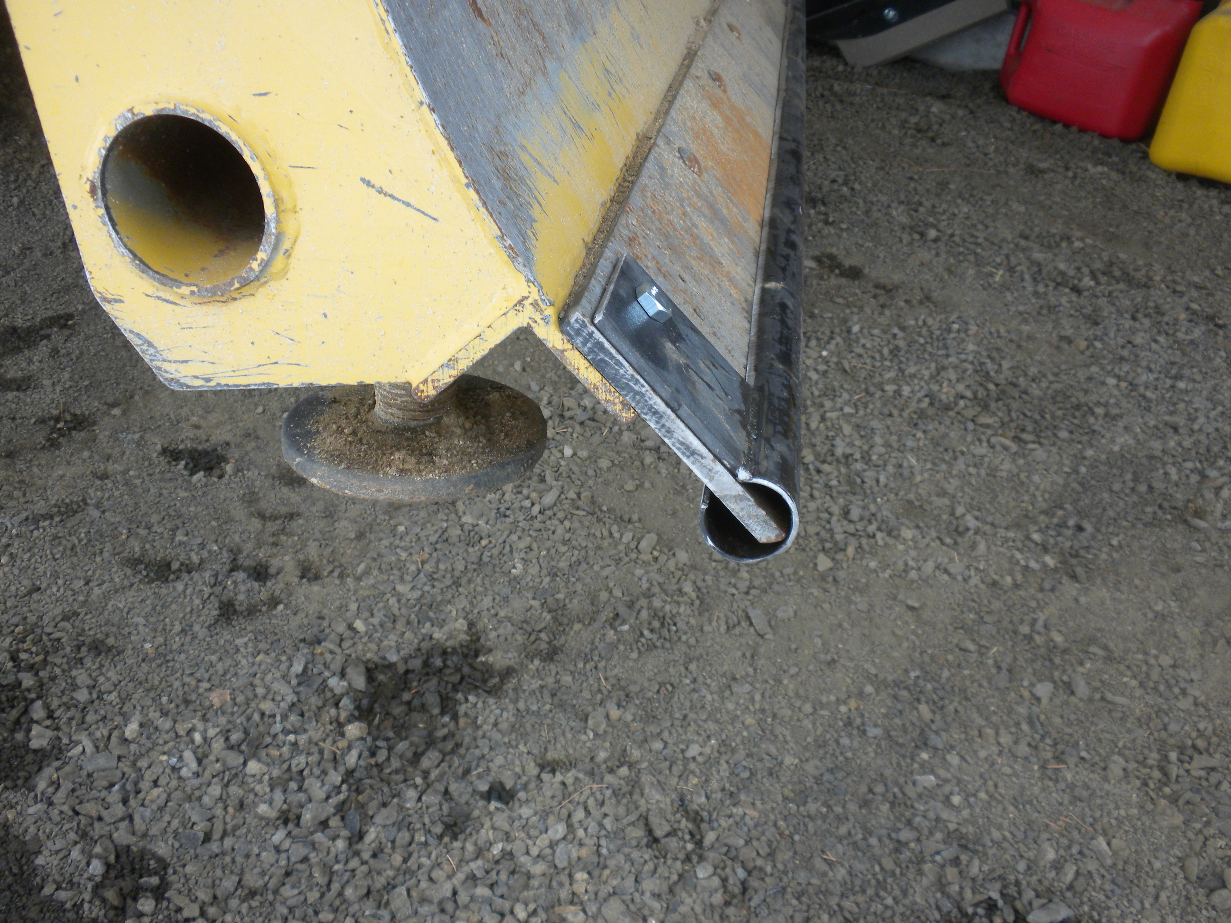

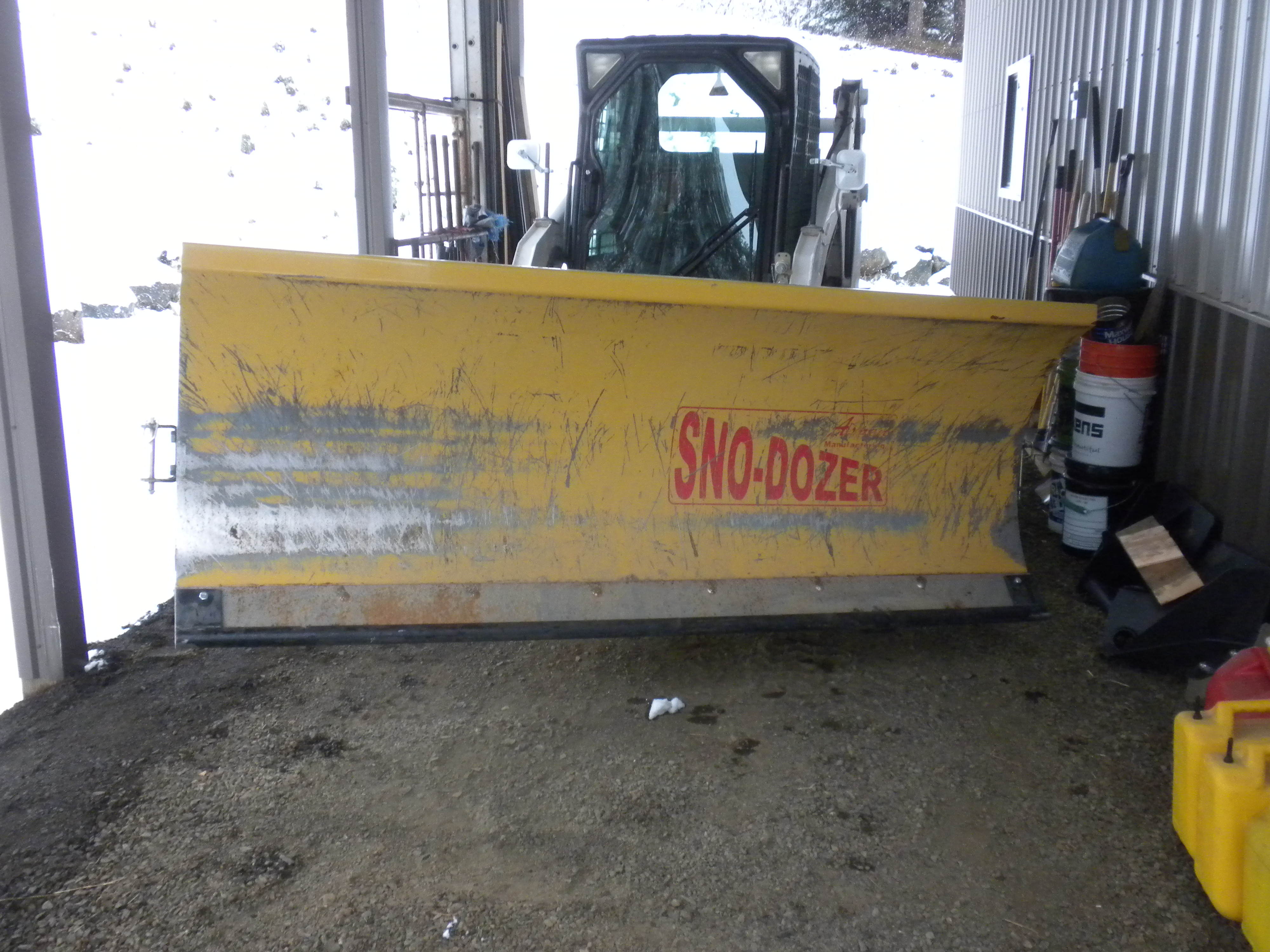

As others have noted keeping the gravel on the driveway is the key - but easier said than done it seems. I use a plow on the skid steer for Nov and Dec and then put on the blower when it gets deep. (159 inches so far this season and it's snowing now March 22). I had this guard built (see pics) so the cutting edge doesn't dig in so much and it helps some.
It's the first couple plowings that are the killers. If the ground isn't frozen, the first snows are usually wet slop and even with shoes and the guard a blob of heavy sticky snow is sliding well ahead of the blade peeling off gravel just by its weight. If the ground has frozen hard at the first snow the frost has lifted up the top layer of gravel and it gets peeled off when plowing that first snow even if it's pretty dry stuff.
Aside from the looks of lost gravel I'm battling invasive annual grasses which are far more trouble for me than weeds. That extra gravel on the shoulder causes problems for the good grass that's there and makes a happy spot for the invasive stuff. So, I'm usually trying to get the lost gravel back. When it goes down over the fill slope it's pretty hopeless. I've done the rake and puke method that somebody mentioned and the glamour goes out of that pretty fast. I hadn't thought about the blower so I'll give that a shot.

I slit a piece of 2-1/2 inch pipe, to go over the cutting edge. It didn't push much gravel into the yard. I was very pleased with the results!
   / How Do You Get Driveway Gravel Out of Grassy Areas? #53
Mine is 1 1/2" pipe and if I was doing it again I'd go larger diameter like yours.
