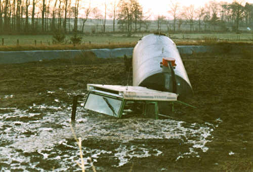

Wow I don't think I would want the tractor after that. Whew what a mess!
You gotta tell us if the tractor and trailer were salvaged or not.

That looks like a manure pit. Yuck!
