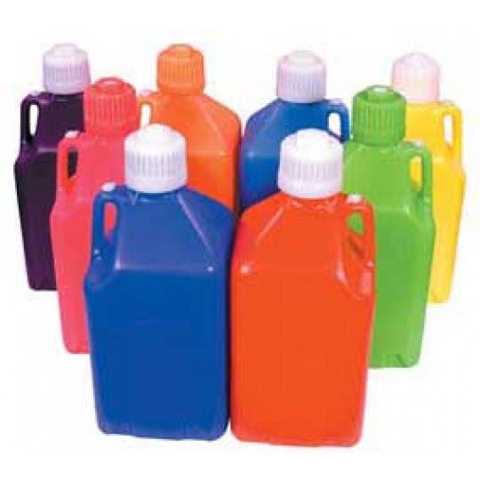

While my tractor is easier to fuel since its on the fender; I'll still add in what I use. I just got the tractor and needed some diesel cans and hate all the CARB compliant ones. I did some searching and came across racing fuel cans. Since they are not "designed for transportation" they don't require the auto vent and have a real open vent. The ones I bought came in tons of colors (got yellow) and with a long filler hose that I can get in place before fuel flows. The caps on them are also very heavy duty. They were a little pricey, but well worth it. I dump all 5 gallons in a minute or two.

I think this is what dmbtree82 mentioned. I use a couple for small engine gas and also when we go camping. They work great.
   / How do you fuel your tractor (logistics, not finding the cap to the tank)? #204
Pretty close to the above picture with a nice long hose as well.
