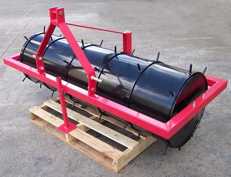

I've got a Ballast Roller to compact my horse paddocks after tilling/seeding.

Building a drag seems like a good way to get some weight on top of it, but it seems like it might have the same problem I'm having with the bucket? Maybe its just my type of soil? Its mostly dry here now. We had rain/ice a little last week, it was dry while I was filling some other holes this weekend, raining a little today, probably dry again by next weekend. The soil on the surface ends up sort of powder-ish. It doesn't pack well enough to have something slide over it I think. That roller looks pretty slick but I bet its out of my price range. I thought about building something like that a while back. I've got an old semi-rusted out propane tank. But I don't know how I would ever center up the bearings on the ends to make it roll evenly...

Thanks. We were typing at the same time. I was beginning to think a roller was maybe the best solution for my type of soil.
As for the road. The main road coming in is a whole different deal. I've got to completely rebuild it, but later on. I will likely be calling on the assistance of tbn for that one too. But this part of the property is around the house/yard. It was smooth when we bought it, it wasn't until I started doing tractor work and stirred everything up it seems that this happened. But I suppose it may have been smooth just because it sat for a while with no traffic on it. Maybe I will just have to deal with filling ruts from now on in this area? If thats the case, perhaps a roller building project needs to be in my future. Man, that project list is getting huge. I've already promised more write-ups here on tbn than my camera has room for. I better get to work
