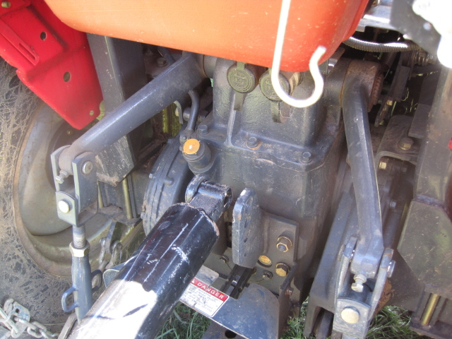

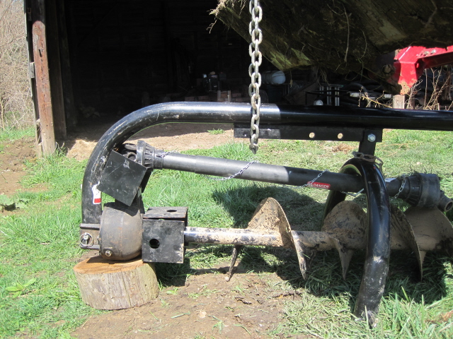

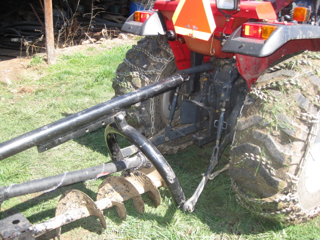

I struggled with attaching my PHD to the tractor but I think I found good and easy method now. I lay the PHD flat with the gearbox supported such a way that end of the top arm will be just about at the height of the top link bracket after the draft links are connected to the draft pins. (Pic 5 and 3).
Then I lift or lower the three point, move the tractor forward/backward or push the PHD until the top link bracket is aligned with PHD top arm.(Pic 4). No heavy lifting or brute force is required.

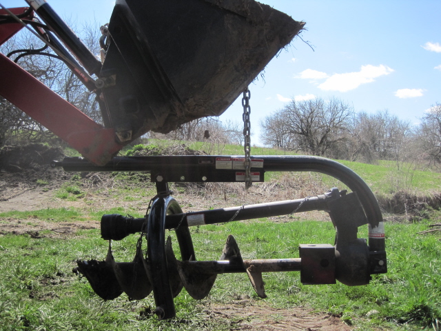

The trick is to figure how high the support under the gearbox should be before you take the PHD from the tractor.
To take it off the tractor I put the tip of the drill bit on the ground and lower the three point to the lowest position and slowly back the tractor. It will fold the drill bit and lower the PHD arm to horizontal position. Then I measured the distance from the ground to the gearbox and added about 1.5" to it. I cut the support from a large post and placed it under the GB. Then I somewhat lifted the three point so there was not tension on the top pin so I could slide it out. While the PHD was on the ground and disconnected I chained the drill bit to the PHD arm so I could lift it chained to my FEL and place in the shed.
I used to have the PHD hanged but this works better.
