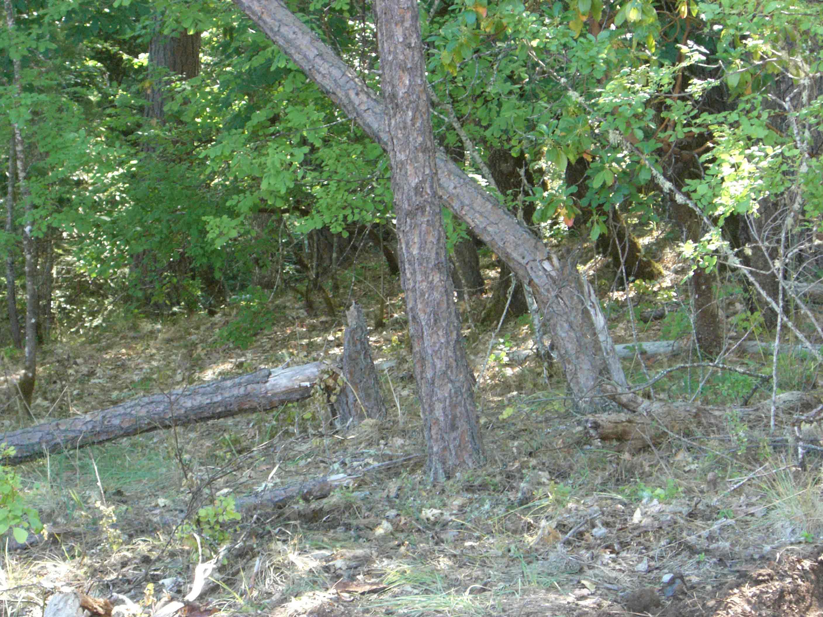

OK, the tree is down & in my "tree area" waiting to be sent to the burn pile. No chainsaws were used.
Everything went much easier than I had any right to expect. The only real problem I had was that one of the hydraulic quick connects on my grapple failed Friday, so I had to use the 4-n-1 bucket for all of the tree moving.
Not as convenient, but I could make it work.

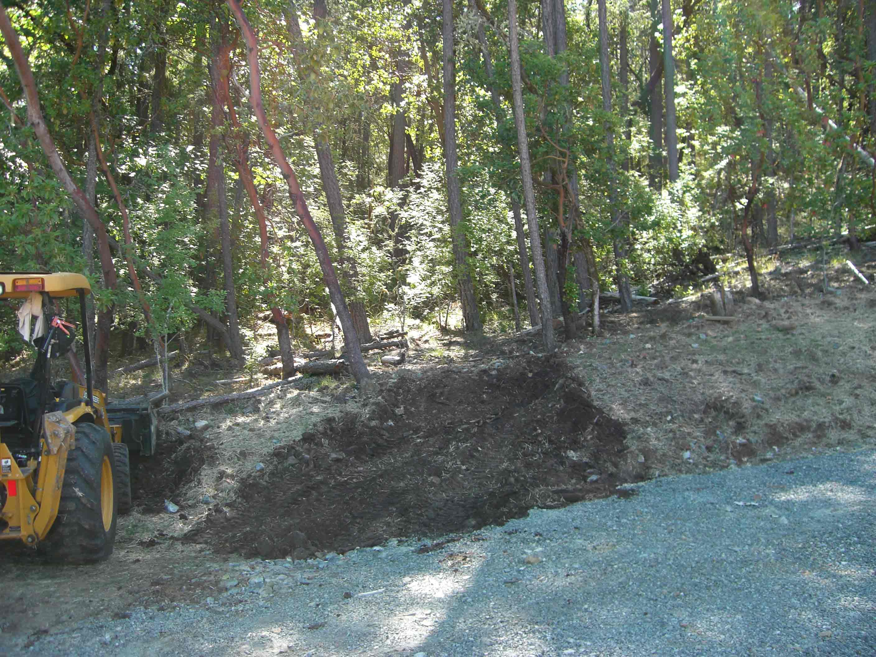

I started by making a path to get the tractor into the area. This was more to drag out the downed trees already there, and to drag out the trunk of the hung up tree.
The I dragged out all of the downed trees, and moved them to the tree pile for eventual transfer to the burn pile.

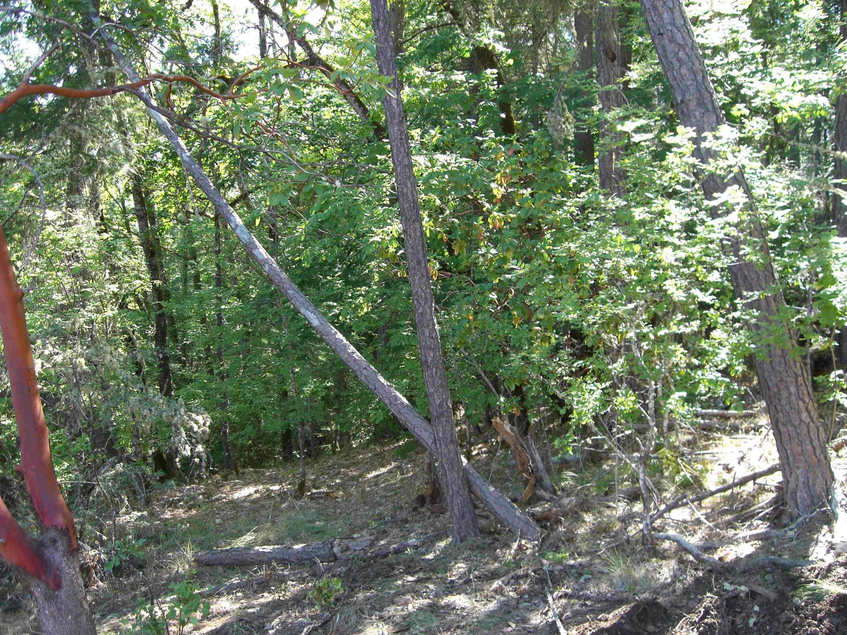

I noticed that there was a second tree which appeared to have fallen over at about the same time as the hung up tree, judging by the degree to which bark was falling off, and the color of the weathered wood exposed.

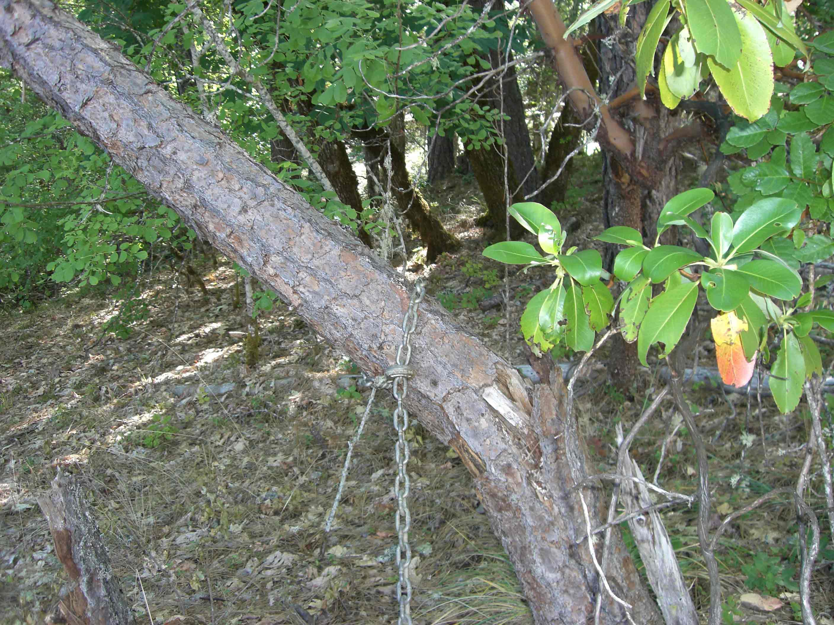

I decided to try to pull this one off its stump first to get a feel for what the hung up tree might be like. This went so nice & smooth & easy that I decided I could try to pull down the hung up tree without any other chains or cables.
So, I just chained it up with about 70 feet of chain (The tree was 50-60 feet as measured by my rangefinder) and pulled. The tree broke off the stump very easily. I dragged the trunk away from the stump until the hung up part fell clear of the oak tree holding it. The trunk was obviously old & weathered, since it broke into three pieces when it hit the ground.
Dragging it out was not too hard. It pivoted around the standing pine in the picture and came right out along the access path.
Dealing with the tree and the downed wood took about 2 hours, digging the drainage ditch I wanted in the first place was 3 more.
