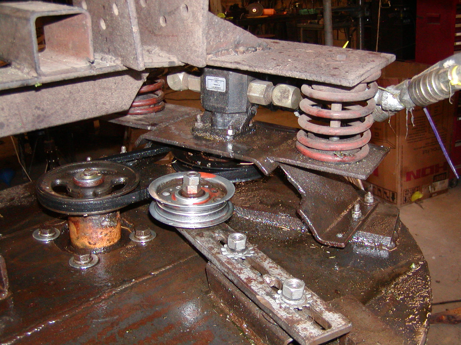

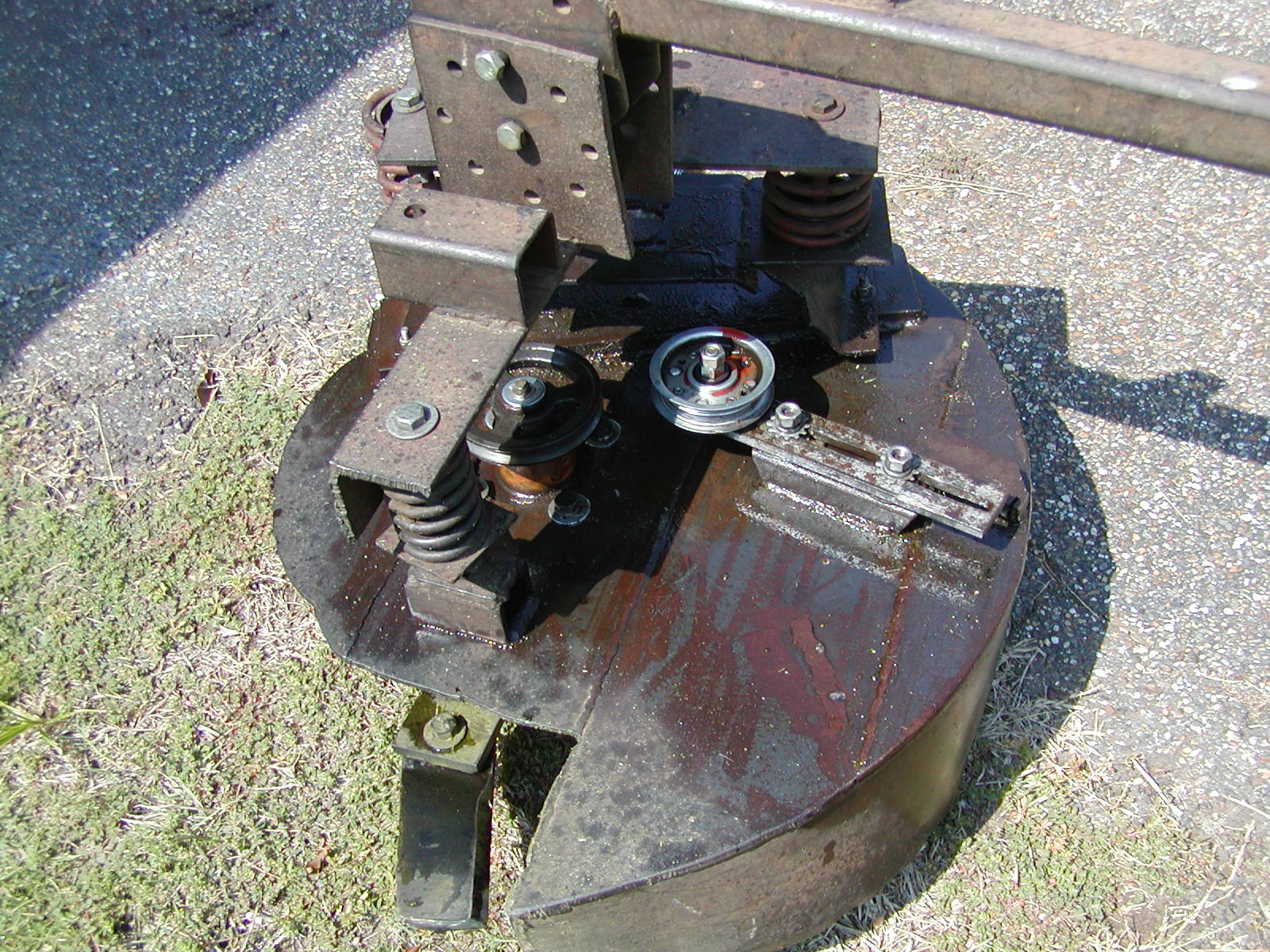

We built a 30" mower for our FEL so we could trim trees up high, ETC.
It is powered by a hydraulic motor. Belt drive. 6" v-belt pulley on motor & 5" v-belt pulley on mower.
We are running 5 to 6 GPM & tractor bypass is set at 2500 psi.
After blowing first seal, we put an adjustable bypass adjacent to the motor & set it at 1800 psi.
Next seal, we backed off on adjustable bypass a little more, but did not set with a gauge.
It does a great job, & may cut things we don't expect it to, for a good while, then it will blow the seal on something, we wouldn't expect it to.
Where am I going wrong. We really don't want to give the mower up.
Motor Specs:
Concentric/ Haldex Barnes 4F657A, Product# G2368956,
Hydraulic Gear Pump/Motor, Birotational.
Displacement: 0.517 Cu In.
Max contiuous PSI 2500
Max intermittent PSI 2750
Do you think we need to set adjustable bypass down more or do we need some kind of heavy duty motor?
Thanks in advance

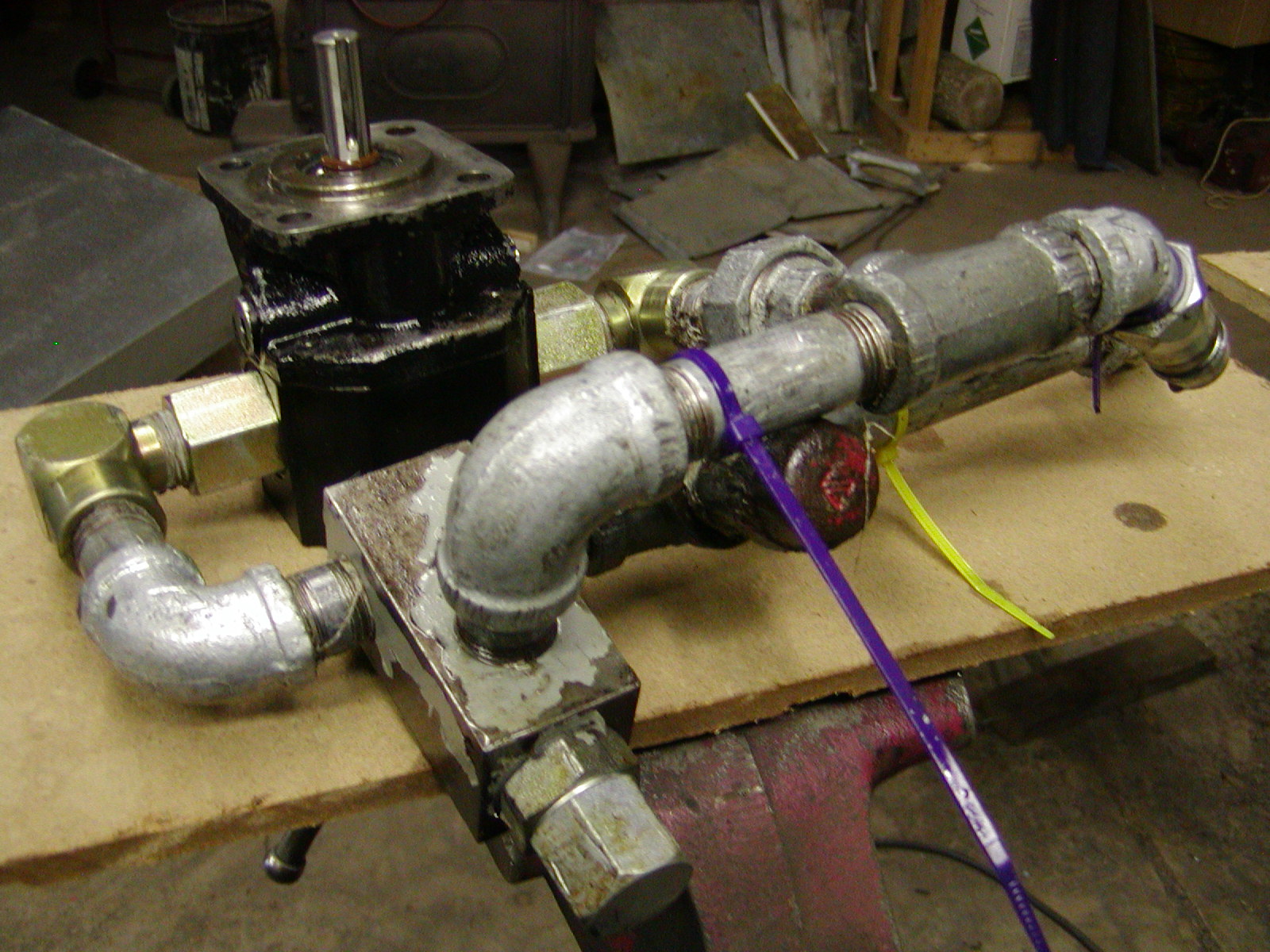

As JJ states: Get rid of the pipe fittings especially the galvanized ones. Oil flowing past the galvanizing will cause the galvanizing to flake off destroying everything in your system.

Picture attached with motor & shields removed.
/ How do I stop blowing oil seals?
We cut with blade rotating counter clockwise, viewing from top.
Deck skirt is also 1/4" steel.

Another picture with belt guards removed.
/ How do I stop blowing oil seals? #12
There is no case drain on that motor.
A hyd spike could be a great deal higher than the relief setting, and much faster than the relief can operate.

Again, I would replace the water pipe fittings.

Inlet pressure spikes will rarely blow shaft seals on gear motors. Inlet spikes will crack the gear housings or blow the seals between the gear housing and end plates.
Return line pressure WILL blow the low pressure shaft seal you have in that motor. I suspect it is rated for 10 - 20 PSI max running with possibly 40 -50 PSI momentary spikes in the tank line. Most of these small gear gear motors have bi-rotational checks built in which vents the shaft seal to the low pressure side. If the low pressure (tank or return) pressure gets to high for a given period of time the seal blows.
Excessive plumbing, quick disconnects, etc. all add to this pressure in the return line.
Does this motor have plain bearings with an outboard roller bearing for side load? If yes it was designed for side load use.
If it just has plain bearings or needle bearings it has limited side load capabilities.
Side loading could cause the seal to leak but unless the loading causes excessive internal leakage it should not cause the seal to blow out.

I think JJ and Oldnslow identified the problem: excess pressure in the return circuit. 6 gpm through 3/8" hose has a pressure loss of 2psi/ft; your hose seems to be at least 20 ft long, so that is 40 psi pressure at the motor exhaust. If your quick disconnects are 3/8" also, they are causing pressure drops of 15-20 psi each; three disconnects equals 45-60 psi. That's 85-100 psi pressure at the motor exhaust; then add the mitered elbows, remote valve, FEL valve if the remote is served by power beyond from it, and other fittings, each of which adds 1-2-3 or more psi of pressure. You did not say whether your hydraulic system has a return filter, but if it does that could easily add another 15-20 psi.
I suspect the exhaust pressure at the motor is very close to the manufacturer's limit if not over it.
The only thing that does not fit is your statement that he seals only blow out when the motor stalls. I understand that the momentum of the fluid in the inlet line will cause a pressure spike at the motor inlet, but I am not certain how that pressure spike also seems to appear in the motor case. With the reversing check valves the motor case is connected to the exhaust line through a check valve, so any sudden leakeage past the ends of the gears into the motor case should be handled through the exhaust check valve. Perhaps the motor case is normally at nor slightly over seal design pressure and even a sligght spurt of fluid past the gears into the motor case causes enough additional pressure to blow the seal.
I think your best solution, if you want to keep the 6 gpm rate of flow through the motor, will be a 1/2" return line as short as you can make it, with 1/2" or one size up quick disconnects (and perhaps fewer than 3 disconnects), and a minimum of elbows (which should also be sweep elbows rather than mitered ones).
