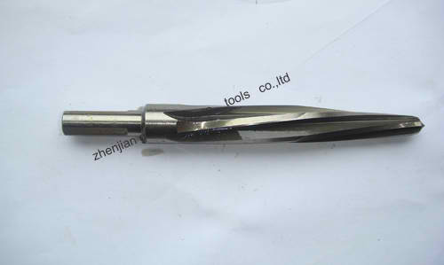

I would drill a hole through one side then slip it on the shaft using the shaft to center the second side by drilling through both. If you sincerely want to drill the hole in the shaft larger, I would use a bridge reamer. The long taper prevents binding and they will cut hard steel easily.
Good idea. The alignment issue is quite critical to assure both bolt crossings share load. Youre still left with 3/8 shear tho and OP thinks this is not enuf. Also, any shaft/collar play from wear will still be there. The overhang of the slip clutch serves to aggravate this.
That strikes me as applicable for short holes. A tapered continuous cut an inch and a half long in hard stuff would tend to twist it off.
larry
In heavy construction we use them for high tensile beams with flanges of over 1-1/2". To be on the safe side, you could approach from both sides.
