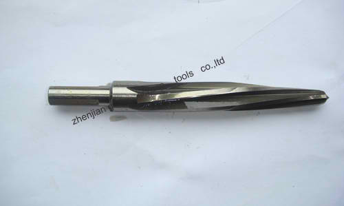

I would drill a hole through one side then slip it on the shaft using the shaft to center the second side by drilling through both. If you sincerely want to drill the hole in the shaft larger, I would use a bridge reamer. The long taper prevents binding and they will cut hard steel easily.
