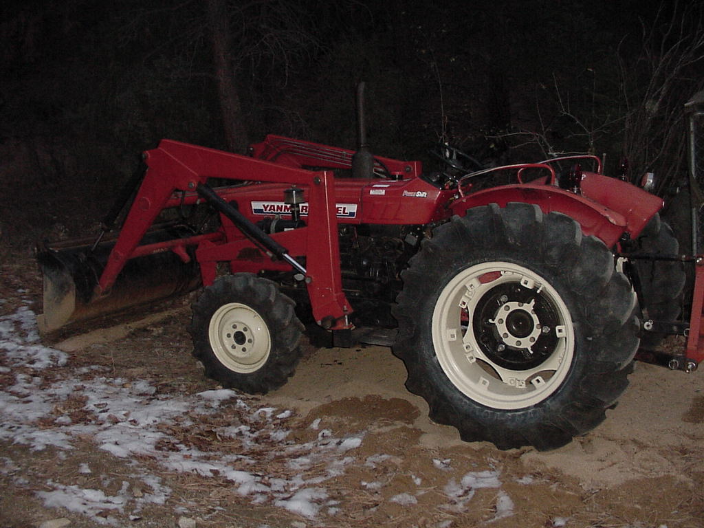

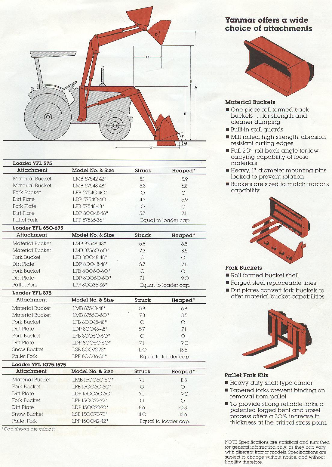

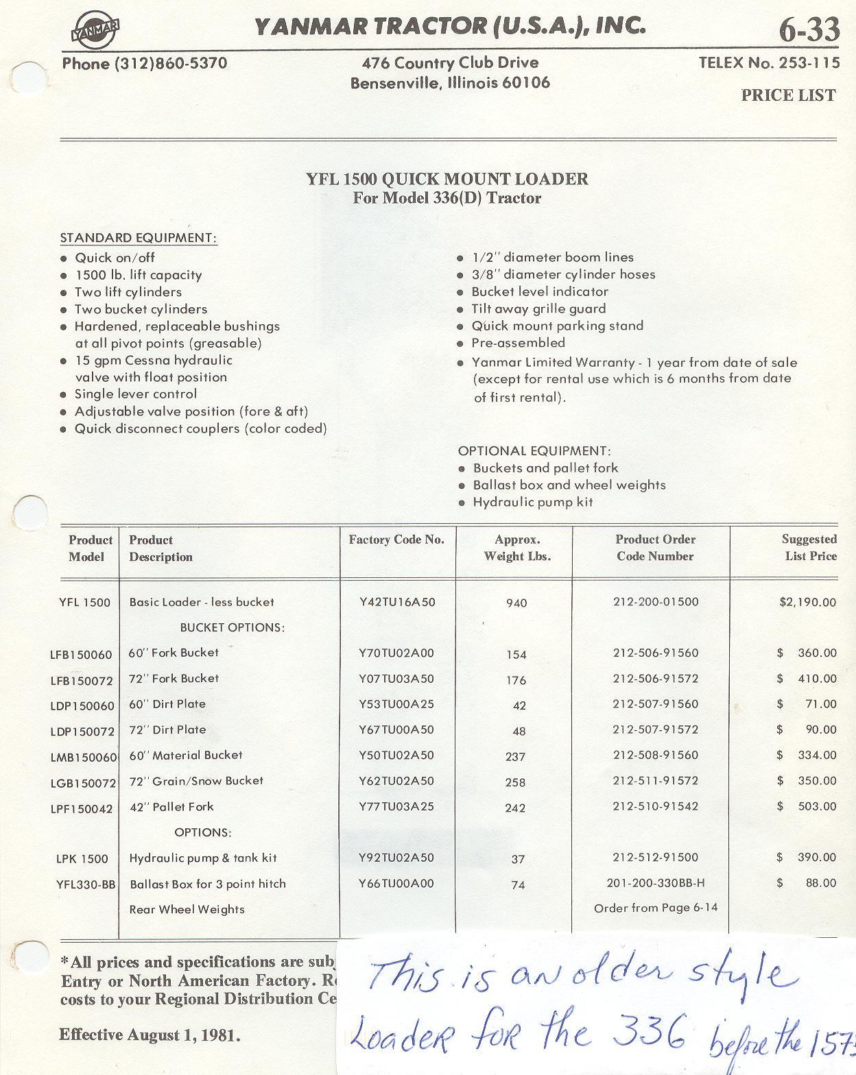

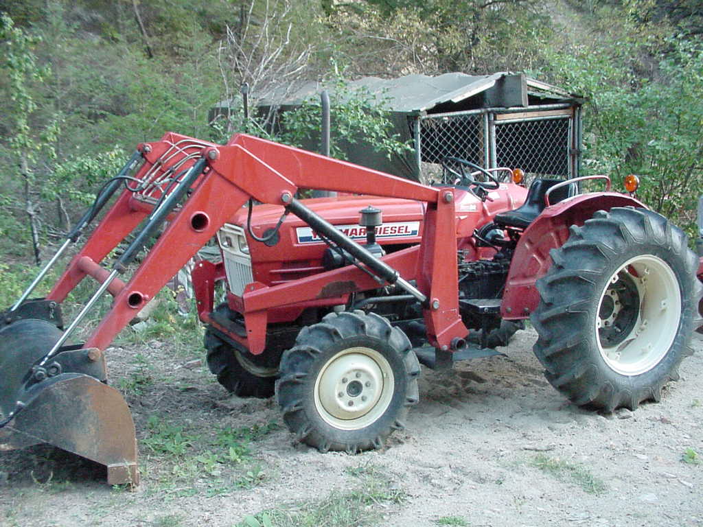

Here's are some picture of a completely stock YM336D showing the OEM loader.... and an old loader brochure from when the YM336D was new. Even some prices....
I'm not sure who made the loader for Yanmar, but don't believe it was Yanmar-made. One person who seemed familiar with loaders said that the Yanmar loaders were made by ALO in Canada. Someone here might have more into.
But it would be hard to beat these original loaders - they were top quality all the way through. Might be worth trying to track one down through used parts or maybe even in the area where they were manufactured.
I believe there were two loaders made for the YM336D - the YL1500 and the YL1575. Not sure of the differences .... if any.

Anyone with a 336, I'd sure be trying to grab that loader from Aaron. OEM is a real nice loader...
rScotty..Never knew that the loaders used a "kick stand" to hold the loaders up when you disconnect until I looked at those brochures. Never had mine off. Often wondered about that pipe that's welded in the middle with the hole in it.....I'm missing the stand.

The kickstand is stored in the tubular crossmember between the arms. Look there.
rScotty's brochure, page 1
, shows the kickstand's square foot secured to a pin on the side of the arm.
My first thought was " tell me that thing was there all along".
No such luck....have to make one some day....

Frankly I never took our loader off the tractor either. I had forgotten about that kick stand - had to go back and look at my own old photos to see if mine ever had one stored in the cross beam. Apparently not. Come to think of it, I don't think I've ever seen one of the OEM loaders that still had the kickstand.
Maybe there's a pile of them somewhere....
What do you keep stored in the crossbar? I kept a hoe and a shovel there.
