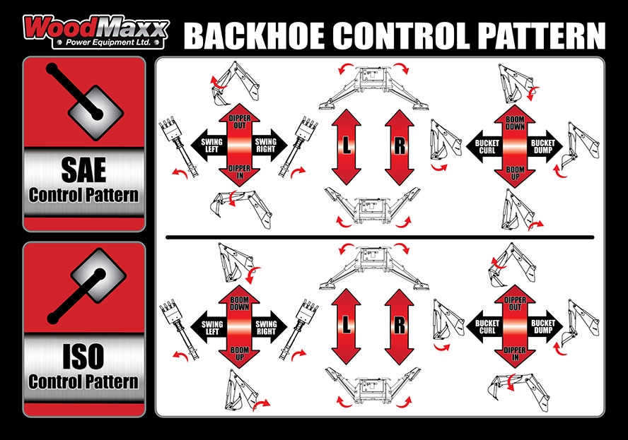

I'm pretty good on a backhoe. Lucky most of the mini excavators have switchable controls. I can't operate the trackhoe pattern worth a flip. My buddy is pretty good on a trackhoe, but can't operate a backhoe worth a flip.
Stupid question perhaps, but what's the difference?

The patterns have several names, but this may be the "official" version.

And every experienced operator has a preference. I prefer ISO.
This isn't a big deal for most here in this discussion. It's a huge deal if you are a large Construction Contractor with many machines and many operators. That's what created the need for modern machines to easily swap between the two types by the flip of a switch.

Often wondered what the difference was. My NH575E is ISO and so was the mini ex I rented a couple of years ago. The mini ex had a switch you could change it with and also had joysticks instead of the two levers I have in the backhoe. I wish the backhoe had those joysticks.

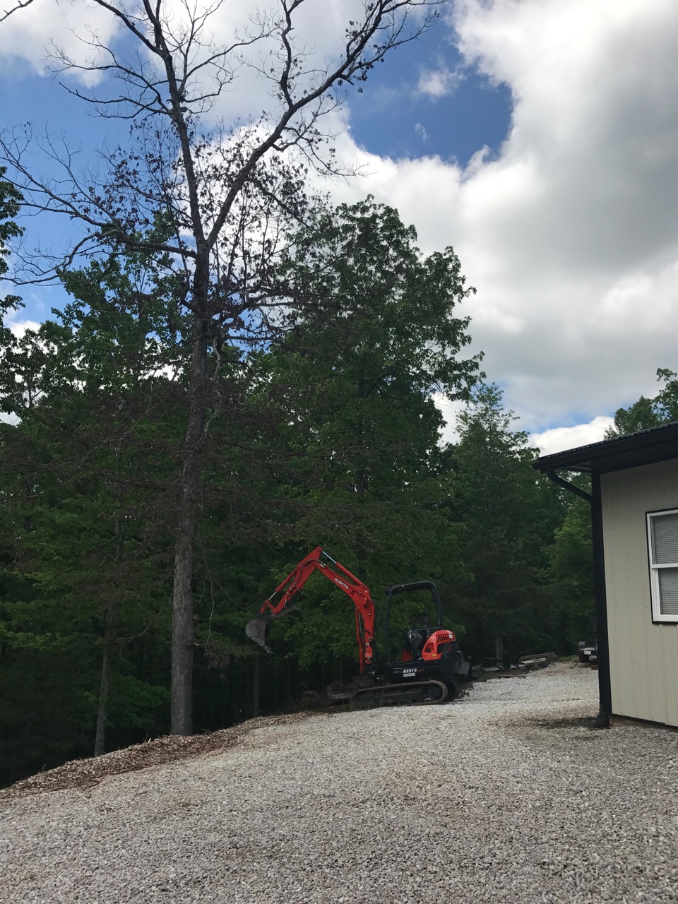

This is an example of trees I commonly clear with a mini. The tree right in front of the bucket is down over the hill about 8-10' and was within maybe 30' of my shop. Spent a little time digging the roots so I could easily control the fall and get the stump out. Done a lot of trees, often a bigger with my mini but thought this would give an example of what they can do.

if you do go this route typically you dig out the roots on the left side, right side and then in front of you. Always leave the roots on the other side of you so the tree doesn't topple back onto you. In some case you can use the corner bucket and pull tree towards you and then swing away falling tree right beside you but this should only be done by very experienced operators. Ive cleared acres and acres of trees and an excavator is the way to go. Becarefull with dead trees as the tops can snap off and land onto of unit. Make sure if you rent one you get it with a thumb attachment otherwise you will hate life.
Also consider cutting stumps off and limbs. Then cutting into 10 foot sections to make them easier to move. Im assuming your going to burn them. I would cut them up a little bit, dig a nice hole, through the limbs in the hole, use the bucket and fill with desiel, start a small fire in the pit and then throw fuel onto fire. That will get her going good. Once you get the fire burning hot it should eat up the stumps.
