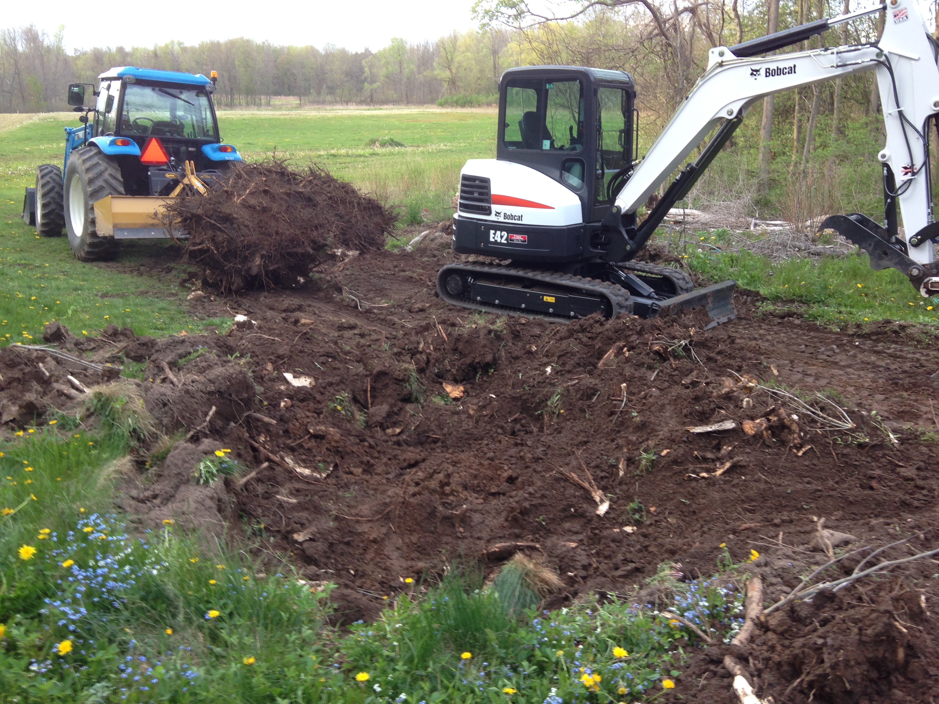

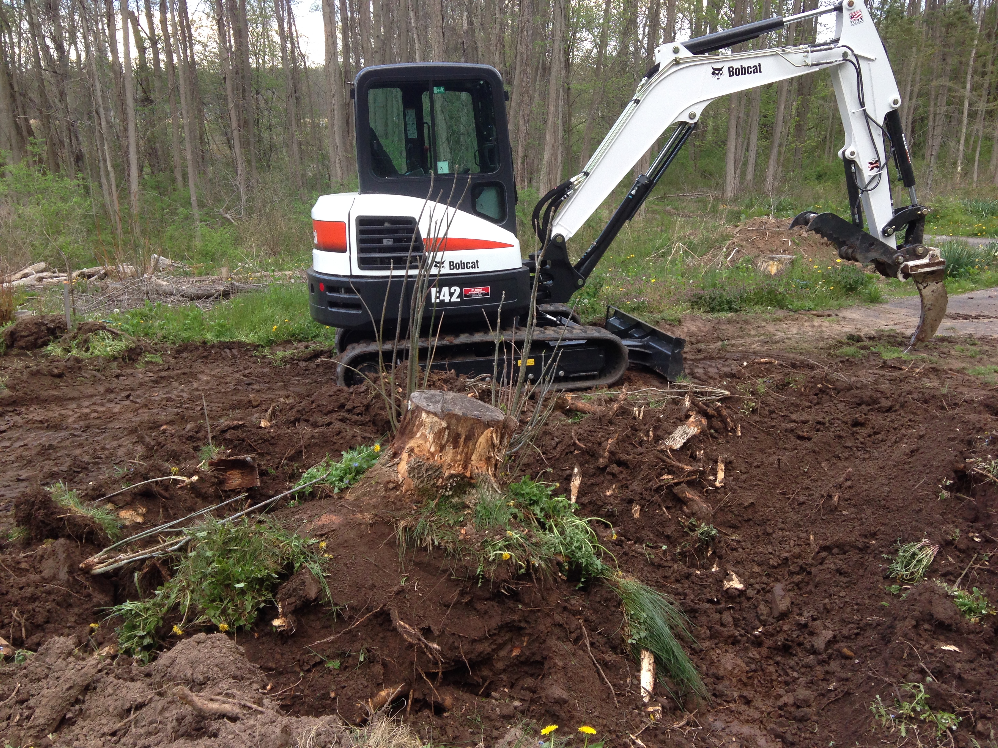

I have easily dug 100+ stumps this year with a ripper on my Bobcat E42 and it痴 at least twice as fast as using a bucket, plus it disturbs a lot less soil. It doesn稚 twist components like lifting on the edge of a bucket, all the pressure is centered on the shank and you can easily snap roots with the tip.
So do those of you who are saying you prefer a bucket over a ripper for stump removal actually OWN a ripper?

After using one felt I didn't need to spend the money on one for our trees and soil types. I have dug down 5' before to get to the bottom roots of trees so a ripper would be tough. Now some of our shallowed rooted trees it would be very handy!
