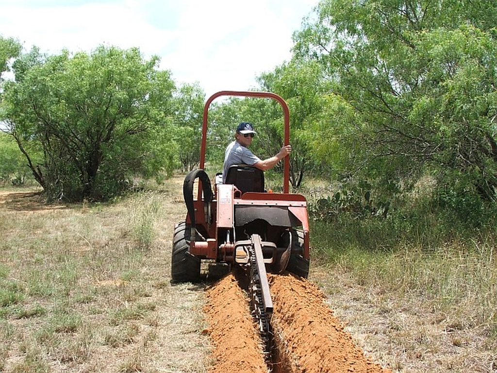

Yeah, hard to beat a trencher. I dug about 1300+ feet of trench for my water line in one day. The unit I rented had a dozer blade on the front but didn't use it--I was too tired to lay the pipe the same day. I even rented the trailer for it. I didn't have to go as deep as you but still went down about 2.5 feet and used 2" PVC to keep the gophers from eating through it.
I rented a walk-behind trencher when I did my electric to the house and barn. I paid the extra for the ride-on trencher for the water line. ;)
