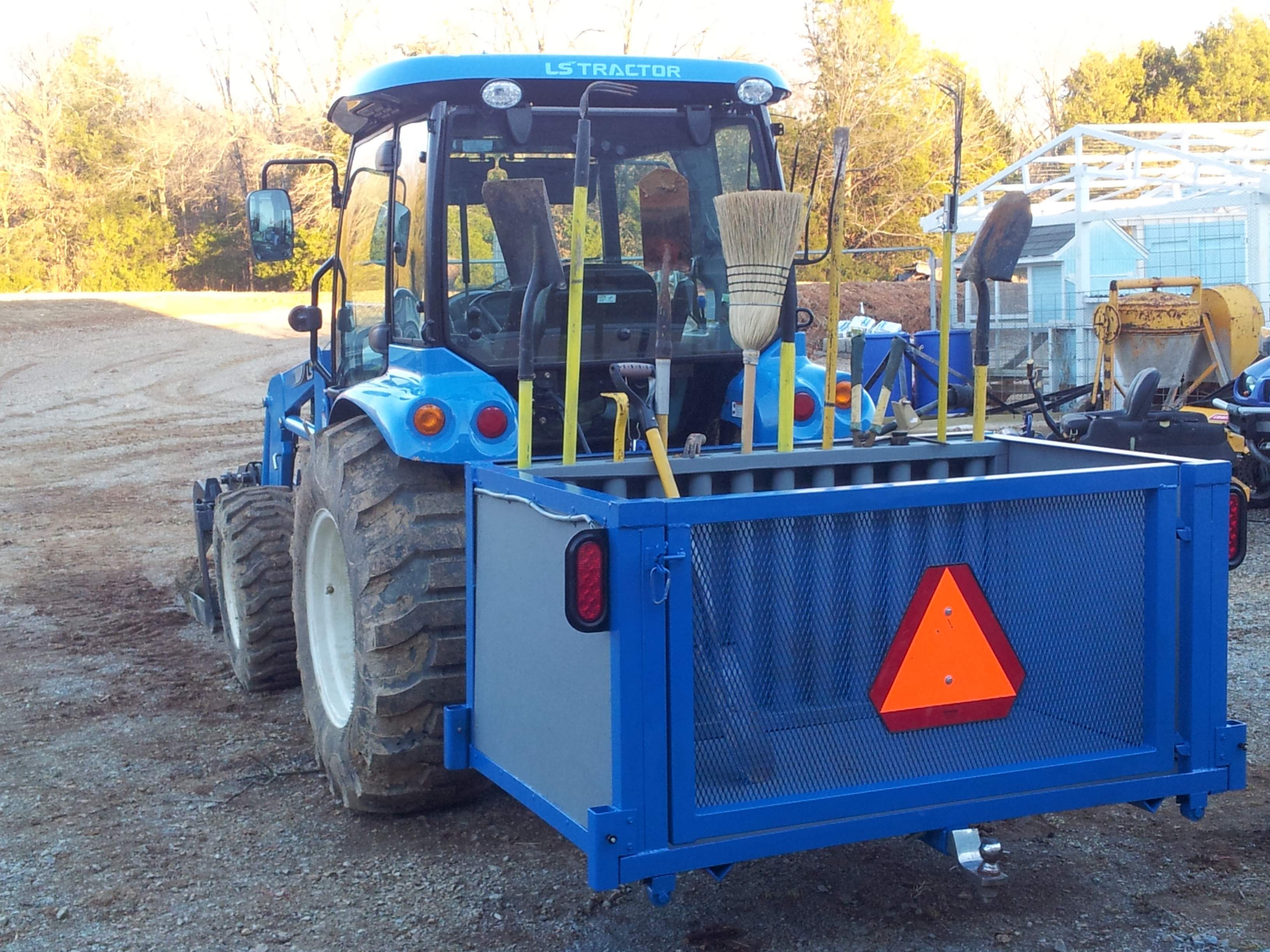

My LS xr4046hc has brake lights and a 7 pin plug, I set mine up on my carry-all and the tail lights and turn signals work but not the brake lights. I haven't figured it out yet but I think it is the right thing to do. I live on a gravel road and go from one gate to another on the road and would rather be well seen. 20140113_164125.jpg
