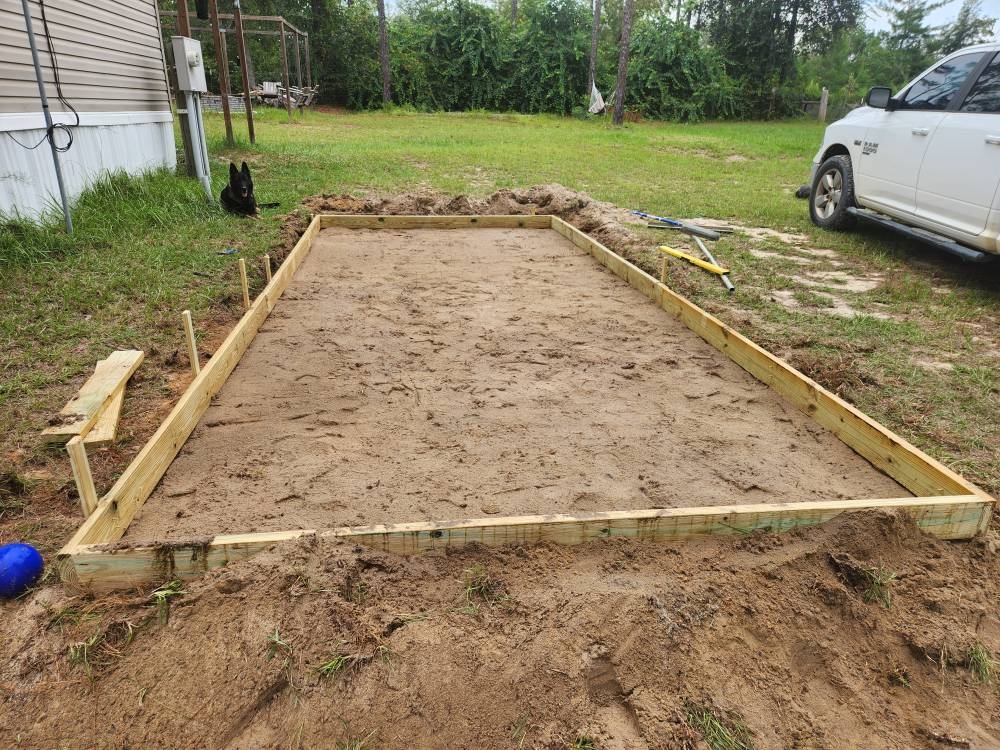

My the first 9x20x5.5" formed up. Kinda had a random day off, for no reason other than to burn some PTO, and figured I'd do something productive. It's easy to forget how much work even fine grading is.
I might regret it later, but I set it for dead flat. I knew I didn't want to follow the "lay of the land"; but maybe I should have put 2% slope? Nothing shows your faults more than a "flat" slab.
Got work, and rain chances all this week; might be a couple weeks before I pour it.

Once the 3 slabs are poured, I am considering pouring a D-curb at the front, and regrading the "lawn" up hill of it.
