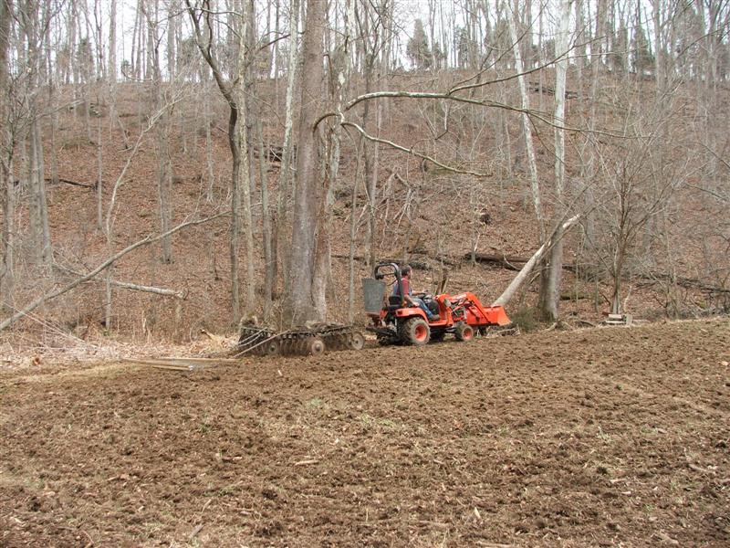

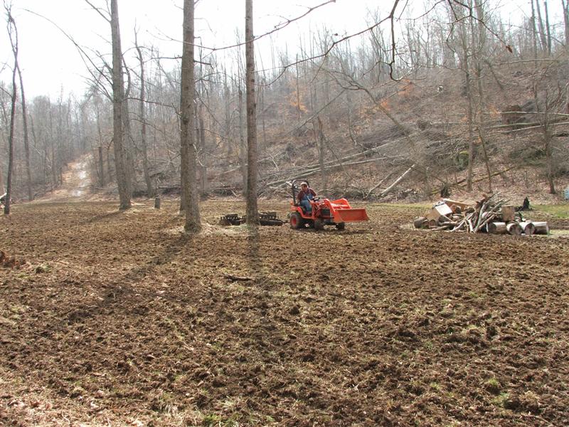

I guess tillers are in favor these days, especially with the smaller tractors, but there are people that use discs with good results. Do a search on posts by Milkman, and you may find something. I would think that the 4', and 5' discs would work fine. Landpride has a video showing their 05 series being used on a BX. Hmm, maybe I can find a picture of Milkman's setup.... Yes, I found a couple. Sure looks bigger than 4' to me! :D

   / How big of a disk setup for a BX24? #10
The soil is the biggest key. In Chucks pictures I only see the disk going in the ground a few inches deep. The soil doesn't look that sandy. I just ran the disk over my garden which is a true sandy loam(locals call it sugar sand). No rocks. With my lightweight L and a light duty 5' disk, after a couple passes the ground is very soft and the disk will sink to their axles...thus burying my tractor. 4wd won't do much either. This same garden would bury a 10' disk on a 55hp tractor. Not sure how the rocks would react to all this.
Now I have used my 5' disk on some harder clay type soil, in that stuff I could only get down 2-4 inches(with a weight on the back). No problem pulling it in that stuff.
First pick is the sand, second is the clay. Good Luck, Rob
