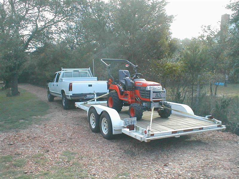

I can't imagine hauling on a single axle. Attached photo shows my trailer. Tandem axles with electric brakes on both. Deck is 18' x 7' and it will hardly fit my BX with implements, although I have carried Suburbans and pickups on it with no problems. Truck tow rating is 8000# with frame hitch.
