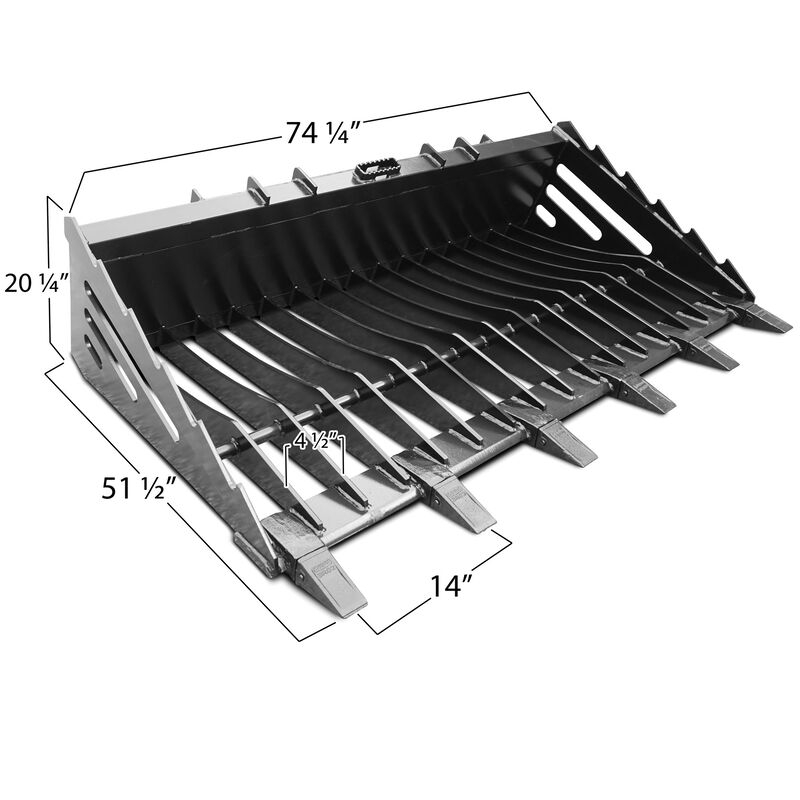

I ended up fixing my Kubota bucket and also getting a Titan 72" skeleton bucket -- it's 51" deep and 20" high - and somehow 700lb:) awesome for picking up and moving firewood. Interestingly, the skeleton feature (i.e. ribbed bottom with space between the ribs ) is not that efficient at separating out materials; seems well built but time will tell; thanks tp all for all the replies -- really appreciated... Josh
