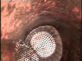

My grandson had the drain in his shower run slow. He tried rooting it several times withou luck. He hired a rooter service and they could not get past a couple of feet before rejection. He then had them camera it to see what the issue was.
View attachment 782852Here is what they saw.
They quoted him $3800 to jack hammer out the floor and then replace the tile.

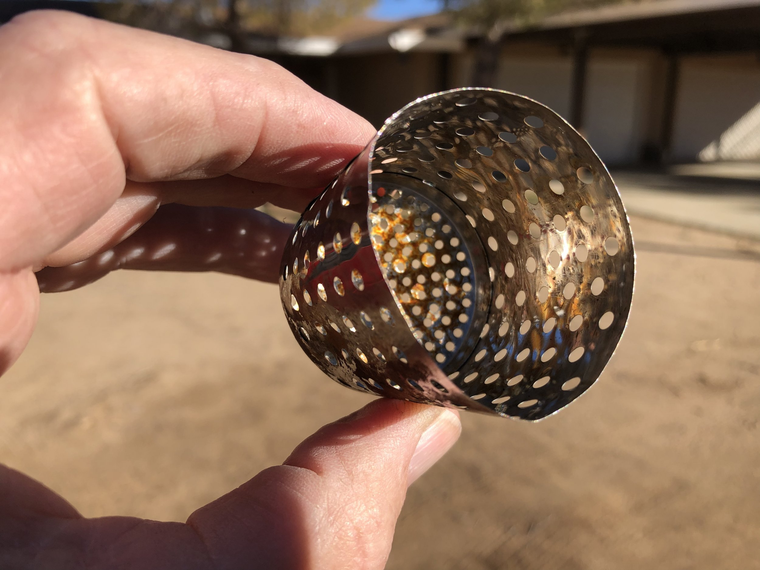

I said that’s crazy and let me see what I can do. I thought about it for a while and said, I wonder if I can pull it out with my shop vac. Stuck it on the drain and in 2 seconds…
Here’s the result.
how the heck that got down in there or where it came from?
   / How are we gonna fix this #23
Isn't it just the screen out of a drain screen? I assumed it got "plungered" down the drain as someone was trying to loosen the clog...

It looks to me like some sort of strainer cup that fits down into the drain, beneath the flush mounted cover on the shower floor. Correct OP?

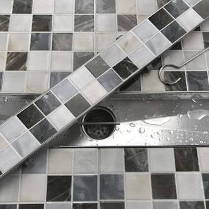

The shower had a “slot drain” similar to this. Apparently the pin that holds the hair screen came off.
   / How are we gonna fix this #30
Ahh. I've seem the finished product before and always wondered how they dealt with hair. S the tiled cover just lifts out?
