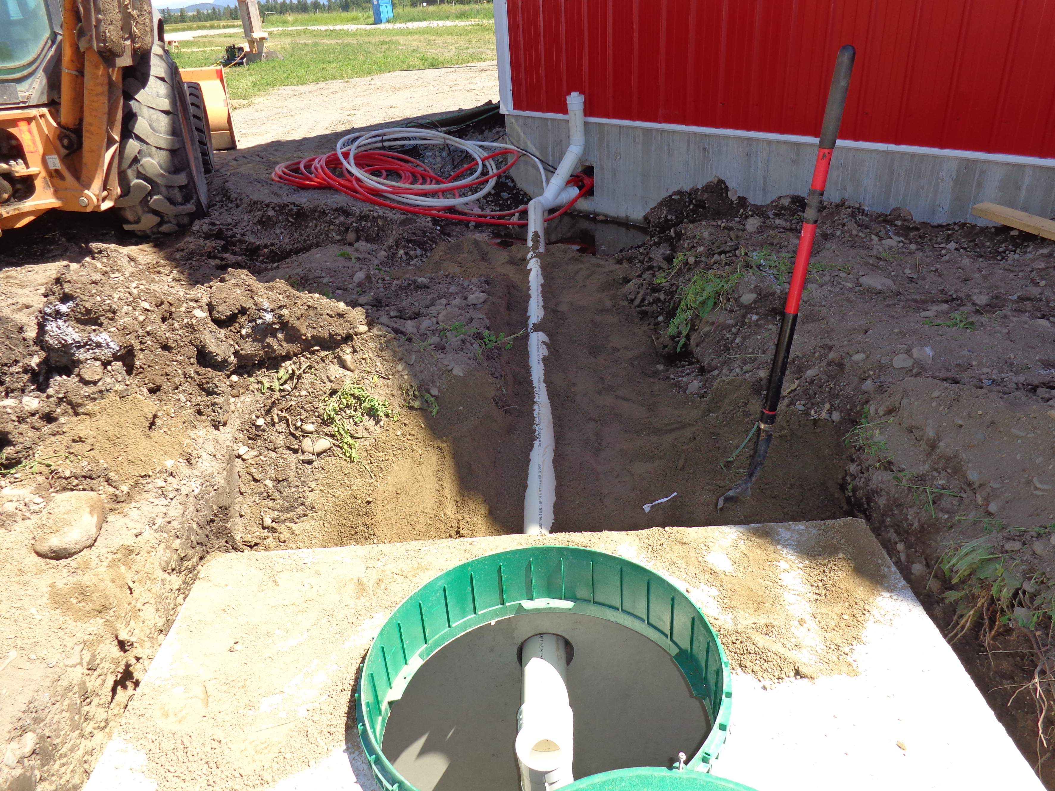

I'm not sure how others do it but I not only do detailed drawings but I also take pics. every step of the way and give the owners a DVD or CD with the pics. on them. Here's one example a a pic.
With the clean out side the building it is always excess able.

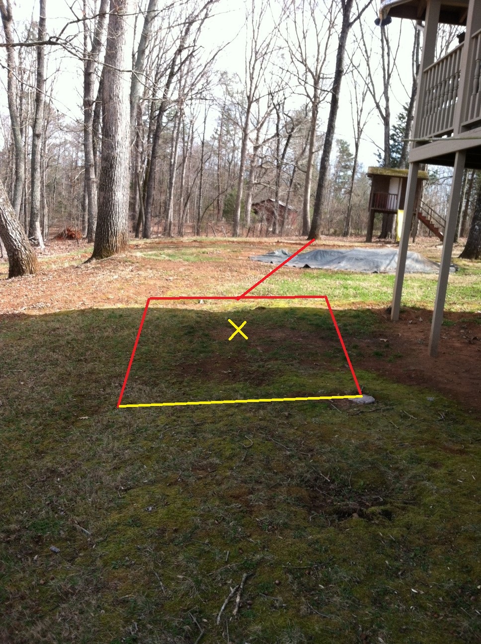

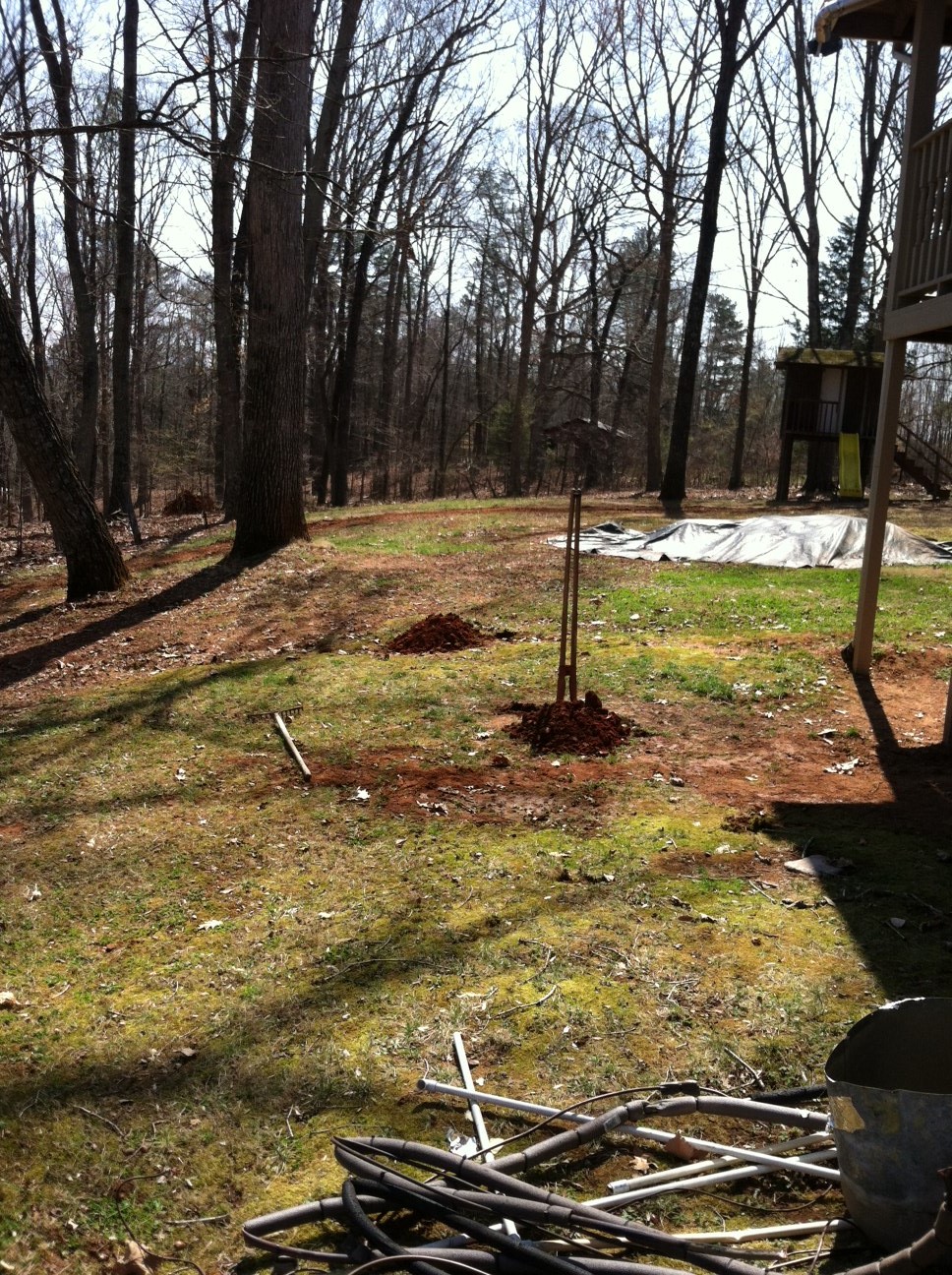

OP here. Two photos of my suspected tank location. In photo1 you can see the basement wall and heat pump. Coming directly perpendicular from that wall and about 4 feet from the corner of the house you see a flat rock in the lawn. That flat rock marks 15 feet which is what the health department sketch says the tank is from the house.
In photo2 you will see the flat rock still, in the right. Now looking parallel to the house you will be looking across the tank and into the drain field. The flat rock marks the right side of the tank so it will be extending into the lawn however wide it is from that rock. The drain field extends straight back in the photo to the tree that appears to be above the tarp on the ground. It's all very flat and probably not more than six inches difference from the rock to the end of the field. Honestly, I can't see much of any kind of witness marks. At the flat rock I poked a probe 18" deep every 12 inches in a 10' square there. The ground is hard clay and I gave up after my arms turned to rubber.
View attachment 417526View attachment 417527
From your description, it would make sense if the tank is here.
Get a probe or post hole digger and dig down at the yellow X at least 4' to be sure.
Good eyes Moss. That looks to be a likely spot. Also, toward the forground, from the yellow x, in the bare spot, could be another lid.

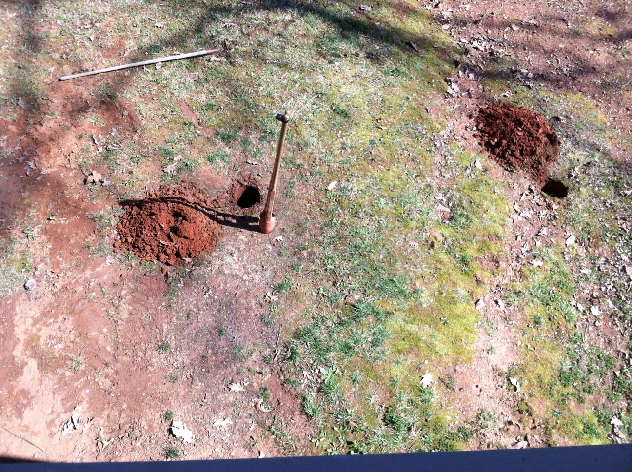

I didn't get to 48" but at 42" in each of these two holes there is just dirt. Not even a hint of a tank or leach field in either hole. :-( The second hole went in the wrong direction. Will dig in the "other" foreground this afternoon. The new junk in the picture is my other priority for three days while the HVAC contractors are here.

Poured concrete foundation, the access has to be 3 times the diameter of the pipe (4" pvc =12" hole) nothing else can run through that access. Cleanout goes to finished grade, 3 feet out from residence. pea gravel is the only acceptable fill for tank (sides and bottom) and piping (cover 1 foot). If I set a two tank pump up/out system, I can lay the electric and alarm cables in the same trench.
