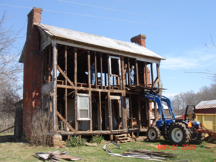

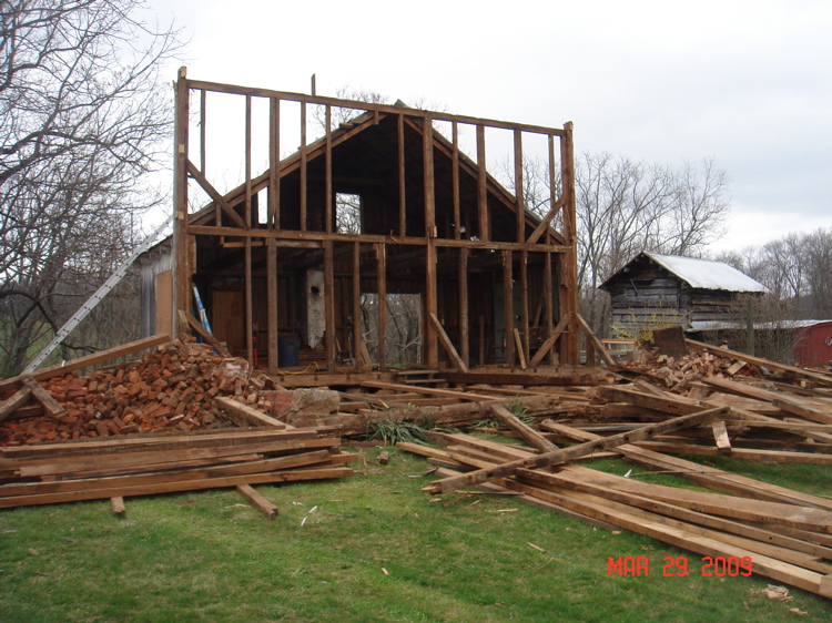

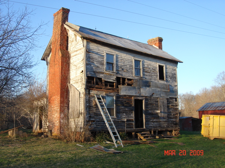

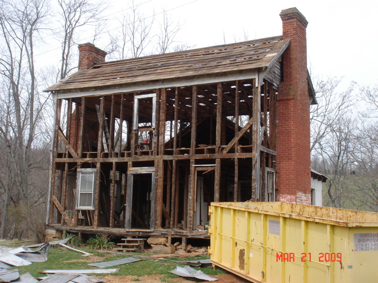

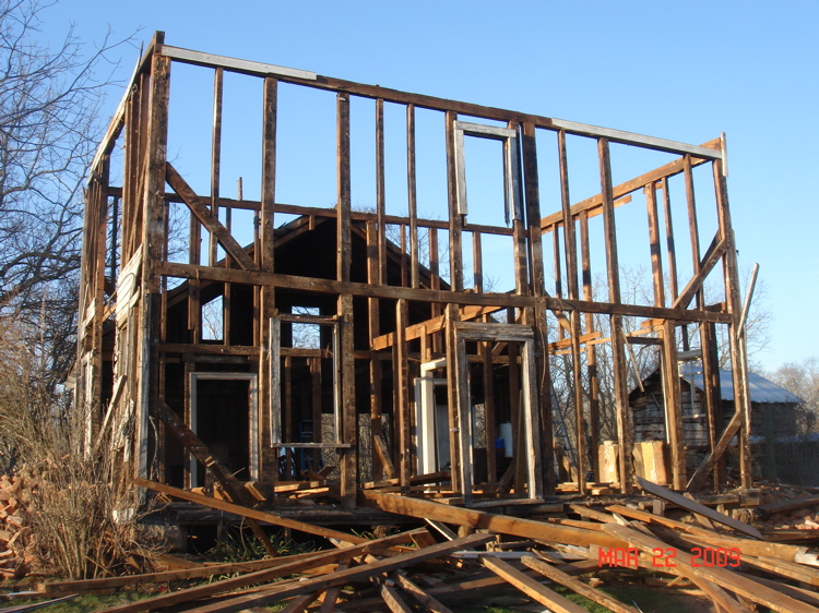

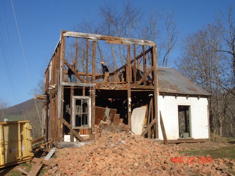

Here are some photos taken over the last few weeks of an old house on the farm I am dismantling to improve my view and salvage some good oak and heart pine. It has been fun, but a lot of work.

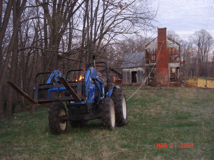

I did see the New Holland with pallet forks in the pics. How did that work for you? Would a grapple have worked better?

That was quite a project. Any idea how old the house was? I looks like it may have been a post and beam building. Do you have any plans for reusing the wood or other materials? Rick

- The demo started by removing all the interior wall coverings which were dry wall, bead board, plaster and lathe(a real pain) or t&g paneling. In my case I left the roof and exterior coverings in place to keep the heart pine flooring dry
- Once I had a dry looking weekend I knocked off the exterior wood siding from the inside out
- Next, I started on the roof removing the tin and purlins and pushed over the rafters
- Then I pulled down the chimneys a long rope and the tractor which was actually much easier than expected.
- This left me with the timber frame and floors. I pulled up the floor on the second floor one board a time on the bottom floor I cut the joists at each end and used a sledge to pound down on the joist which pulled them away from the flooring so I didn't have to pull the first floor up one board at a time. I could do this because these floors were through nailed using locally produced iron cut nails that slid out of the wood rather easily.
- Finally I cut some of the tenons on the timber frames and pulled them down in sections with a rope
- All this work was done by hand with a hammer, sledge, 48" Gorilla Bar and sawzall. The pallet forks were awsome because I could stack directly on them, drop my load on a hay wagon, haul it to my storage building and unload with the pallet forks again. I also used them to lift and move the heavy beams. Don't think the grapple would have worked as well for moving the stuff around as the forks
- I hope to sell most of the heart pine and use the oak and tin on other buildings on the farm. I traded the "wavy glass" windows to my neighbor for deer corn. I saved the doors, fireplace mantles and interior trim to either sell or reuse. Burned the rotten and unuseable wood

- House was estimated to be around 100 years old, all the wood except for the sills was sawn so probably not too old. Supposedly was a trading post at some point for the Iron Furnace next door that was built in 1863 to supply the Confederate Army with iron when their other sources of iron were cut off. I have attached a picture of the stump that the house was built over, I assume they cut down the tree and just built the house over it.

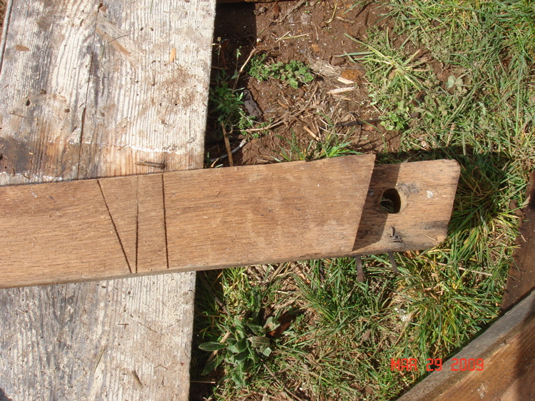

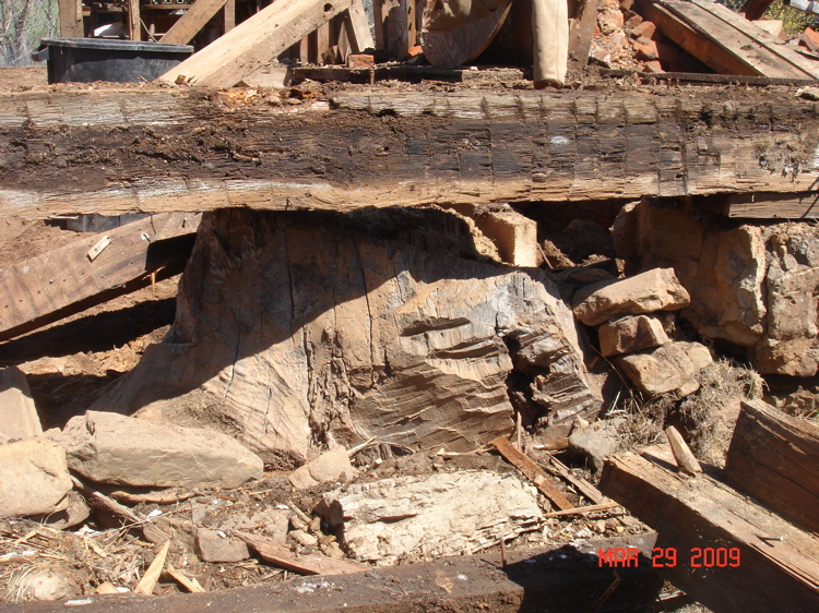

We found some interesting stuff, some Progressive Farmer and Farm Mechanics magazines from the 20's and 30's, a cast iron "pig" from the furnace, some old wrought iron hinges and railroad spikes and a penny from 1945 under the floor. On the bottom of some of the floor boards written in grease pencil was " E H Robinson - Eagles Siding". The Robinsons were historical owners and the RR spur to Eagle furnace next door was called Eagles Siding so I assume the floor boards were shipped in on the RR. The timber frame construction is very unusual for the surrounding area according to my neighbors and I assume whoever built it came in on the RR.

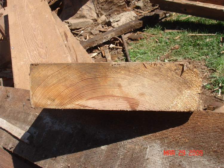

We plan to have the metal detectors in to look here and at the old house site across the creek. I also will dig in the area under the house since the area is very rich in Indian artifacts based on its location on a big loop of Cripple Creek. The wood was very tight grained as evidenced by the attached picture. I have also included a picture of the top of the rafters that were pegged together and as most of the joints were, marked with Roman Numerals. It was a lot of work to tear down, I can't imagine the amount of work to build since they had to make all of those joints. I gave my neighbor took the stair material so he could build a small cabinet for the former owners in his wood shop, the stuff he has planed down so far looks really nice.

Looks like a "Sweat equity" project. Very cool stuff there. That stump looks practically petrified under the flooring there.

... The wood was very tight grained as evidenced by the attached picture...
Man, wood just doesn't grow like that anymore. The stuff we get today is superfast growth from seed to product.

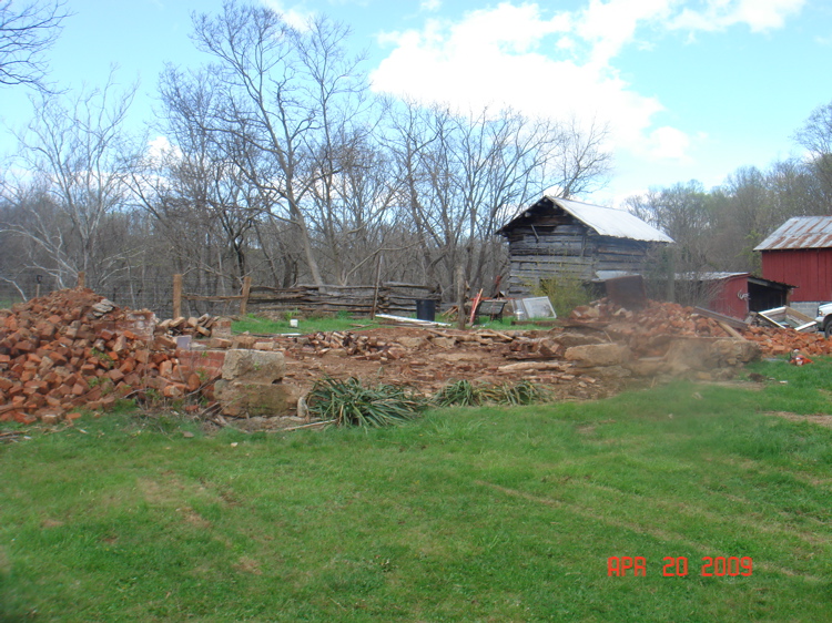

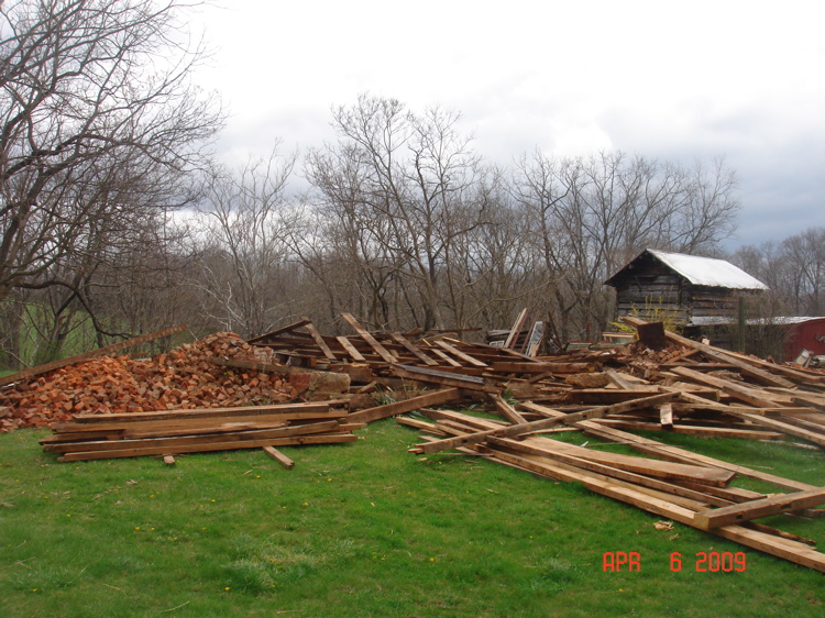

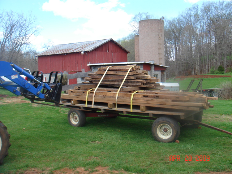

Thanks for all the comments. I have the site pretty well cleaned up except for the brick. Based on the comments I have received I have started to stack the good bricks on pallets to see if I can sell them. Attached are the photos of the site currently and the last load of wood on its way to dry storage.

Few nice timbers there, not much under that house though?
Would like to see a close up of some of those bricks.
See if they can be split length wise. Good quality clay brick can be cut with a hammer like pcs of a pie. poorer quality brick will just break in half when struck with a hammer.
From your description sounds like they were hand made, might not be the hardest brick but could still be worth good money for their unique character. Could be worth much more than even high quality recycled factory made brick.
JB.
