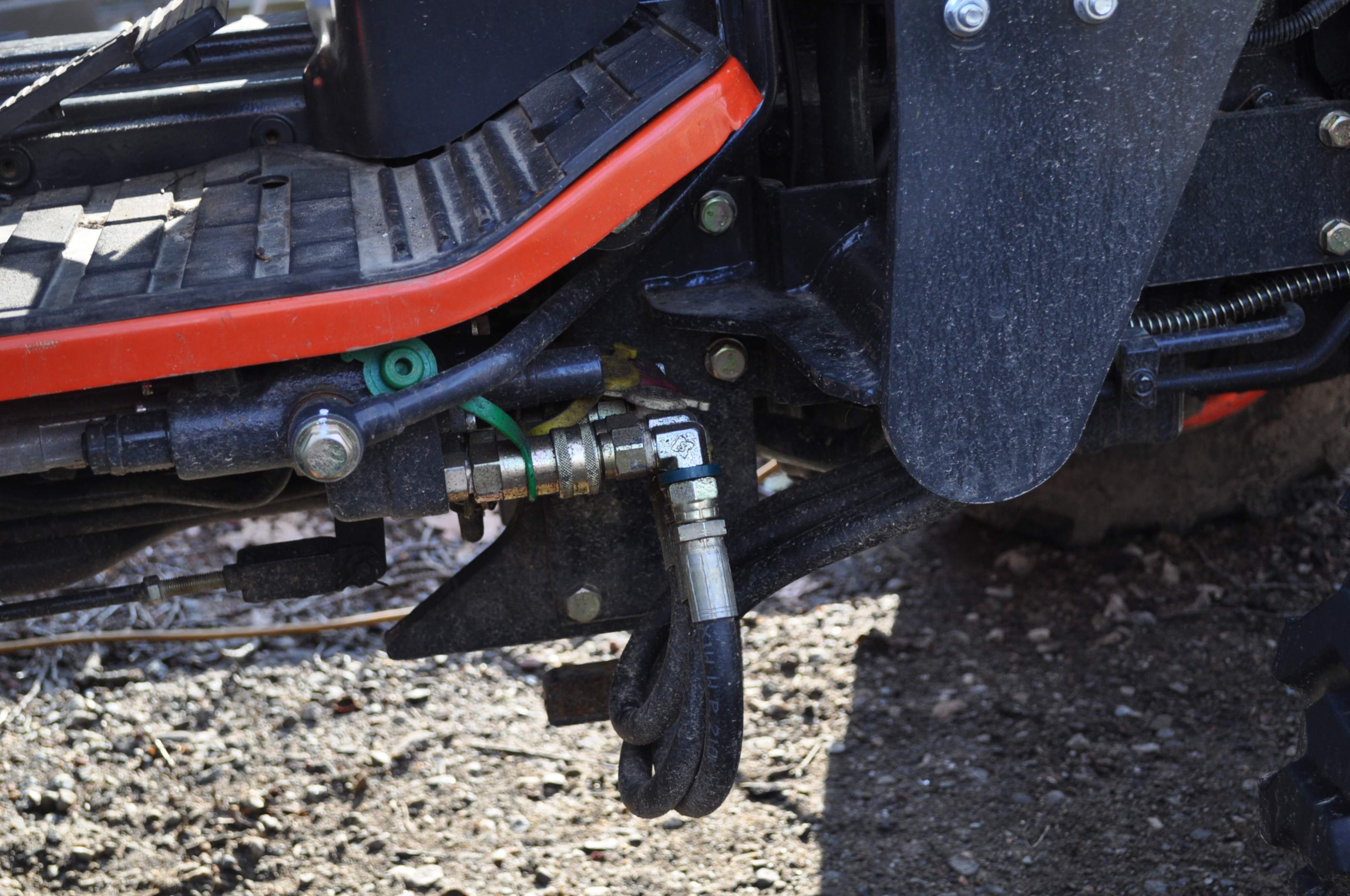

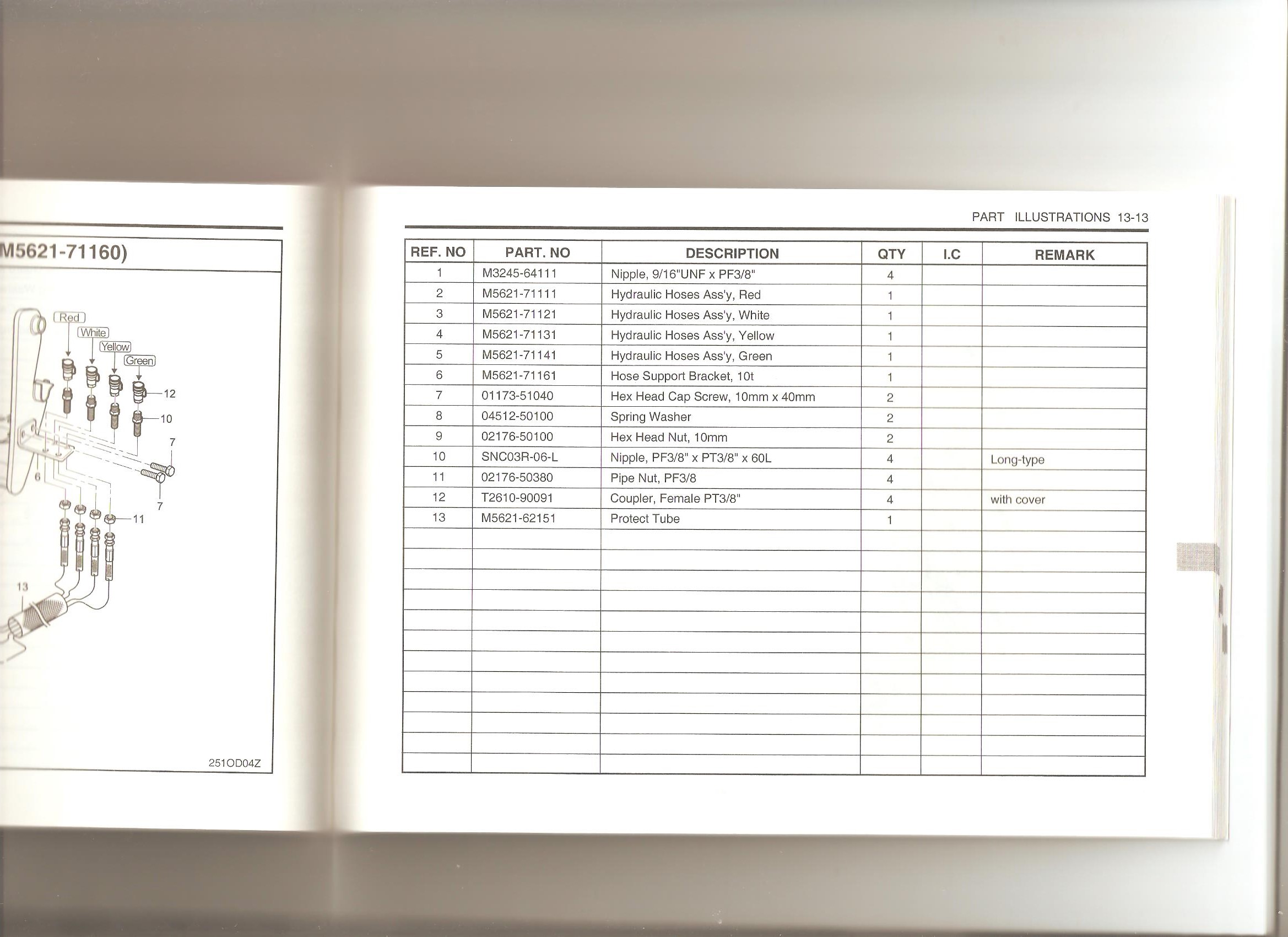

The one thing I didn't like about my Kioti CK2510H was the hoses down below the quick connects they could be damaged.Check out this Video at 1.47min.Maybe this dealer changed the hoses.I am going to look in to this! https://www.youtube.com/watch?v=5dChnR__DT4.Avyone know what size fittings are used on a Kioti tractor? I will add a pic of my current setup soon. 100_9794.jpg

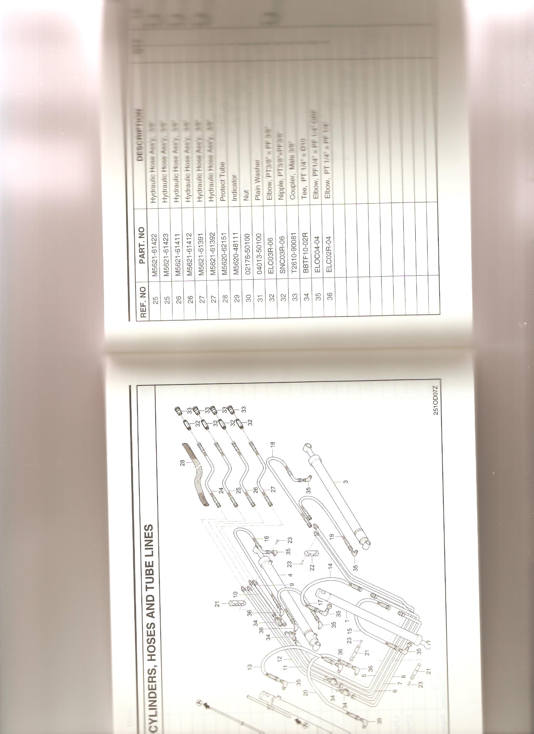

I found in my loader manual the size of the fittings, but not sure what pf stands for.Will female coupler 12 fit on part 1? I will need 4, 45 degree elbows to go between hose & male coupler.What size & type.fittings 2 001.jpgfittings 3 001.jpghydraulic fittings 001.jpg

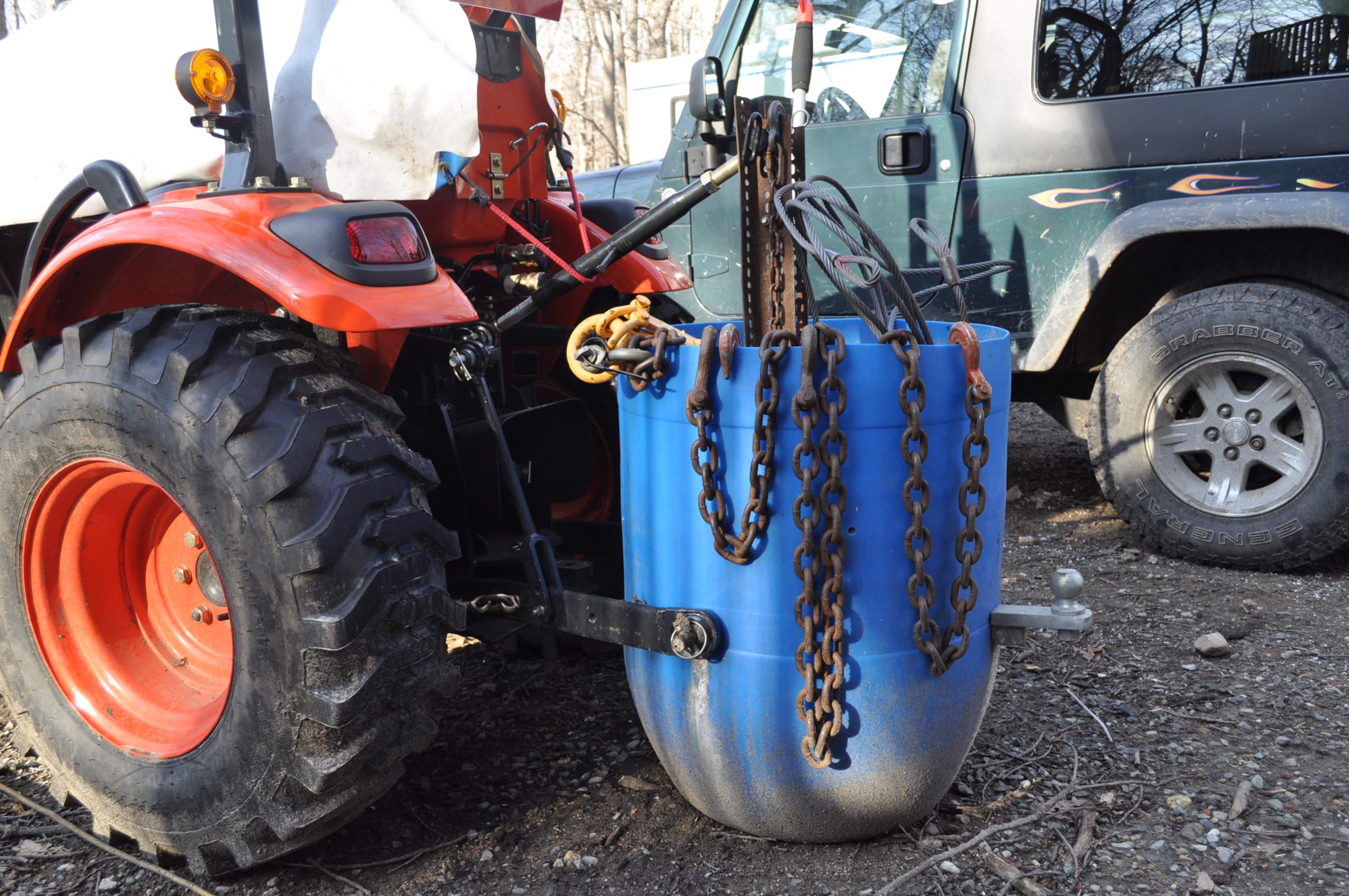

I like the way the hoses are on that tractor. I think I'm gonna change mine to be like that.DSC_4182.jpg Before

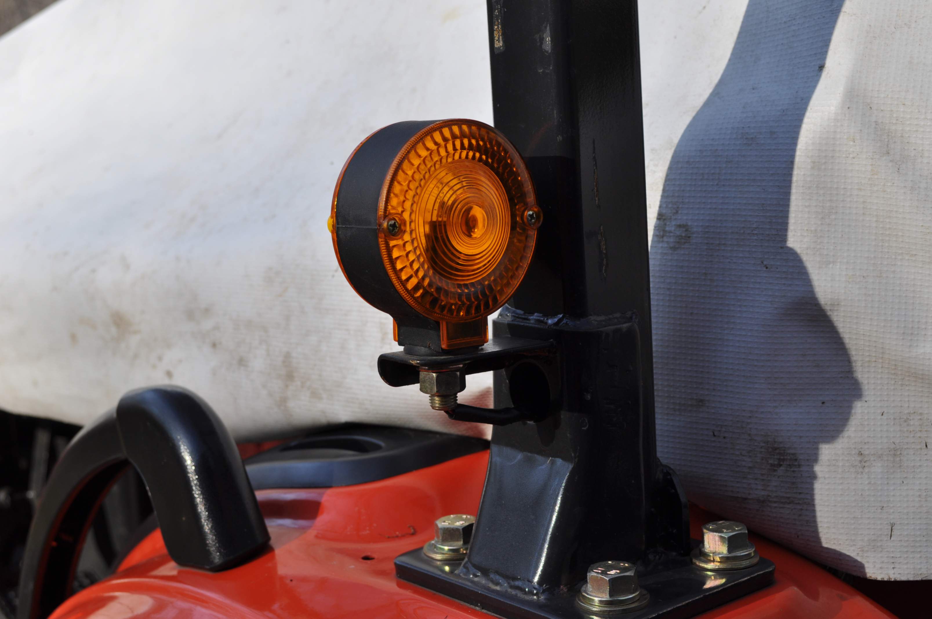

Also in that video, they have the blinker wires run wrong. Should be like this. DSC_4181.jpg

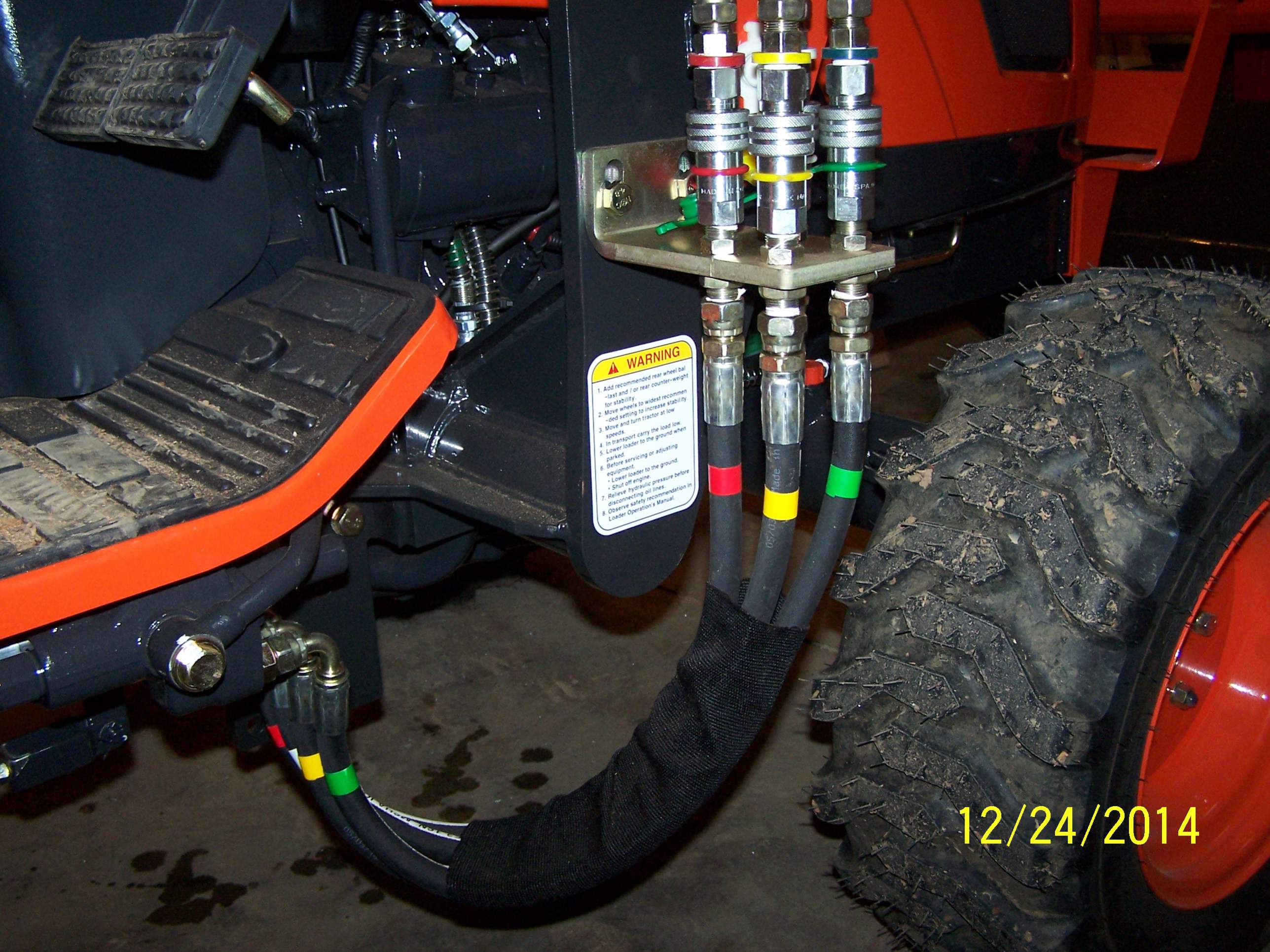

Is this your tractor's hoses? Much different from mine.
yes! I like your setup better! I sent my dealer this info to see what they say.My budget is tight right now, if it is going to cost allot I will have to wait to change it.

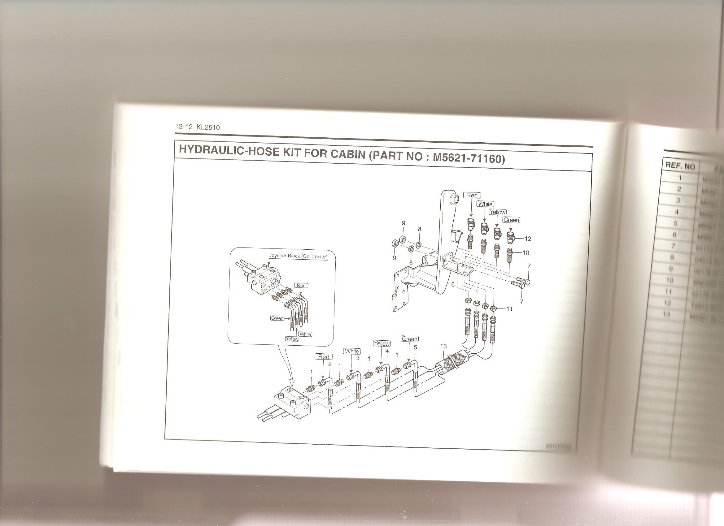

I can't imagine why it's different; it looks more complex and more parts. All I've seen are like mine and the one in the video, except he turned the lines up
/ hoses for loader #9
I can't imagine why it's different; it looks more complex and more parts. All I've seen are like mine and the one in the video, except he turned the lines up.
Oh, Correction. It looks like they gave you the kit for a cabin model. Bet that cost more too.

Called my dealer today about the hoses being for a cab tractor and he called his Kioti guy.The Kioti rep. said it's the time of year the tractors are shipped is the reason for the hoses.My dealer didn't know there was another way for the hoses to be. He said the Kioti rep. wanted to see pics of the hoses he is going to see what Kioti will do.I am not holding my breath.My dealer was very good at getting me a new cylinder to replace the one with the pin hole.

The PT probably stands for Pipe Tapered. And my guess for PF is Pipe Fine referring to parallel pipe and or straight pipe which generally has a finer pitch. I notice there was a Nut listed as PT also. Later
