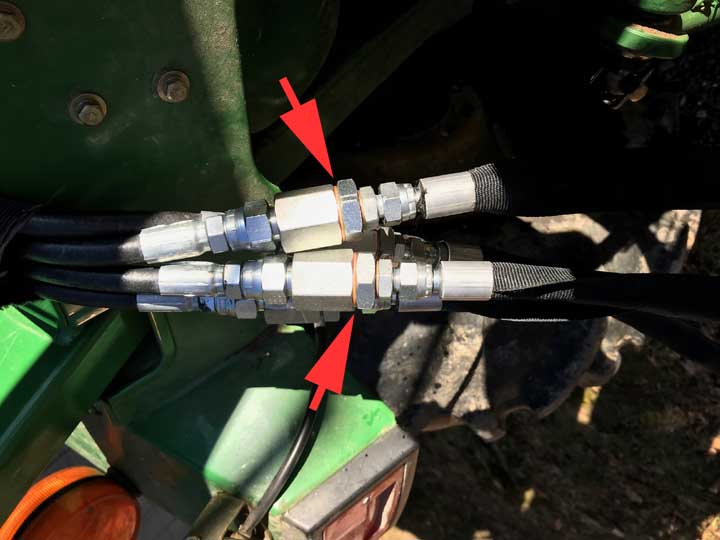

I bought an offset flail mower and the dealer installed extension hoses to reach the outlets for my FEL hydraulics. But the connectors they installed leak. Here's a photo of the connectors:
They leak at the brass seals as shown by the red arrows. The are very tight - I can't tighten them any more. Anyone have any ideas what's wrong?

That looks like quite a mess, I see female hose to female hose with three adapters in between changing hose size.
Discount hydraulics is active on this site, I'd get with them, you should be able to get one male to male adapter.

The fitting on the left may have a tapered female pipe thread which would not have a proper sealing surface for the straight thread O-ring bushing.
/ Hose Extension Leaks #10
FWIW...it looks like they are copper crush washers...it might be worth trying some new crush washers before buying different fittings if the leaks are the only issue...
Triptester,
I took it apart to see what I could find. I can't see that its a tapered thread, but it does have a chamfered seat which may not seal well with the copper washer. See photo:
Also, the last fitting - right on this photo, has a very small hole. Is that normal, or is this an orifice designed to reduce the speed of movement of the attached arm?
/ Hose Extension Leaks #12
FWIW...the F/F coupling (laying on the pencil) "appears" to be an SAE/ORB female fitting...it's hard to tell but SAE fittings are straight threads...Agree whatever it is...it's not a typical application for a copper crush washer seal...
BTW...yes the other fitting is a restricted orifice...

I would suggest identifying the thread type on the part of the fitting that is leaking. This could be BSPP or Metric. Both styles use several different sealing methods. There is also a Metric version of O-ring boss that would use an O-ring vs crush washer.

In case anyone else is following or having a similar issue - we have decided to swap out the copper washer for Buna Bonded Seals as the Metric / BSPP threads are straight thread, they need the O-Ring to seal, so I believe that the bonded seal will fix this right up. TerryR please keep us informed so we can ensure the proper resolution.
