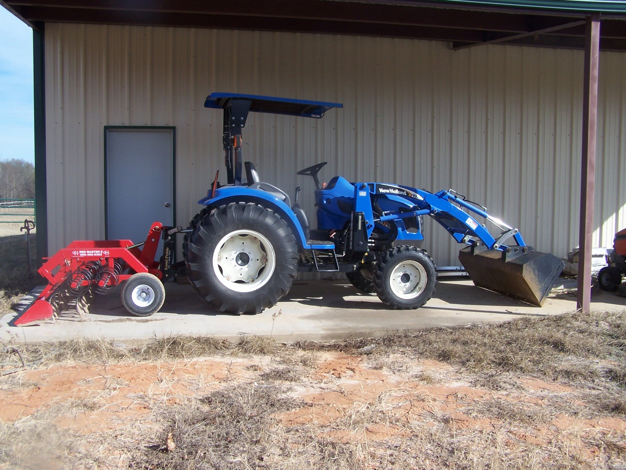

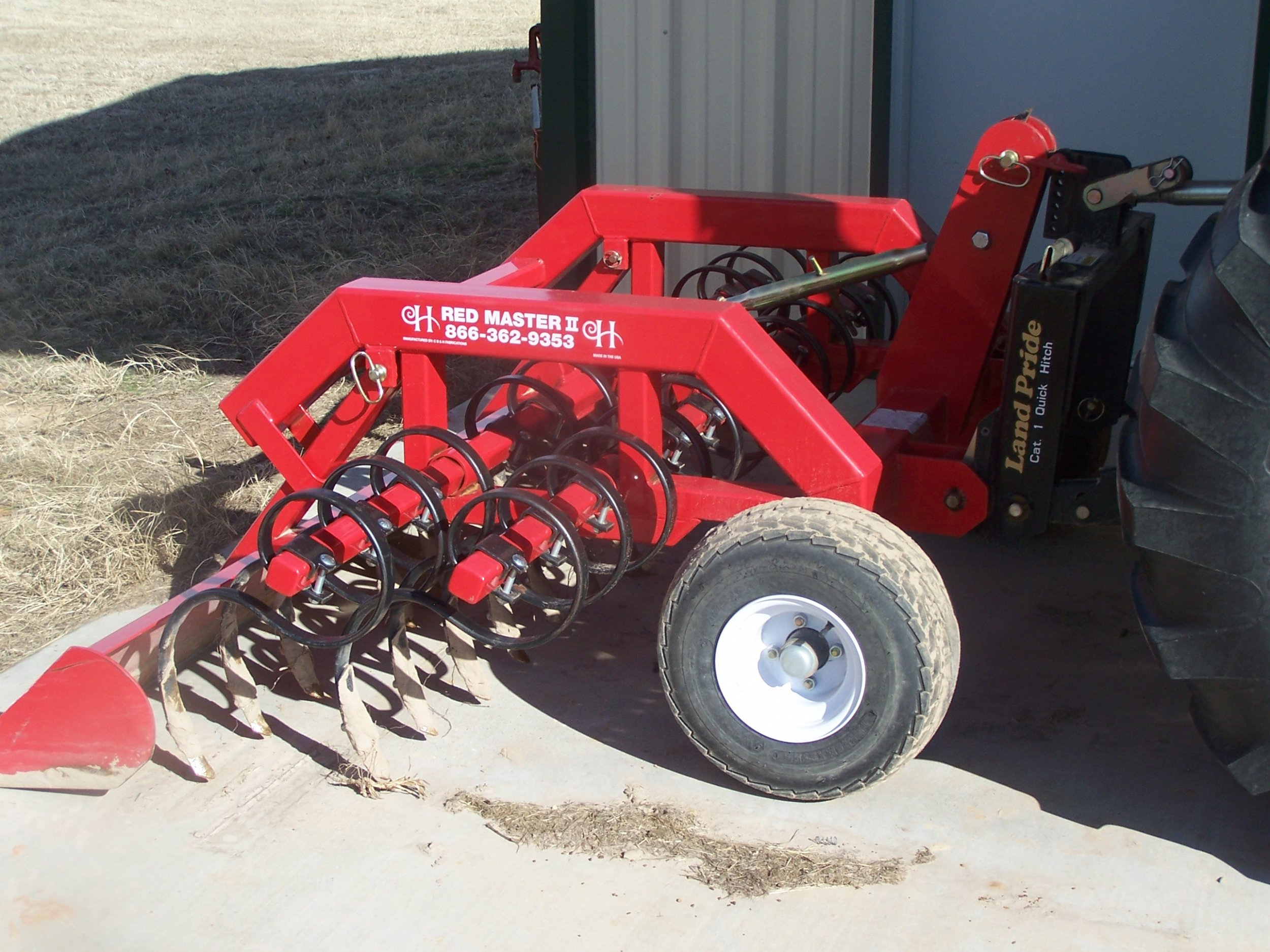

Here is our arena drag. Red Master II 8' wide. It stays on the TC40DA.

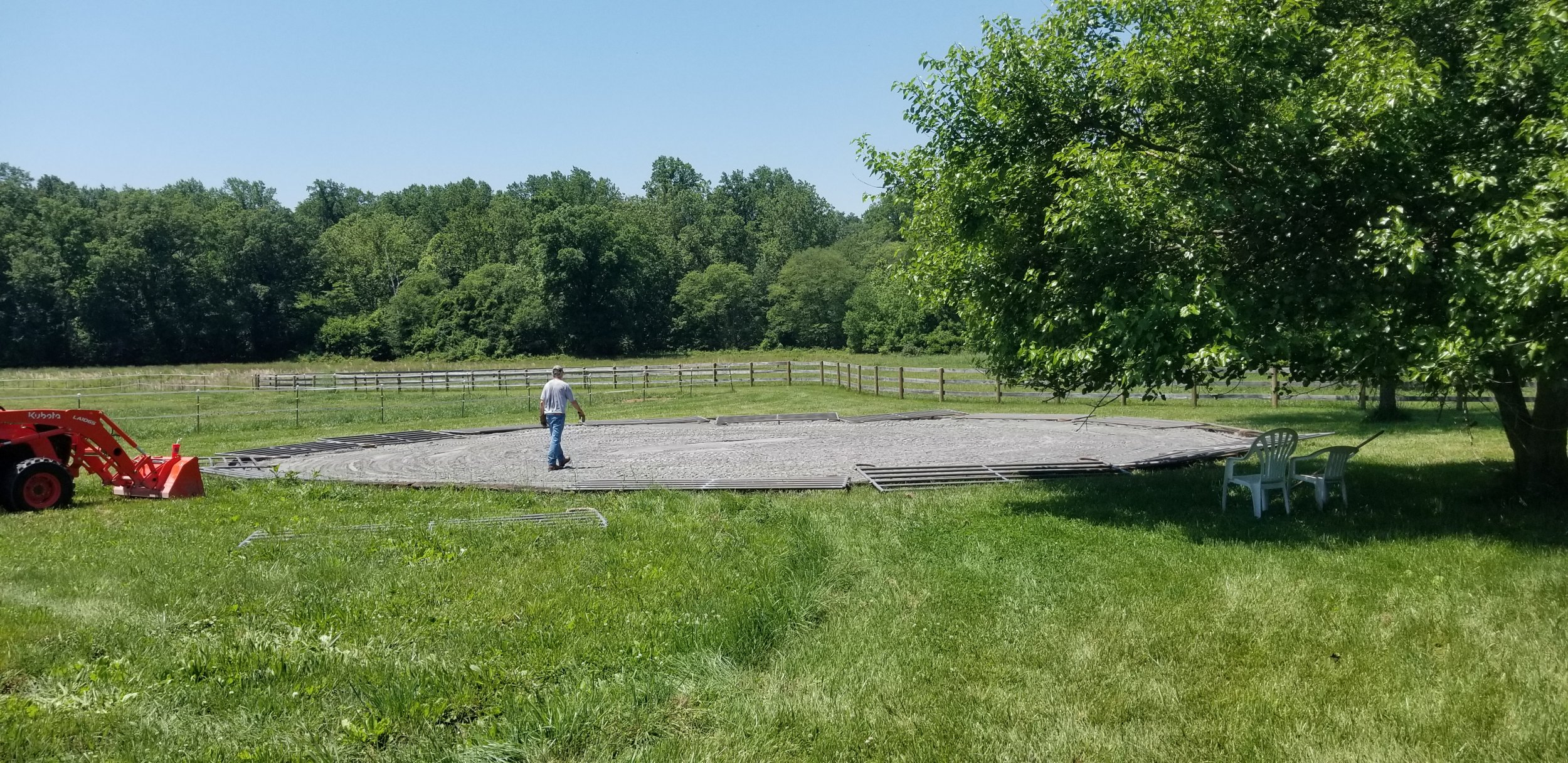

Just completed one a little while back. Ground prep was pretty simple, have mixture of clay bound soil under what was the top.
A little sand and a lot of "stone dust". Hardest part was positioning the rail road ties. And making sure the circumference matched the number of panels I had. LOL.
