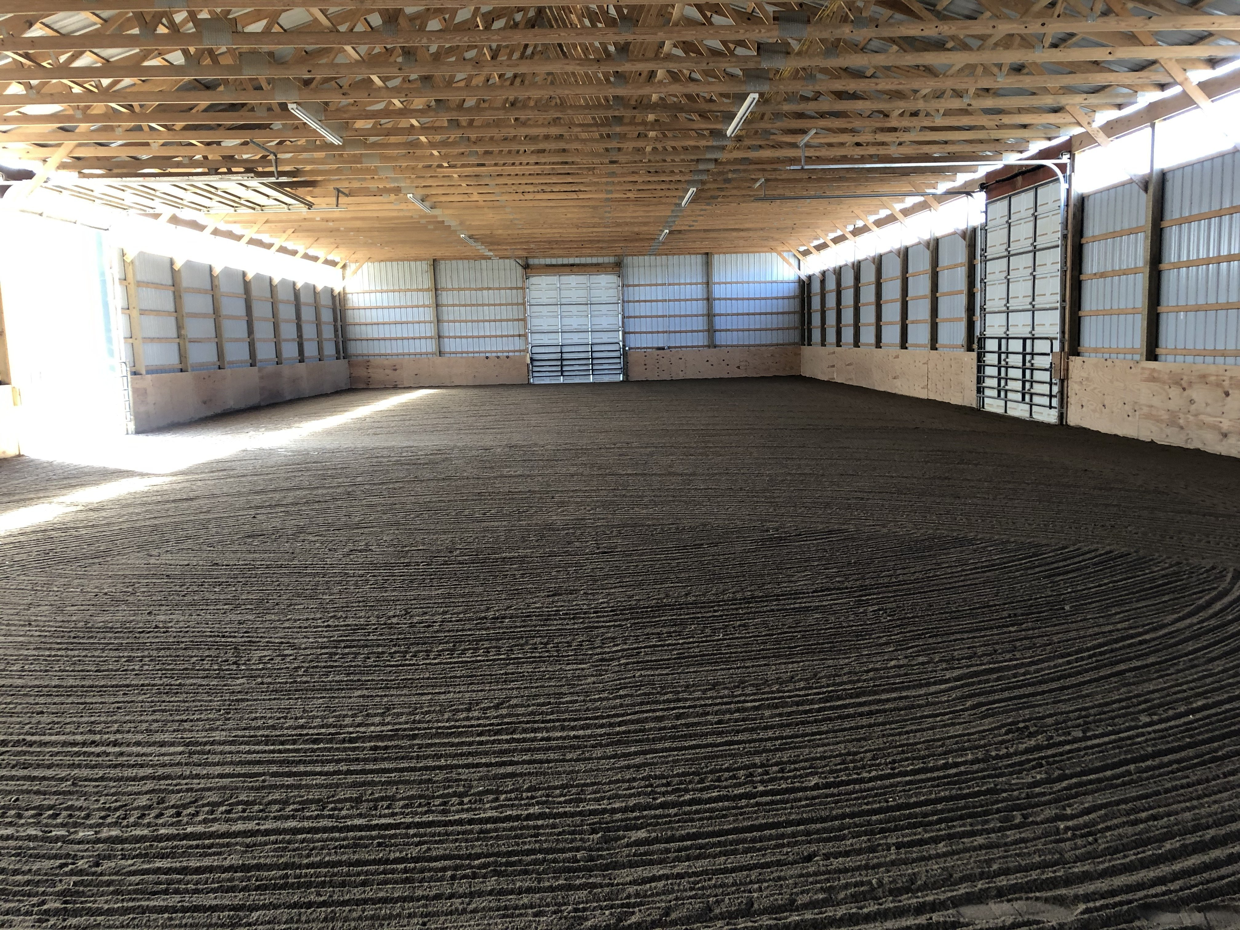

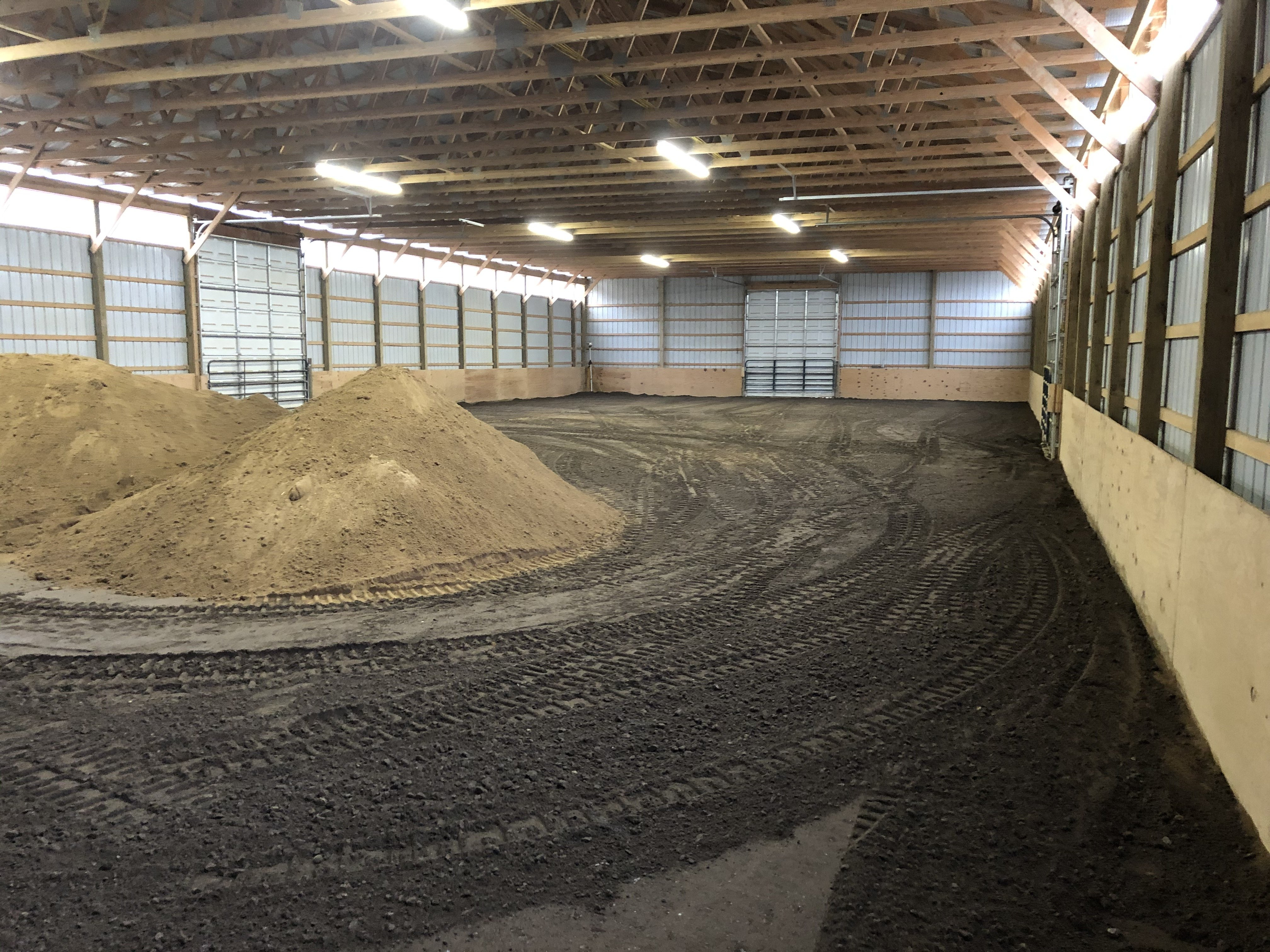

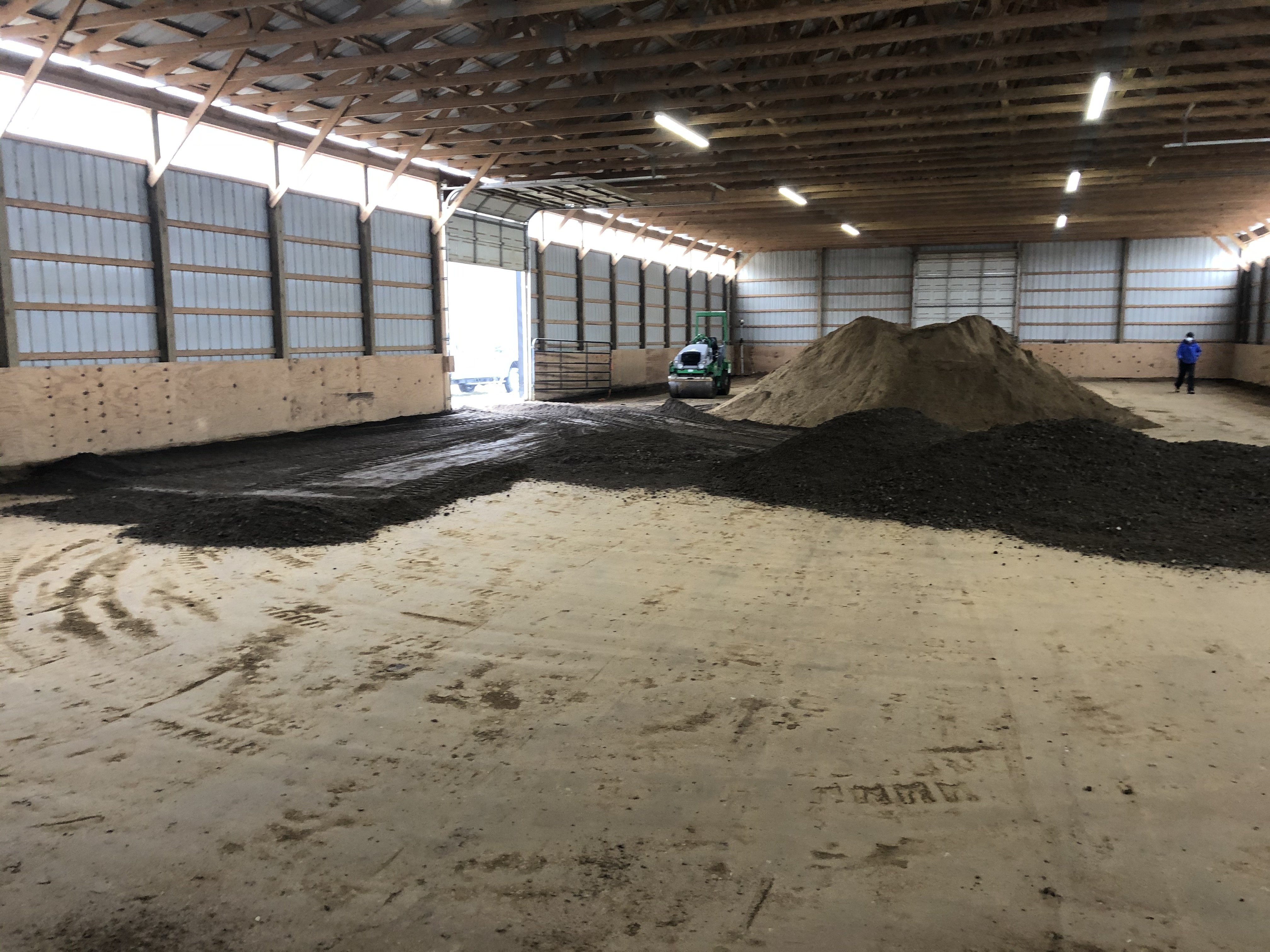

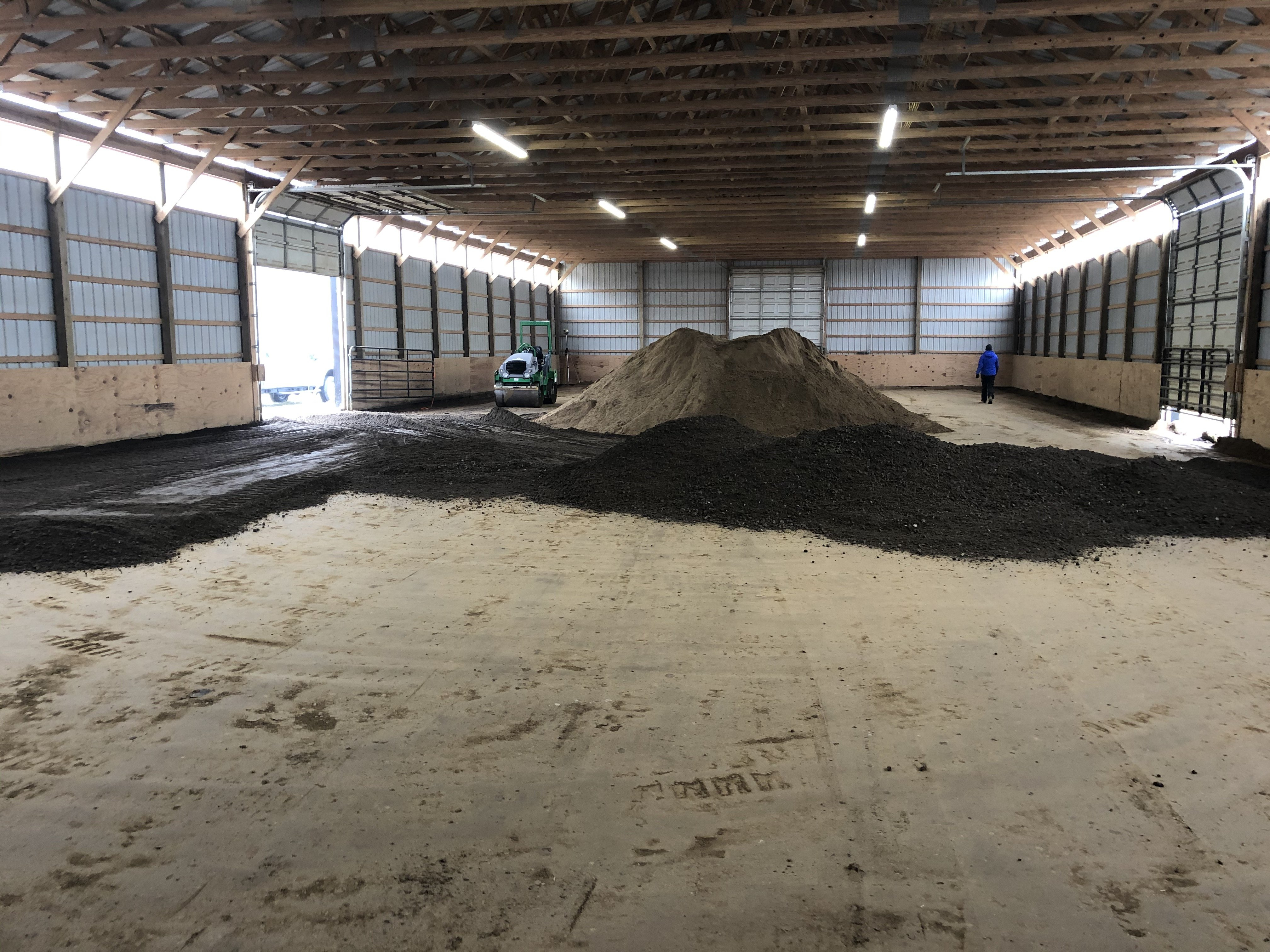

Project took about 18 hours to complete. Two guys with two skids, a roller and some fancy lazer equipment to do the leveling.
When we had the arena originally finished the guy doing the finishing did it by eye, no lazer. So we figured it was not very level. Lazer proves that to be wrong. There was no more than a 2 inch variance anywhere in the arena.
The piled the sand in the middle of the arena as it was the level they wanted. Then moved the clay base around until the rest of the arena was level. Ran the roller over that.
Then moved in 175 tons of #53's (stone dust). Leveled that and rollered it.
Moved the sand out of the middle and put stone dust there and rollered it.
Then spread the sand back out and lazer graded that level as well.
I woudl not have thought this project would have made much of a difference. You can tell just walking on it the surfance is different. It is easier to walk across.
A couple pictures attached if I am doing this right.
We are getting a bit more sand delivered tuesday as we are just a bit over 2 inches of depth and would like 2.5 to 3 inches of sand.

Looks good! For some projects, it pays to get the professionals with the right equipment and experience.
