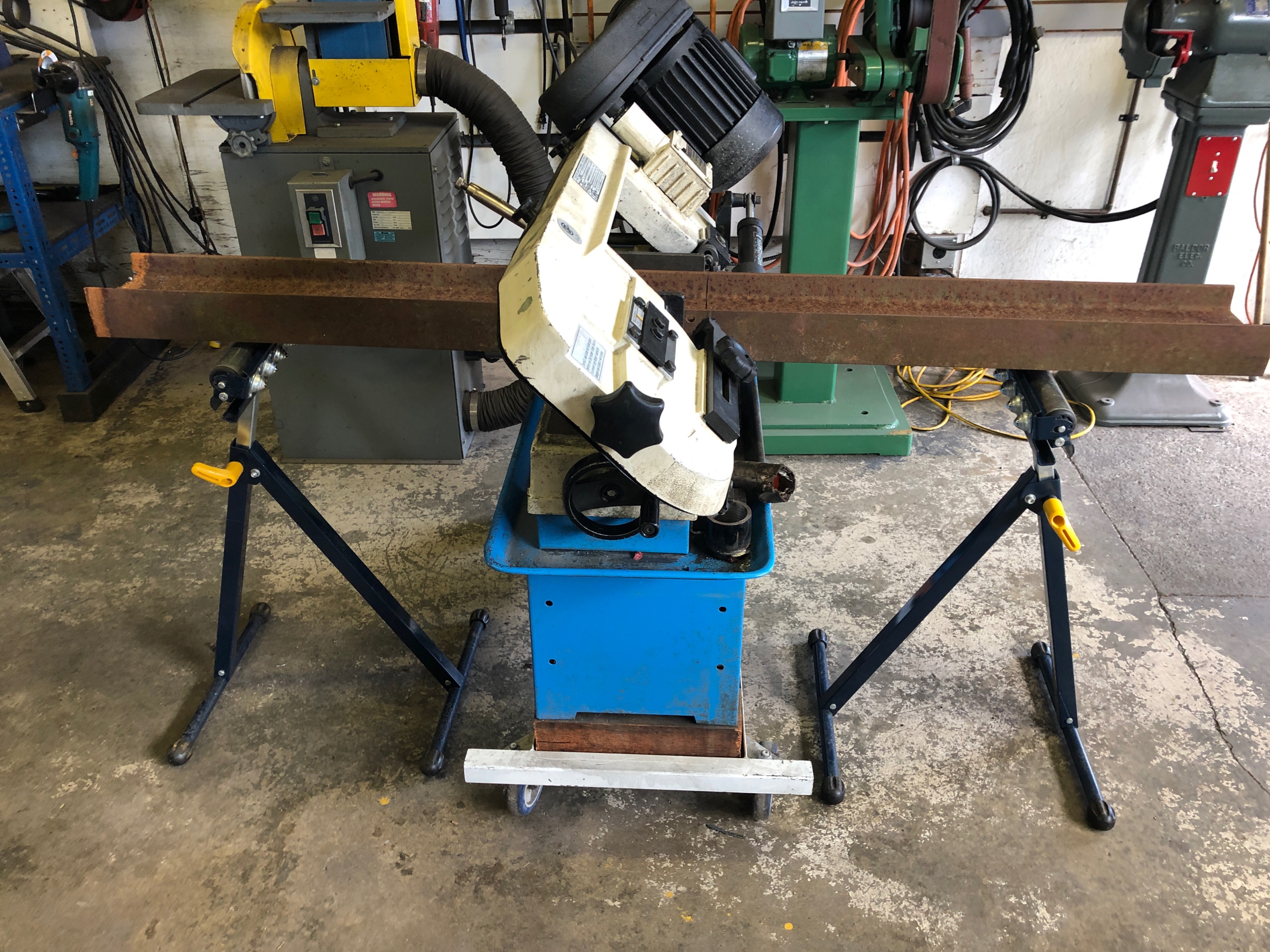

I picked up this Greenlee 1399 off a Facebook add. $650. I had to mess with the wheel alignment for about an hour and now it seems to run great.

Looks like a nice saw and easy to move out of the way when you are not using it. Make sure to spend the money and get good (not HF) blades - they will cut much straighter. We run a Behringer automatic bandsaw about 5 hours a day and get over a month on a good blade vs. a day or two on a "less good" blade.
