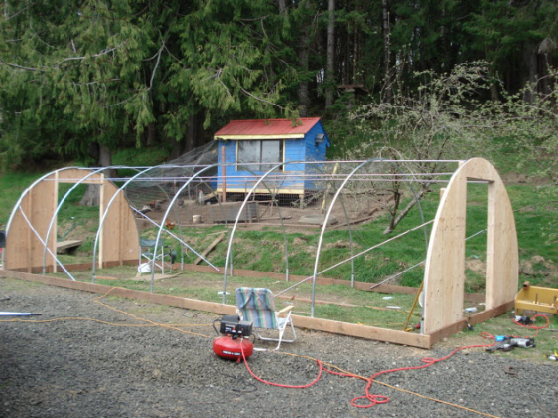

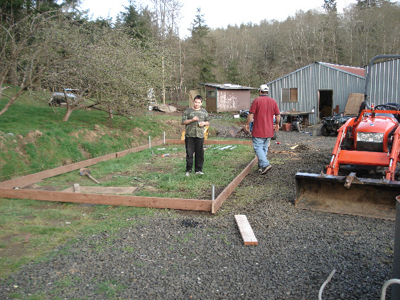

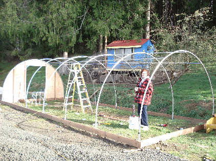

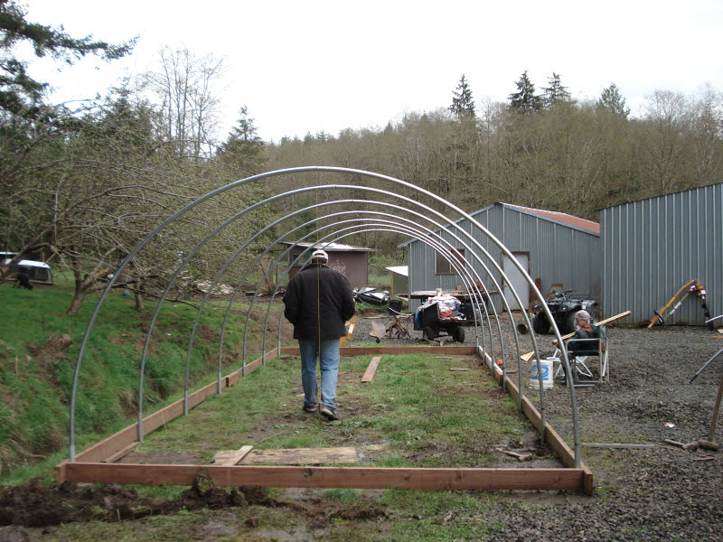

Well my wife wanted a greenhouse,and after looking at prices for "real" greenhouses we decided to go with the hoophouse style,
There are a couple of dealers in our area that sell the hoophouse kits we went to a few of them and liked the houses,and we were just about to purchase a kit from one of the dealers,when i found this web sight that sells the bender needed to bend the hoops yourself.well after doing the math I found i could bend the hoops myself and save money at the same time,because the kits are basicaly just the bent tubes and the poly covering and a few bolts...You still have to buy the lumber,tek screws,purlins(emt. coduit) hinges...ect.
All in all i was really suprised at how easy they are to build,and how sturdy they seem to be,it will take a pretty good blow to bring the structure down,dont know about the poly covering yet,should be able to let you know after this winter because we get some good winds here...
I have about 500 into this build,I had some of the materials,but i can bet you wont be out much more than 600 or so .....with the bender
Harbor Freight wants 800 for a 10x12, I built a 12x30 for 500 and have a 100 dollar bender to make more if i so desire,.....Maybe not as pretty as Harbor freights,But when theirs blows over your out 800 bucks when mine blows over just put another 150 dollar sheet of plastic on and your good to go...:thumbsup:

How high is it in the middle?
It is a hair shy of 8',I debated making it higher,then lower,and decided on 8' :confused: I think you can go from 6'6" to 10' high,or higher,but I think it becomes an issue with the wind once you get over 10', I am 6'2" and wanted the extra headroom an to be able to hang planters off the purlins.
They say to keep them low to the ground so they are cheaper to heat in the winter.
Also that is a 7 foot step ladder in one of those photos..

the poles are chain link top rails as you know,what bender do you have?I have the c bender ..one thing to remember is keep rolling your pipe towards you with your wrists, and make the pylwood jig as he says i messed up a couple poles by not keeping the end on the slats as i was bending it...oh...have to get on the plane will try to get more info to you tonight..........

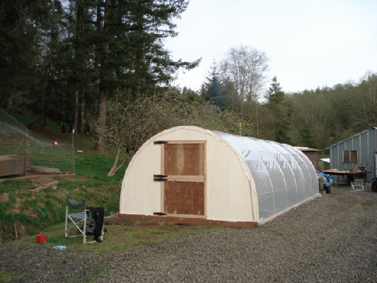

No I did not use wiggle wire,just because I did not have it I stapeled the plastic to the bottom board then nailed a 1x4 over the plastic then folded plastic up and nailed another 1x4 over that,and let left over plastic fall back to ground and covered with gravel,as kind of a gutter.
Ihave read that if you are going to double plastic it that the wiggle wire is the way to go...it is really cheap, I just didnt know where to get it until now
I used 3/4 emt for the top center purlin and 1/2 for the two on either side
the center purlin. I had some of the saddles like if you where going to attach the emt to a wall, and tek screwed them direct into the hoop.with one 3/4" tek screw through the saddle into the emt,to keep it from sliding,seems to have worked
The 1/2" purlins(side)are tek screwed direct through the emt into the hoop you could use brackets there also but I did not have any,and they are doing fine without them.
The studs are attached by 1/4" lag bolts through the base board and the hoop on the top side,then the plywood is attached to the stud and then tek screwed to the hoop .and thats about it you can pretty much do anything you want,lostcreek has a pdf you can download and that is what I followed for the most part and looking at pictures of other hoophouses ,I still want to put a trim board over my plastic on the front an rear to make it look a little cleaner,but its not needed thats just me.
Oh yeah,I just rolled the plastic by hand on the front and back and stapled it to the plywood,pulling tight,and staple, I left about 3 inches from the top of the plywood to the rolled up plastic and also cut little wedges in the plastic so that it conformed around the circle better??/
