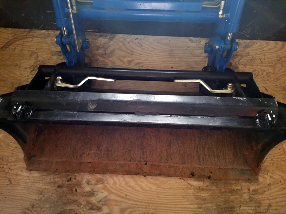

Thinking of installing a pair of Kens Grab Hook/Clevis Combo on my soon to own Kioti.
Yea? Nay? Good? Bad?

Grab hooks on your bucket = good. I do not weld so mine are bolted on.View attachment 569808 Not so easy to see the hook - its a "grab" type.

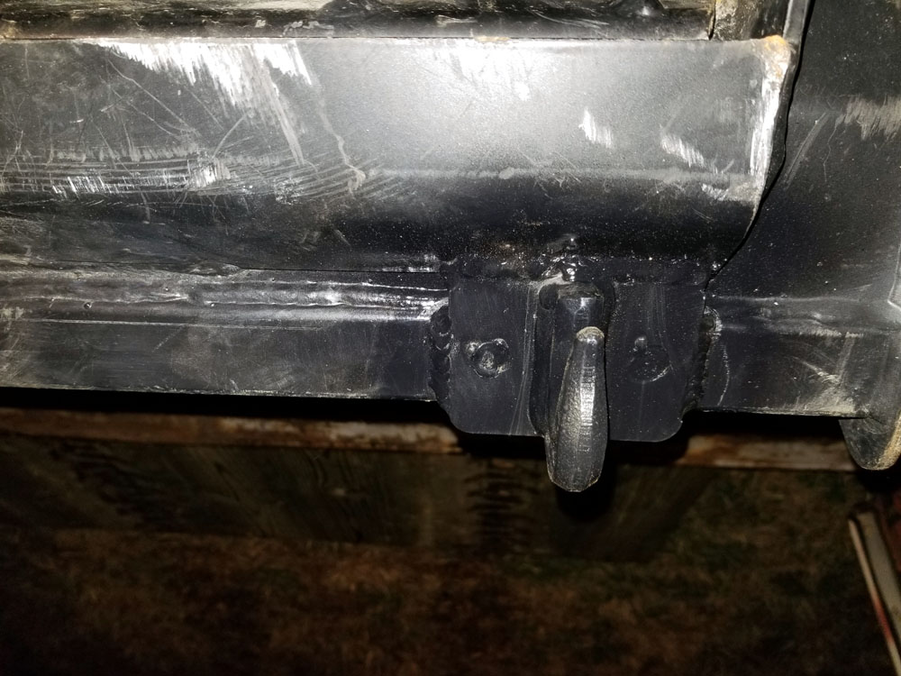

You need to look at how the bucket is constructed first. Some don't have a good spot to fully back the plate for the bolt-on type. For my last tractor I bought a set of Ken's bolt-on but when I tried to put them where I wanted, I didn't like the plate overhanging the more narrow tube frame. So ended up welding on my bolt-on hooks :)
I put example in your chain thread of how mine are on current machine. If buying new, just have the dealer weld them on. Will be free or very small charge for 2 basic 5/16" weld-on grab hooks.

Here are examples on my LS of how the bolt-on hooks didn't fit well due to bucket construction. Would have probably worked just fine since it didn't have tons of lift strength. But looked like the plate would want to "cam" against the fastener, so just welded.

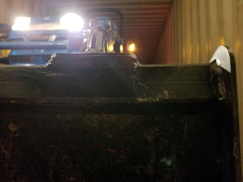

Luckily the top of my bucket has a 5-6" flat top. I welded two hooks on a flat plate in line with the arms to hopefully prevent any twist pulling from odd angles and a receiver tube in the center for other hooks or loops or balls etc. The welded the plate to the top of the bucket and painted. It works great for me.
