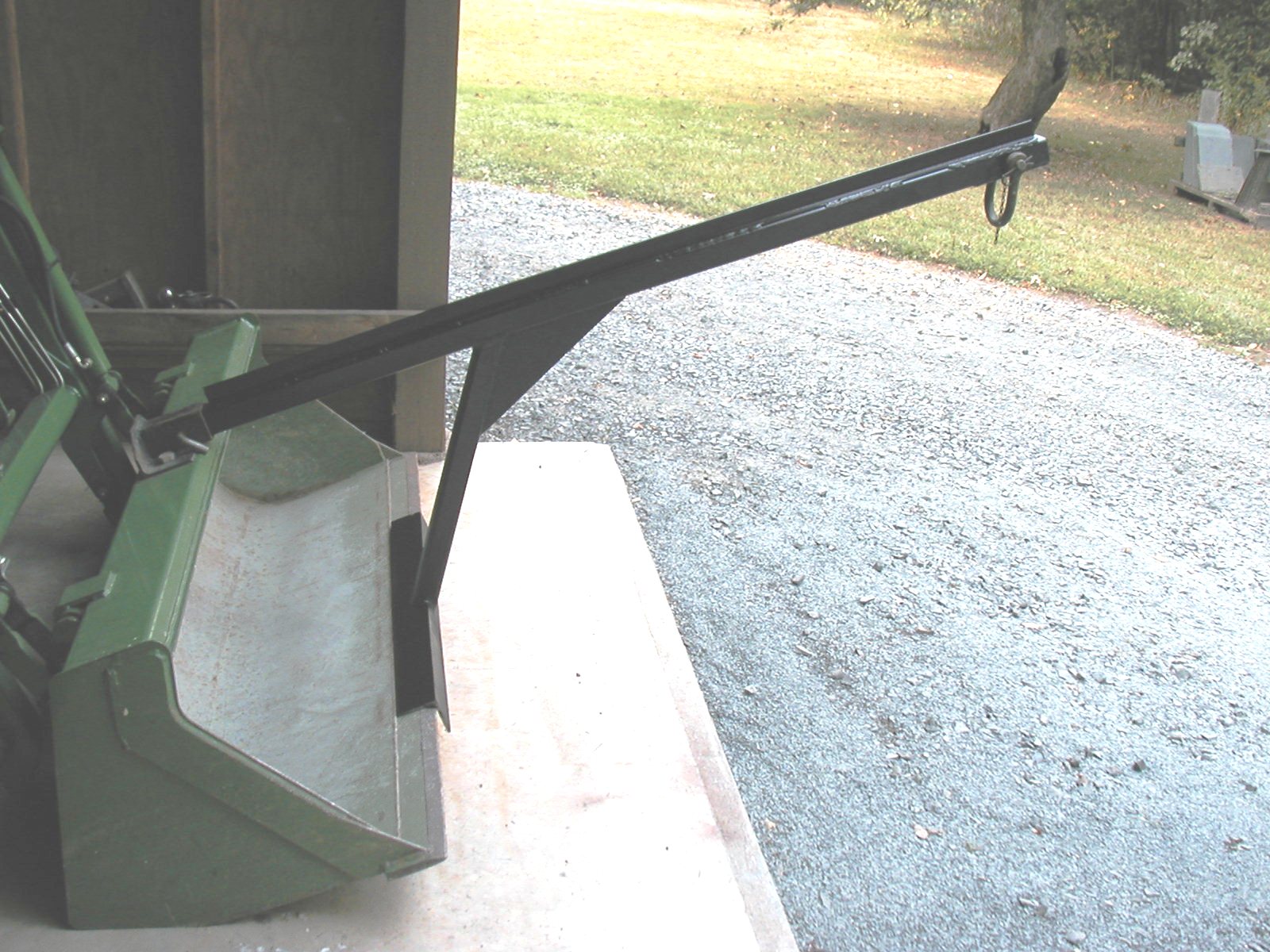

I went a different route, IMO this is all you need and more.
   / Hooks on a BH bucket... how many and where? #7
JB4310, that's not a BH bucket.
   / Hooks on a BH bucket... how many and where? #8
Oops, didn't read the OP close enough, thought it was another loader bucket hook thread.
