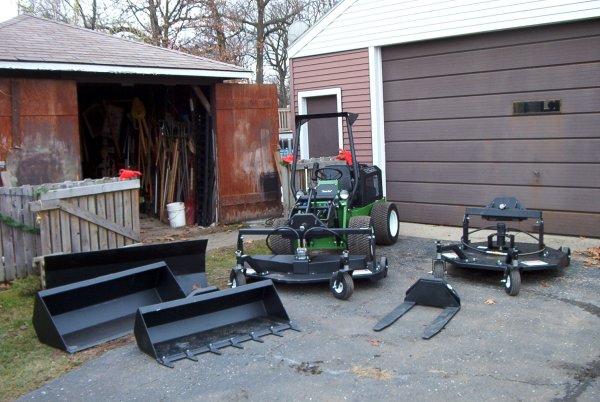

Off-topic: Is there such a thing as a hydraulically operated mower?
Yes. I have a hydraulic finish mower and hydraulic brush cutter.
