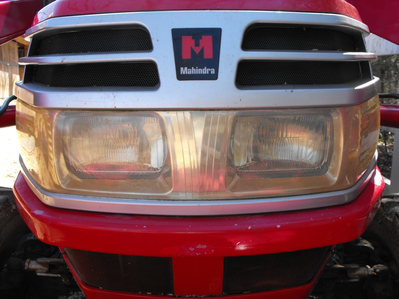

If what you are saying is true, (about what looks like glass) then the newer ones are different, because the only glass that is in mine is the actual light bulb itself. I have seen where the silvering has gone bad on the reflector because so much water had gotten in past the front yellowing lenses that seems to be common. Just a note, the ONLY clear lense that I have ever seen was-is mine after it was replaced with a new one out of a box. It would still be clear if it didn't have dirt all over it on the (sealed :laughing:) inside.

Took pic of headlights so you can see the actual face. On the bottom front of each headlight is a manufacturer and part #(IMASEN ELECCO 1111-232)
Thanks for the picture, is the plastic that is behind the front lense painted silver or is it chromed? My tractor is not right here, I will check it out this weekend. Something else is different, I think around the headlight area, but without having pictures side by side I don't want to guess. :eek:
Hard to tell for sure but I would say it's a chrome-like paint finish.
