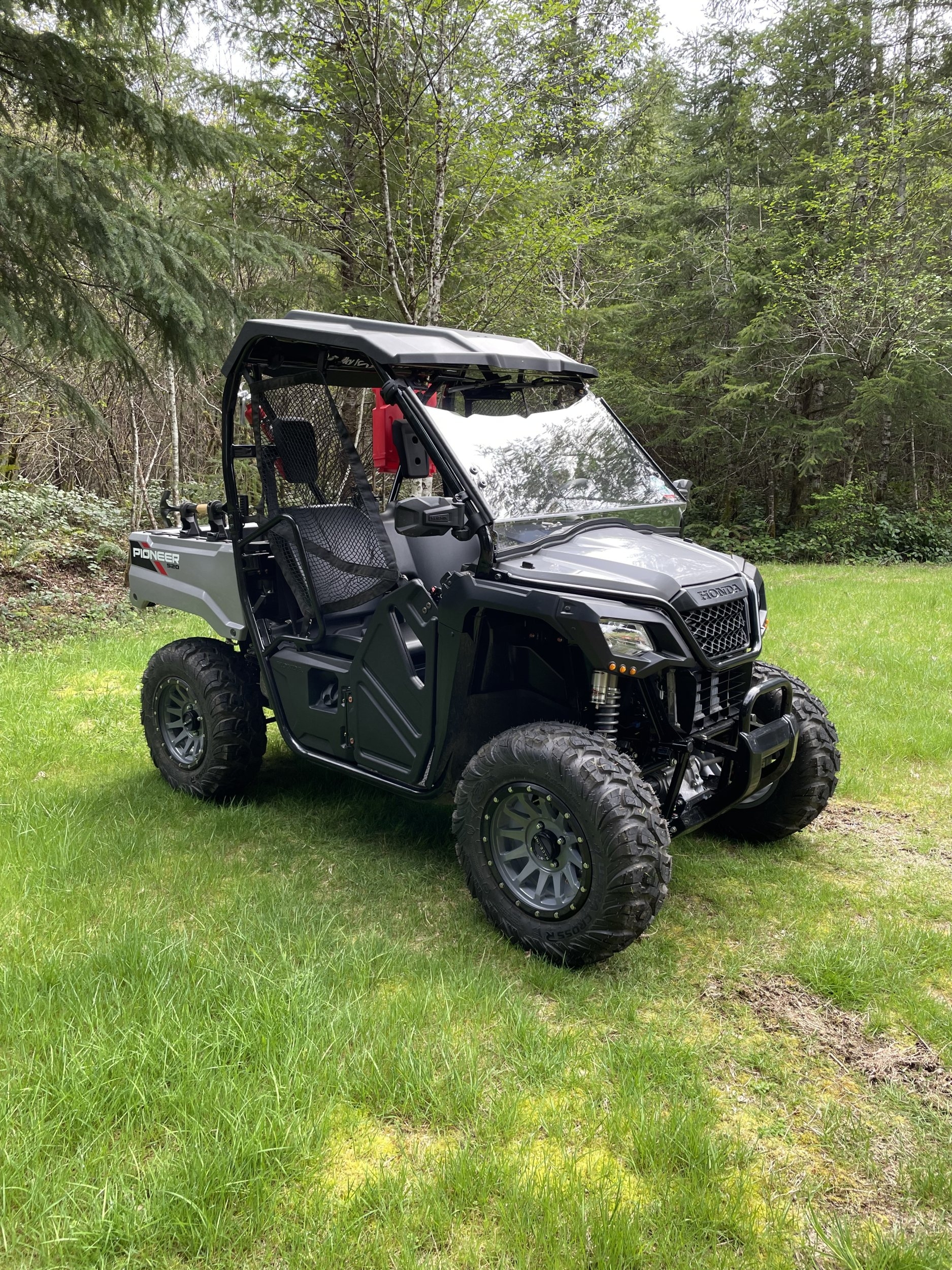

The transmission shifting does mellow out after the first service and some use. It’s certainly not a smooth shifting transmission but, I prefer it over any CVT. I love the size of the P520! As you mentioned, it fits in the bed of your pickup (no trailer required) and it is great for navigating narrow trails and tight places. The engine, with the help of the gearing, has plenty of low end torque.
I’ve installed a TON of upgrades on my P520 and it just keeps getting better!
