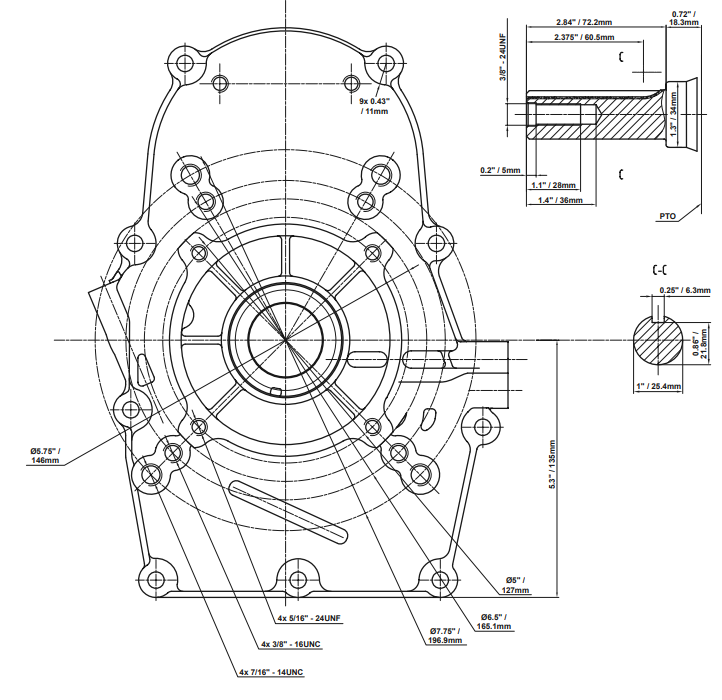

670cc Predator output shaft specs:

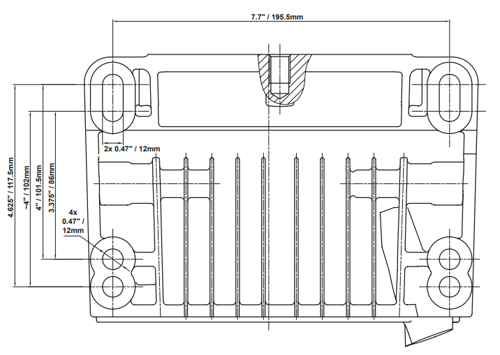

Predator base mounting diagram:
Predator output coupling diagram:
Suggest finding the equivalent specs for your Honda and comparing:

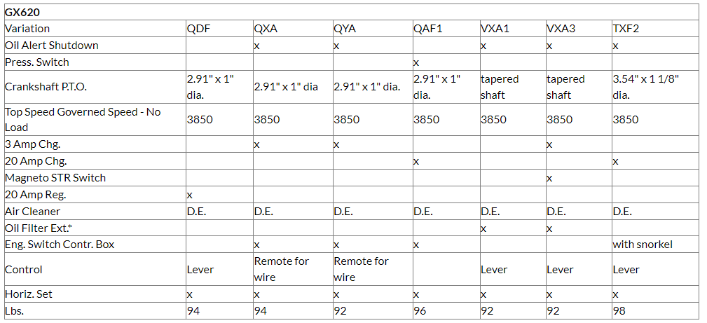

Output shaft depends on sub-model per chart here:
