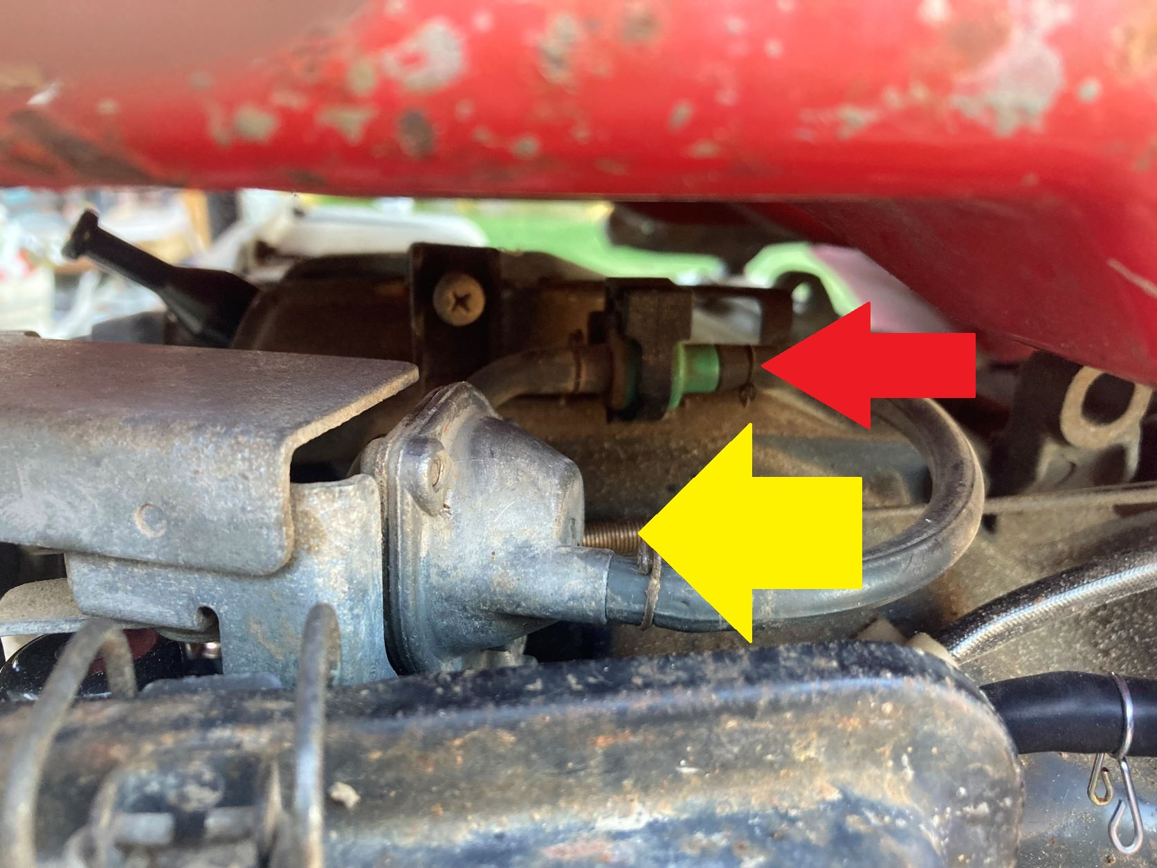

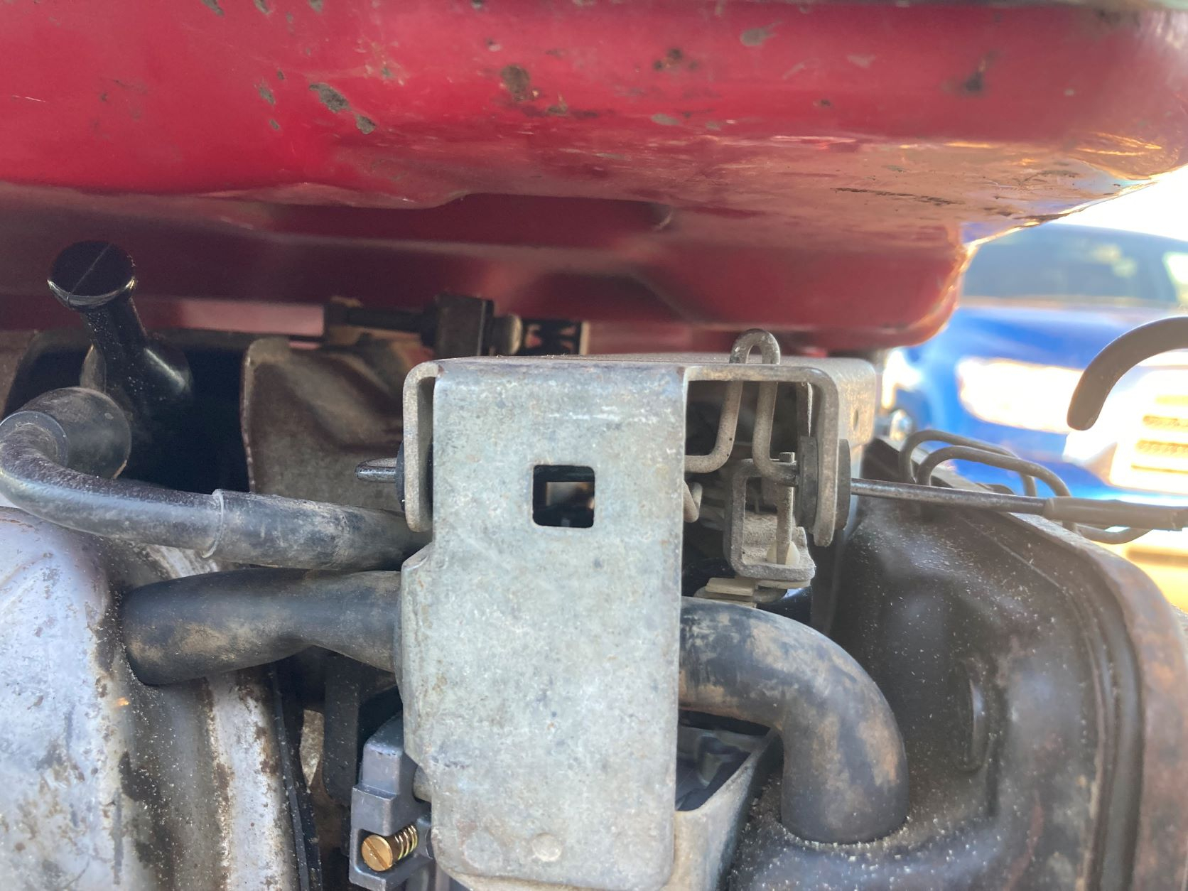

Hi all,
I recently pulled this old generator out of my dad's shed. It hasn't been used for many, many years but ran once. Anyways, I'm having a real hard time getting it to start. I replaced the carburetor, replaced the fuel line, replaced the shutoff valve, sparkplug, and air filter. I have confirmed there is fuel to the carburetor and confirmed there is spark.
I'm convinced it is a linkage/carburetor issue but just don't understand this carb. It has two butterfly valves in it. If I manually hold the linkage where the innermost (nearest the engine) butterfly valve open, I can get it to run for about 1-2 seconds then it cuts out. I suspect the outermost butterfly valve is staying closed and choking it out. But, I can't figure out how to determine if this is really happening. In the attached pic is a yellow arrow pointing to a vacuum pot that I think open the outermost butterfly valve. Is this what this does? The vacuum line goes to the green "thing" with the red arrow. What is this green "thing"? and then the vacuum line continues to the carburetor.
Can you help me out with these questions? Does anyone have one of these generators or carb/choke setups that could answer some questions for me so that I know the linkages are all correct? I believe they are.
Thanks so much in advance!

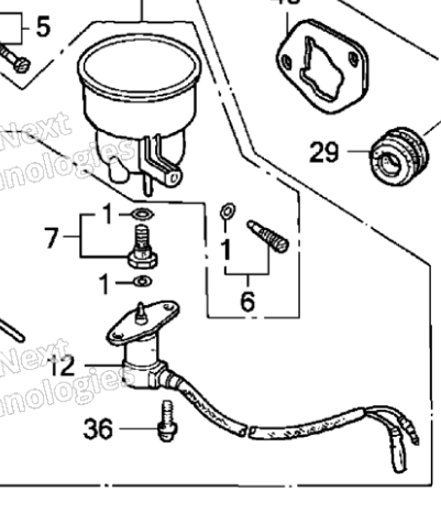

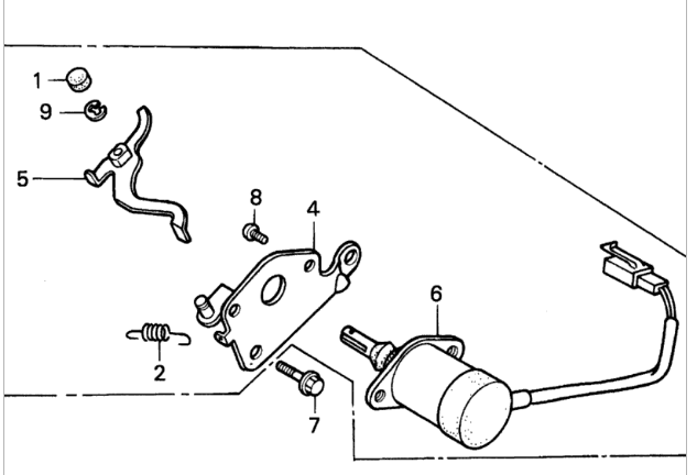

A few questions.
- Do you have the throttle control connected and does it work ?
Throttle control
And I see that there is a fuel shut-off solenoid. Is this connected and does it work ?
Shut-off solenoid is #12.

Thanks again Richard! It does have a fuel shutoff and it is new. I'll try testing it. Relatively simple test.

For the throttle control, which it does have, is there a way to test it? I was thinking this may be suspect. Thanks again.

Also, on the EB series, you should be able to manually choke it and override the throttle with a screwdriver to manipulate the throttle.
I would think that since it is not an OEM carb, that taking the old carb and soak in Berrymans, clean the jets and trying that may be the better route to eliminate what might be happening. Hondas very easy engines to work with so this doesn't make a lot of sense other than the carb change being the change in the picture.
