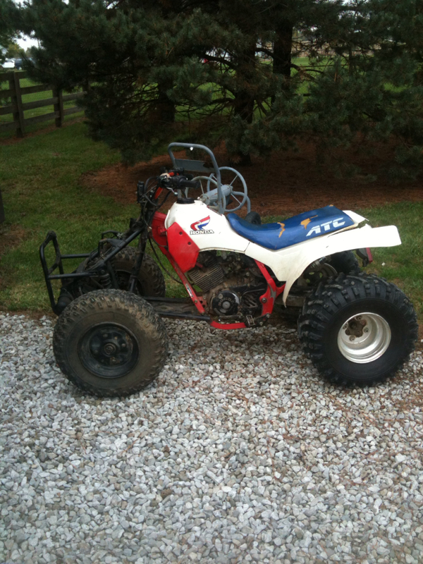

it looks about the same as the one i remember as a teenager. is it chain or shaft drive? does it have high/low only, or does it have reverse? are you sure it is a 250cc engine? i remember ours as an 82 or 83 model big red - electric start, enclosed chain drive, high/low (no reverse). i was also thinking it was only 200cc back then. the later models - 84? had shaft drive & reverse.
It is chain drive I think it has a little slack in it though I can hear a slight click when coasting in gear. I believe its the 200cc the guy I bought it from didn't know anything about it. he told me it wouldn't run. yes this model is supposed to have es on it but it has been removed and rigged. yes high and low gears but unfortunately no reverse!

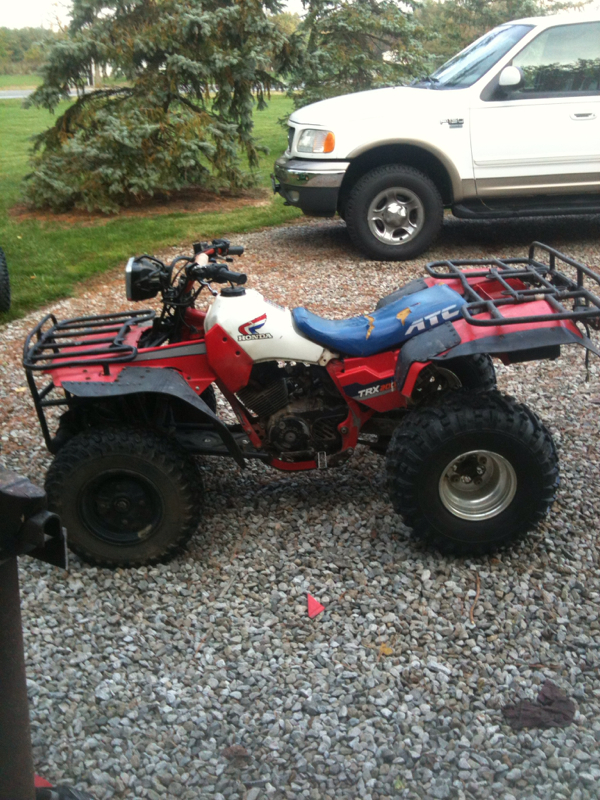

Nice chuck! I haven't seen anything like that, looks like you had your hands full!
It was actually pretty easy. When you put them side by side, you see how similar they are. It took about five hours to complete. I'll try and get a few build pics. Anyone need a front fork and tire from the old front end? Just can't throw it away. Lol
