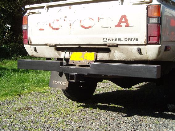

Hi all,
Well, here it is. My new bumper. It's made from 1/8" wall 4x4 tubing, the step is filled in with 3/16" plate. The ends are capped with 1/4" plate. The receiver is some old bolt-on unit I picked up from the scrap yard (along with the rest of the steel). I used the original bumper brackets, they has a little "J"-bend (in cross section) for added strength from the factory, so I welded on a piece of 1" wide plate to make it a full channel for even more strength. It's passed the test, just the other day I towed a trailer weighing in around 1500-2000 lb. It works beautifully!

Nice job!
