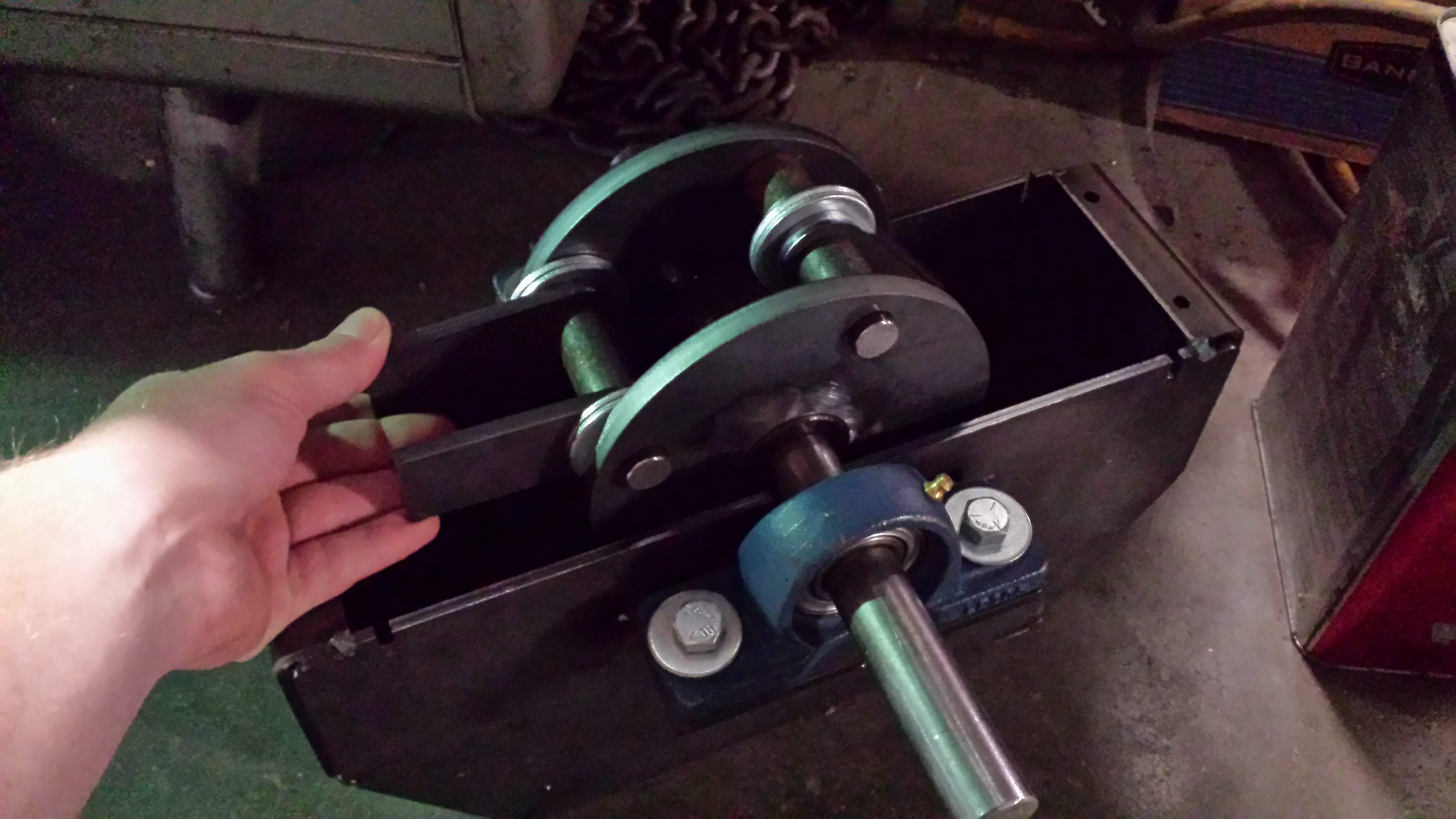

Im about to the test stages of my current project, building a small hammer mill to crack corn for chicken feed. I will test it using an electric motor (3/4hp) but I plan on making it run off the pto on my cub cadet compact tractor. I will post more pics and info later tonight. Here is a current pic tho. What do you all think?
4" wide. 10.5" diameter rotor. 8 hammers. Final speed 1800rpm..

what are you using for screens? most likely you will not need a very small screen, with at speed and if the corn is dry, (I have not hammer milled corn but my Dad did and it seems he would use a 1" screen or he would powder the corn, now I think he was doing ear corn as well),
I made a burr mill a few years ago, for grinding feed,
looks like a very nice job your doing,
do you have a lathe to turn parts?
did you make the hammers, or buy?
/ homemade small hammer mill
I currently have 5/16" holes in my screen. Im trying to make chicken feed, and also hoping I dont end up making flour lol.
I work in a manufacturing company, so I have access to all the metal working tools.. lathes, mill, plasma, laser, etc.
I have access to pretty much anything I would need.
The hammers are 1/4" AR400 laser cut.. by me
screens and body are 3/16" HR plate.. laser cut.
I plan on making a bigger one with more capacity if this one works good.. time will tell lol

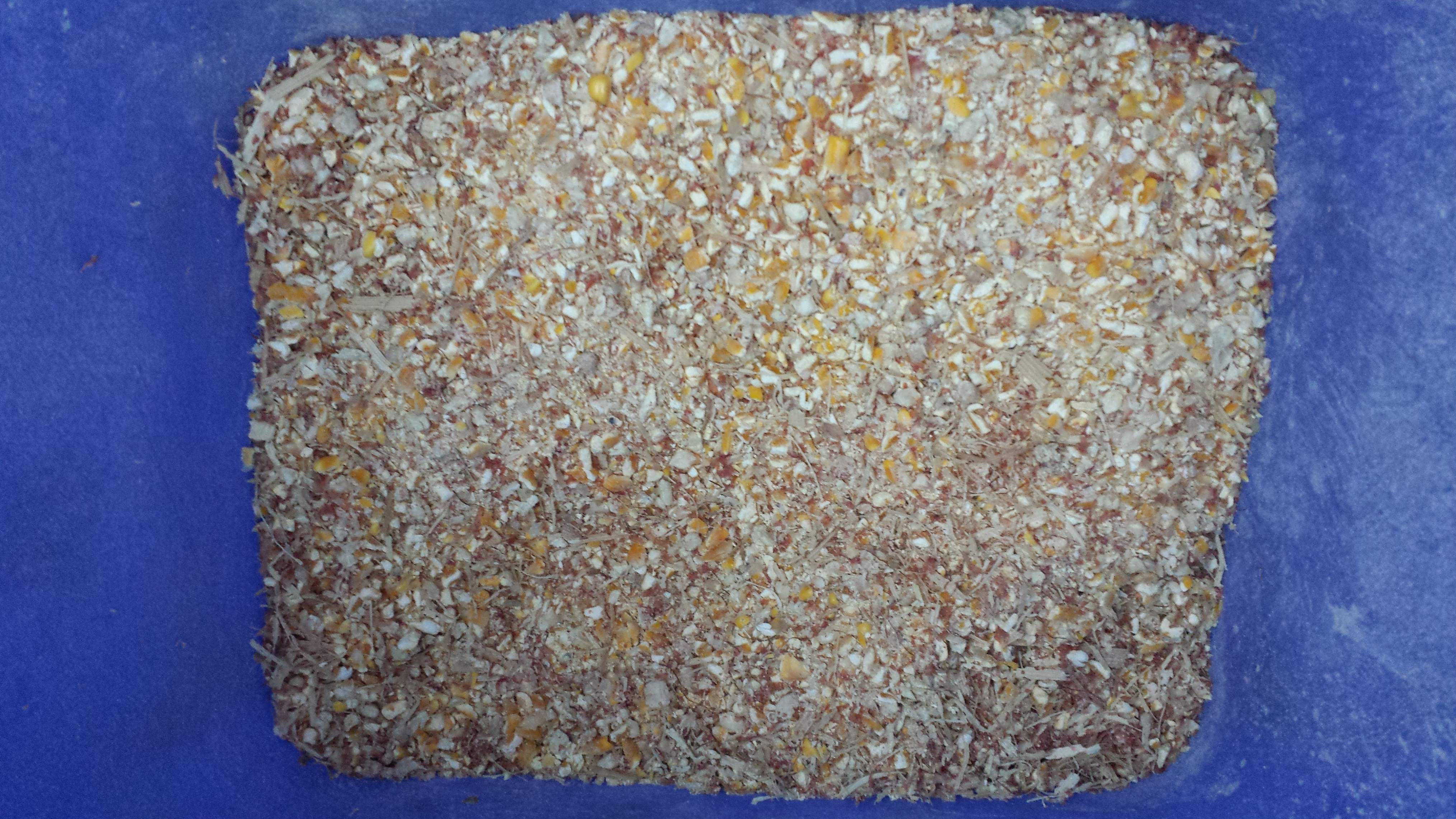

I have tested it out a few times now, it seems to do an awesome job!! Chickens love it and so do the 2 pigs I'm raising.. Which are only 50lbs right now. I think the 5/16 inch screen is the perfect size for the chickens. I will post a few current pictures and also some of the final feed product.
I also have ran approx 2 dozen ear corn thru it also. Cob kernals and husk.. Takes longer but does an awesome job on that too!!

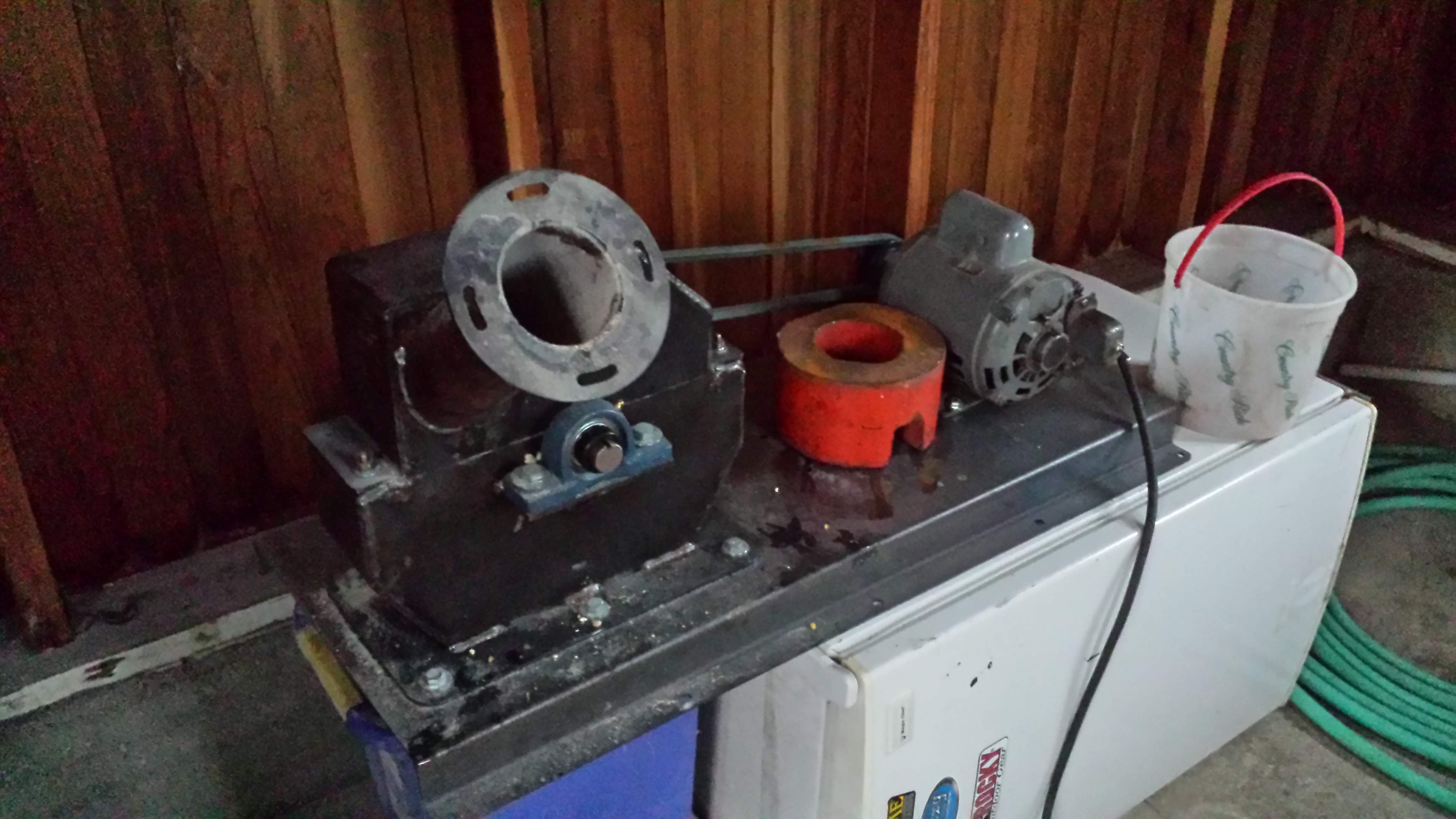

I still have to build a stand for it along with the funnel that catches the ground product out of the bottom.. I have it made just need to bolt it on.
Here is a picture of the little contraption, its not a very good picture, but it shows the overall size and what I have done so far. The motor is a 3/4 HP 120v that I borrowed off our hay elevator. The Blue tub is there to catch the ground feed.

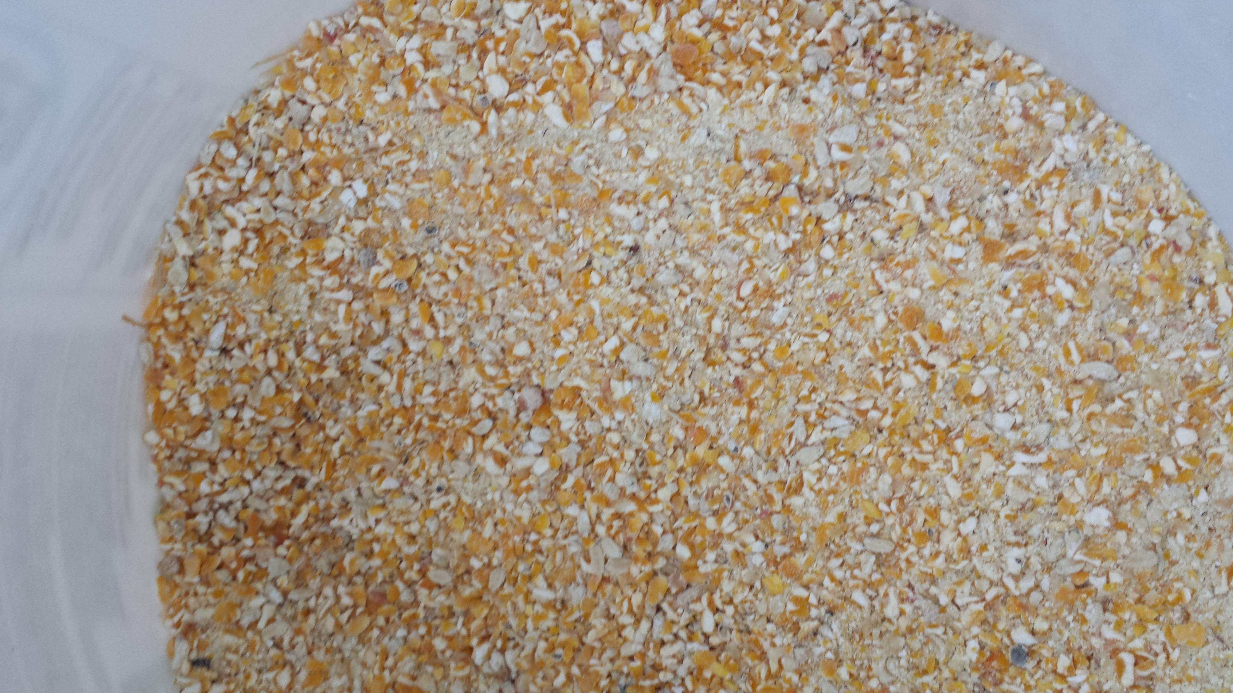

Here is a picture of shelled corn after I ran it thru. I find that the slower I feed it, the smaller it cracks it. But even while feeding it fast, it still works awesome!
Here is a picture of some whole ear corn with husks still on it that I ran thru the mill. It took longer, but still did a good job and quick for the overall size and power of the hammer mill.

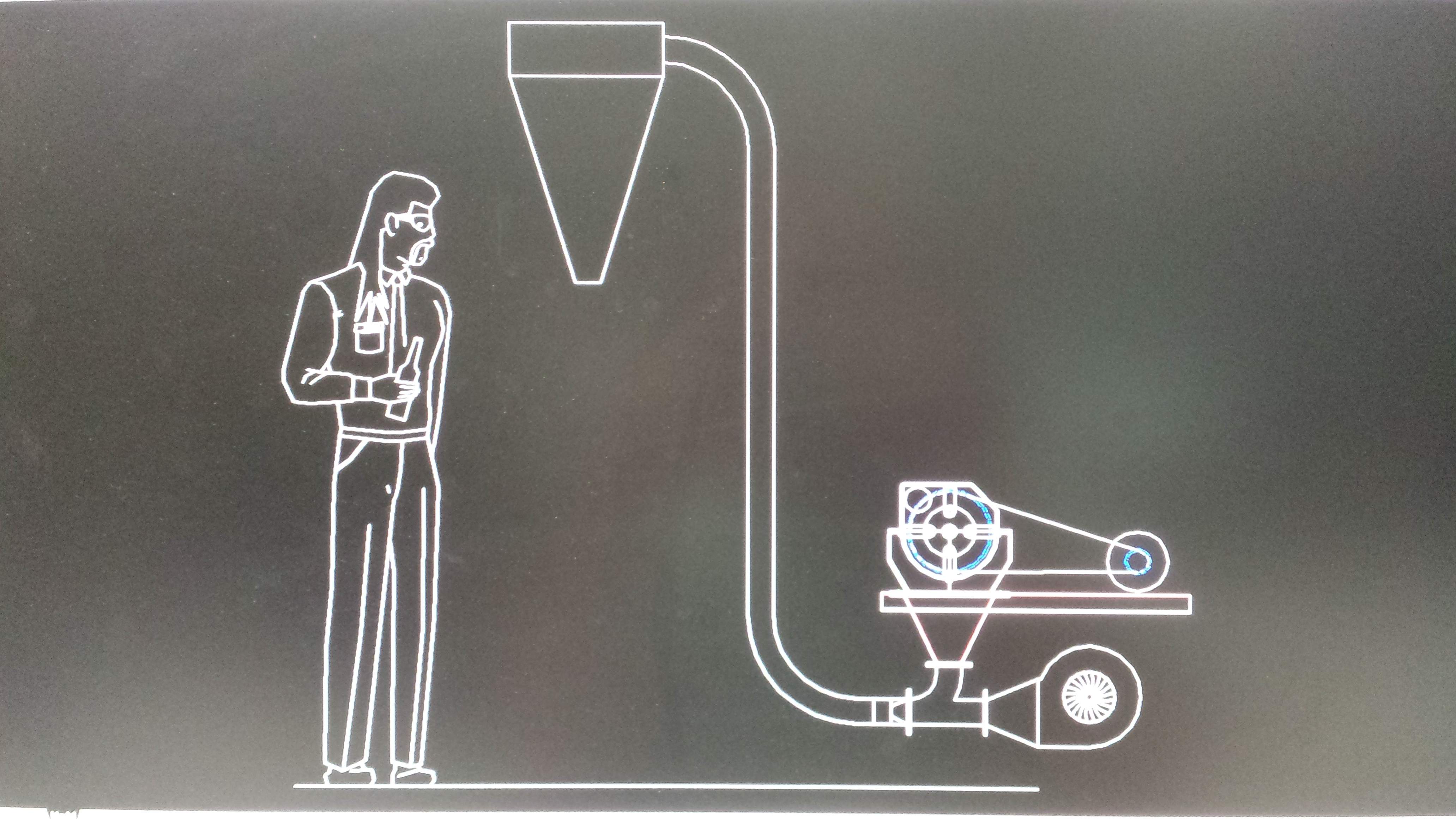

Finally, Here is a picture of my CAD drawing showing what I want to have as my final product. I plan on having a fan blow the product up to the cyclone then fall out the bottom of the cyclone. If I cant get or build a fan strong enough for that, I may build an auger to replace the fan and cyclone..
Garrett
/ homemade small hammer mill #13
most likely shop vac blowing for the fan, should work, and if all else fails just set over a trash can

I think it's awesome! Can't wait for the video. I also noticed you're holding a long neck in the CAD drawing. Nice touch! ;)
Joe
#16
Joe
Thanks!!
Haha.. That was a figure I drew up a few years ago to give a representation of actual size. The guy is exactly 6 foot tall. I modified the drawing of the guy when I was bored one day lol. I sent a small bucket of ground corn with my grandpa to take home and show off to his old farmer friends. The guy that runs the elevator/co-op in his town was amazed at how good of a job it did.. and asked me to quote grinding some corn for him for chicken feed(that elevator doesn't have a feed portion like most do). I need to figure out my capacity now, hopefully this week I can get that done still and ill post my results here.
Thanks!

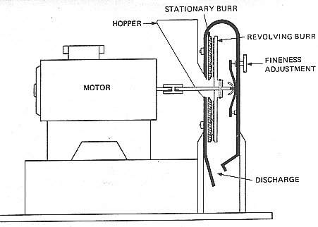

What is a burr mill? I have never heard of that terminology.
Not trying to hijack the thread, but a bur mill is similar and possibly could be used as a flour mill, and many small flour mills are build in a similar way,
the farm type used a burr (buhr) plates they were plates that have been grooved and they crack the grain and you control the fineness by the setting between the plates,
one plate is stationary and the other revolves, there is usually less dust and fewer fines than with the hammer mill,
Figure 15. Burr mill
Burr Mills
Burr mills or crushers have two roughened cast iron plates (Figure 15). One plate is stationary and the other one rotates. Grain fed between the plates is crushed and sheared. Type and spacing of plates determines fineness of the feed. Initial cost of the unit is low, but maintenance cost is high due to regular replacement of plates. These mills are better adapted to grinding coarse grains than hammer mills. However, they will not handle high moisture grain satisfactorily because of low capacity.
http://www.agriculture.gov.sk.ca/Beef_Cattle_Feeding_Systems
