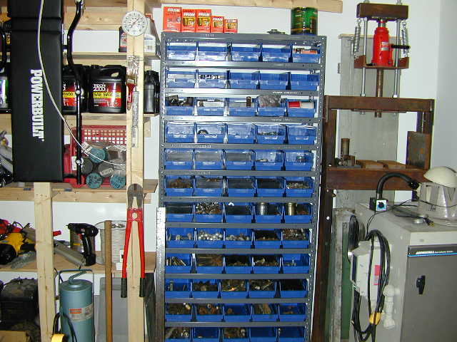

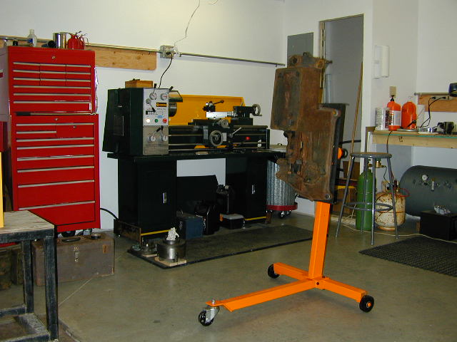

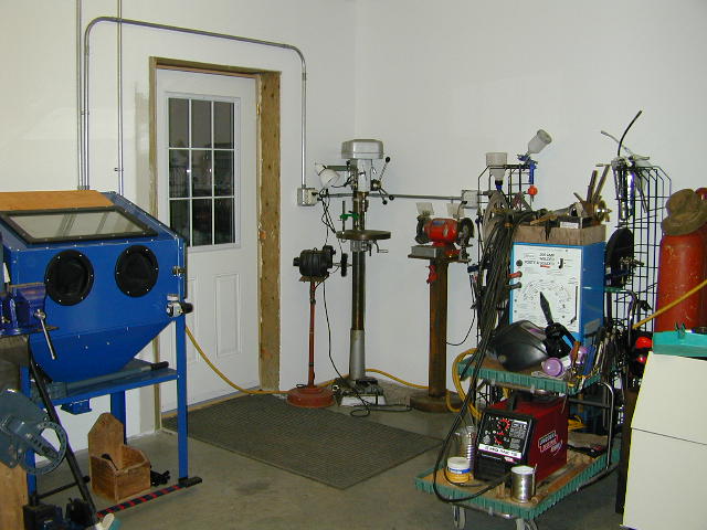

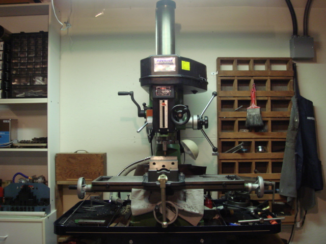

Excellent tutorial svcguy, I wonder if its not too much trouble if you could tell us about in a little more detail how you did the rest of the fabrication. Maybe some pictures of your shop and equipment. For instance how did you cut your flat stock for your rops? I don't mean to hound you but its your own fault for being such a high quality fabricator, a lot of us want to get somewhere close to where you are.
/ Homemade ROPS
#28
Not much detail to fab the ROPS. I cut the plate with oxy-propane and finished the edges with a grinder. All metal was cleaned up with a wire knot brush. Tube was cut with a chop saw. I am actually pretty lucky with what I have for a shop, but the ROPS was all pretty low tech. Attached are a few pictures of my shop, although the mill is still in the basement and needs to be moved. Missing from the pictures is the bench, power hack saw, rotary table, torches and benders. It's a home shop pretty much like everyone elses I think, nothing too earth shattering.

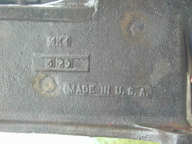

In the one shot you can see a 4 hp stover hit and miss on the engine stand. Just came out of the electrolysis tank and finishing up some detail. Oh, and a electrolysis tank.
Picture added of the stover engine block casting after electrolysis. It sat outside for 40 years before salvaging it.
