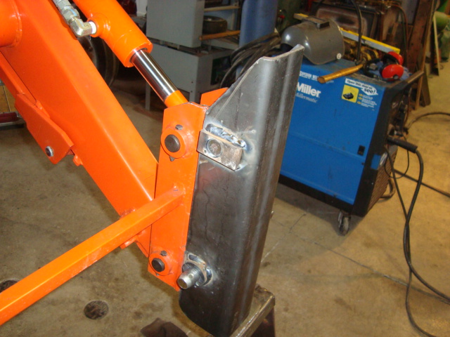

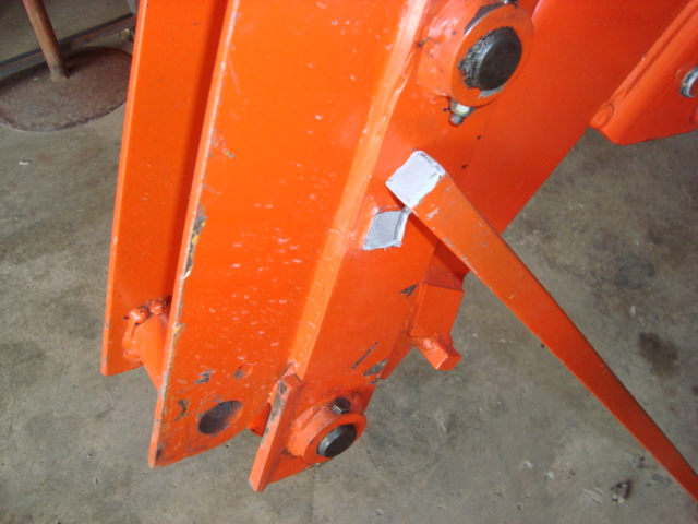

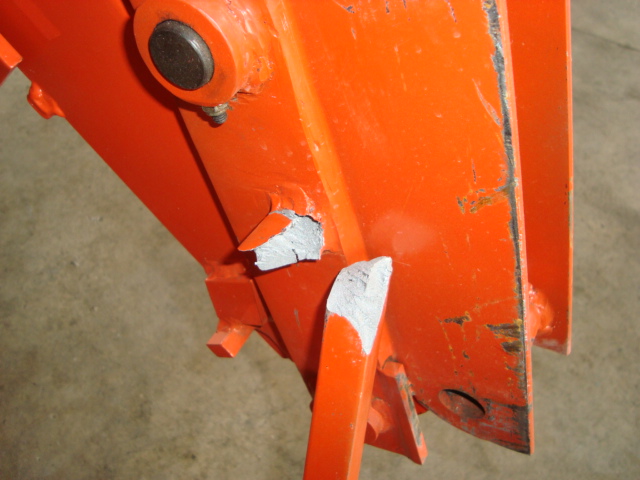

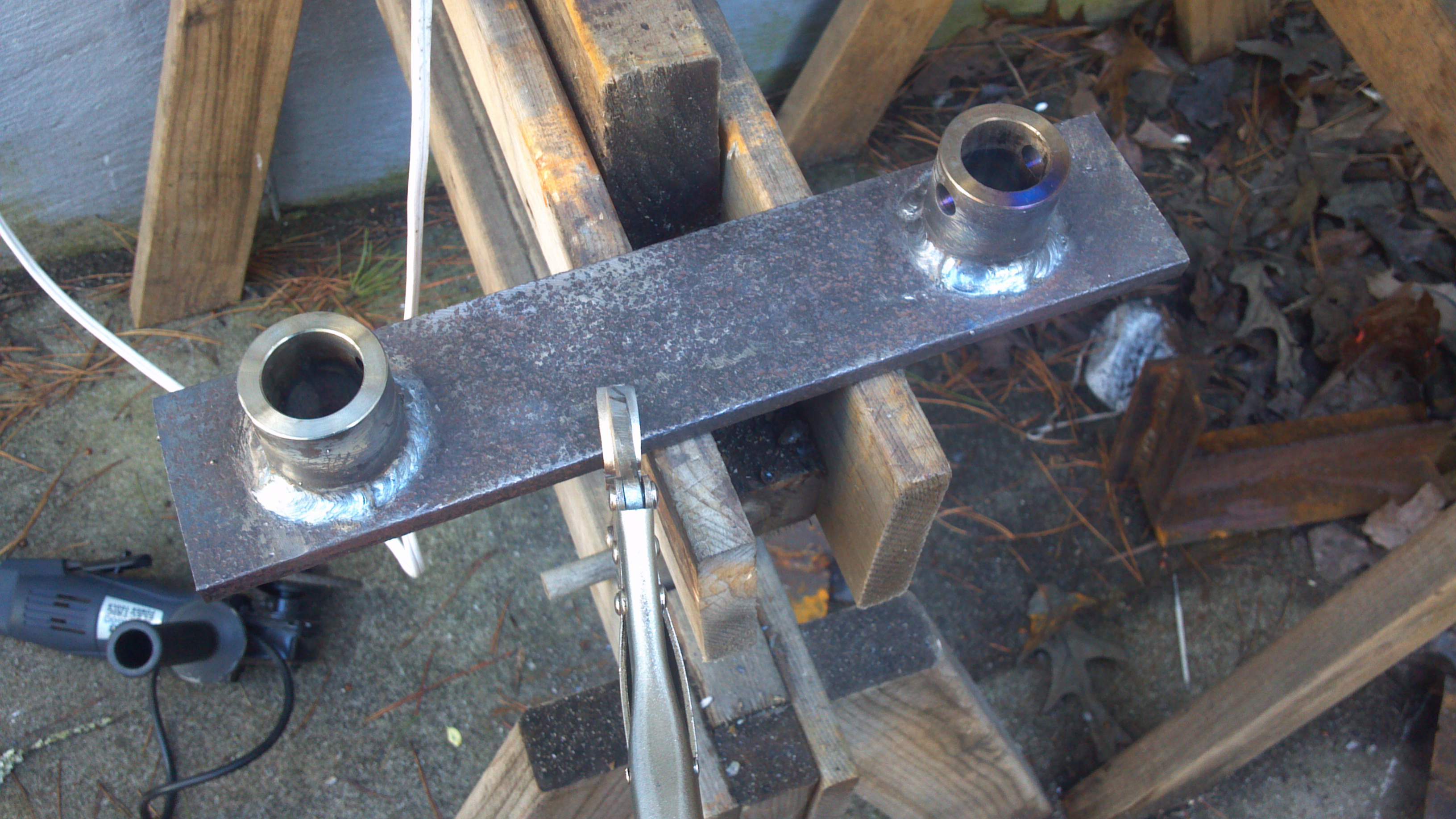

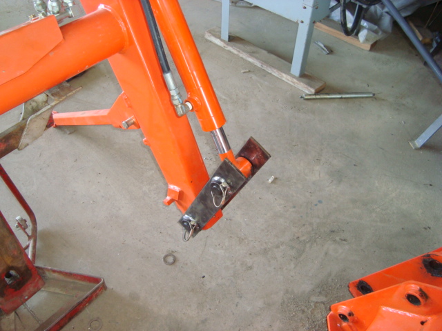

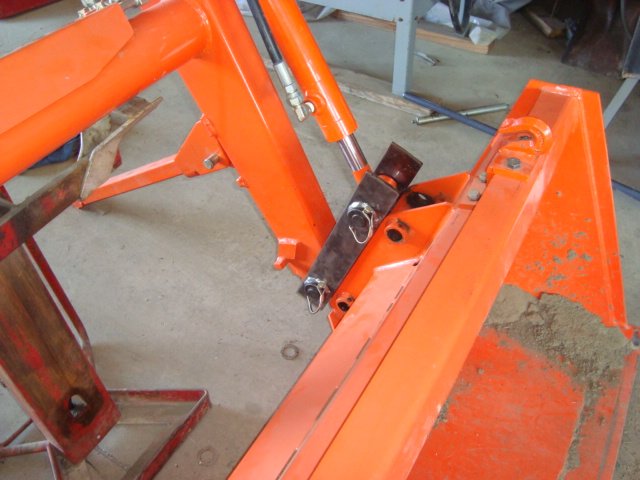

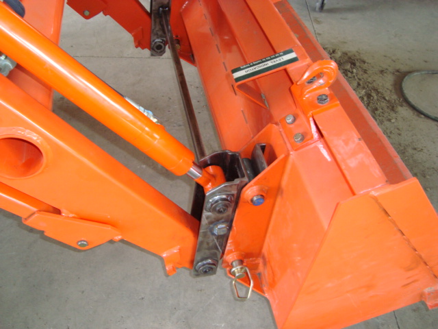

Chilly807, Glad to see that your back to work on your quick attach, I'll try to keep an eye on your build. O.K. guys, here's an update on my homemade quick attach. I'm in the process of building another bucket for my tractor. I had a pair of plates made to weld to the back of the new bucket. (a friends son works at a fab/welding shop) To keep it simple for him making it, I just told him to make the sides straight and I'l trim to fit. So during the trim stage I didn't leave enough clearance for the "roll out" when removing the bucket, just didn't see it I guess. So I'm testing the removal of said bucket and got hung up on it. After a little fighting with it, I got it free from the loader and started to back up. I looked on the ground and there is my cross bar laying there. Now me being a suave, debonair, prim and proper kind of guy, the first words out of my mouth was "WTF? For those of you that read a little bit on my quick attach know that I used a piece of spring steel for my cross bar. After looking at the breaks, I now wonder if it is a lot stronger than that. Either way, it snapped off. 600RIDER said that he used a piece of 1-¼ round stock because he said thats what Kubota used. I'm pretty sure that I have something like this in the scrap pile so now I get to do a repair on the quick attach. Lesson for the day, dont use spring/hardened steel for the cross bar.
If you look where the adaptor is pinned on at the top, you can see that there isn't enough clearance for roll out. I didn't see that until I tried removing the bucket (Doh)
Here is the broken piece.
Yeah, I think I see what you mean about not enough clearance. Right at the top where the adapter is close to the new bucket ears? It looks like about the only way to get it out would be to put the bucket on blocks and go straight down? Trimming the ears back a little should cure that.
As for the cross bar, welding it in must have hardened the steel to the point it was brittle.. PITA to replace it now, getting it cut out will be the worst part I think. Your's goes through both side plates, right? I was briefly contemplating only butt welding it to the inner plates, then decided it'd be easier and stronger to go right through to the outside of the outer plates. I'm planning to use pipe for mine. I don't have anything lying around that will work, so I might as well buy some pipe.

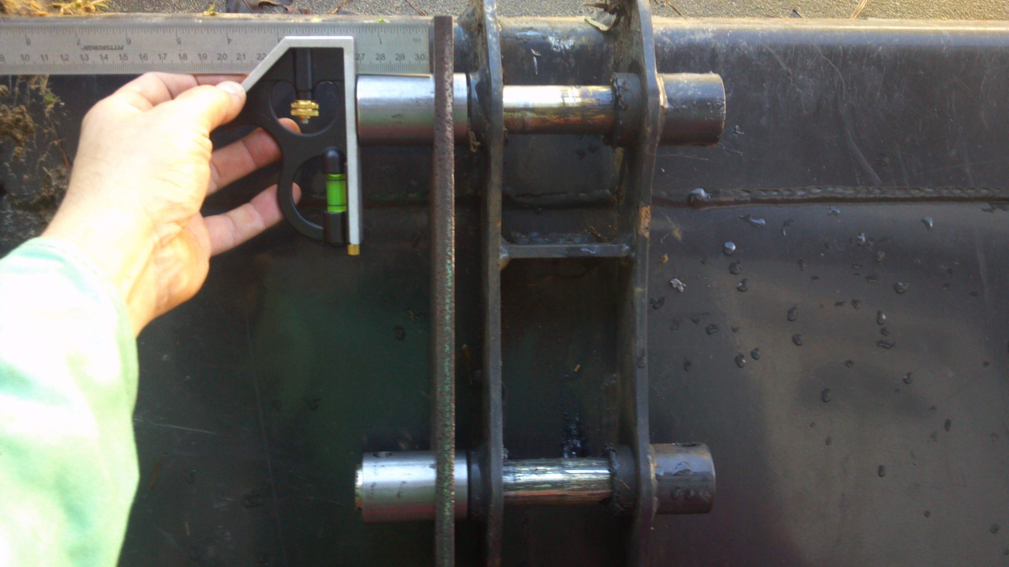

... and furthermore, this means that the "correct" alignment will be different for different people, depending on the angle of the back of their bucket. When you consider that (as far as I know, anyway) there isn't a standard for the relative angle of the back of the implement to the ground, there isn't really a universal answer either. For example, if you had a set of pallet forks, the back of the forks may be 90 degrees relative to the ground, while your bucket's back surface may be 70 degrees. There's going to be 20 degrees difference in their dump/curl, and nothing you can do about it.
Now that's something I hadn't thought of, but you're right! I'll have to take that into account when I build the frames for my bale spear and eventually a set of forks, if it looks like it may be critical. Both of those shouldn't be a problem, since a few degrees up or down from horizontal should be fine for their intended uses. The bucket is still going to be my primary tool, so I want that as close to standard as I can get it without going overboard.
Sean

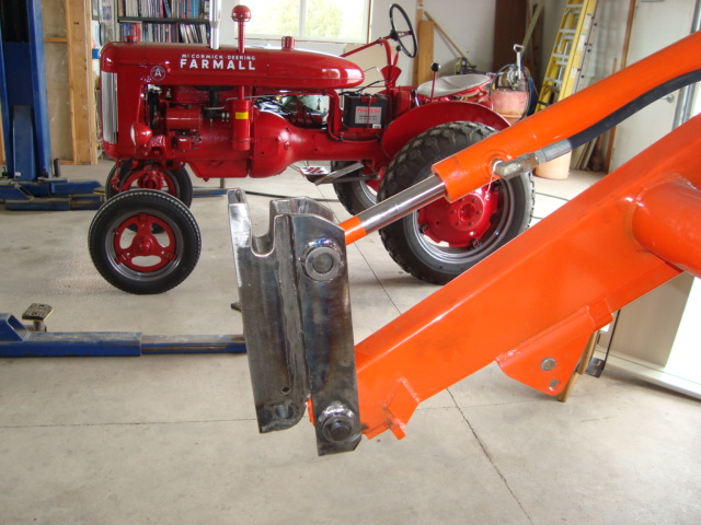

Forks and spear are less crucial than the bucket as far as the angle is concerned. You already have the bucket to work with. When you make the frames for the forks or spear, build in enough angle on the attachment side mount that you have "some" roll back when flat on the ground, the exact angle isn't as important with them.
The other comments about the offset of the holes is exactly right. With the bucket flat on the ground, you want the pins to be in the same plane. It's not so much for the angle of roll-back but to keep the forces in the same plane as originally engineered when pushing forward into a pile or digging, that's where the loader will see the most forces (usually)

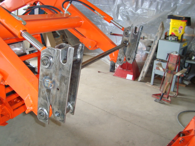

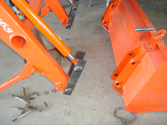

Chilly. Yep, you seen what I was talking about with the ears on the bucket, gonna fix its little red (orange?) wagon with a torch and grinder. I took the QA off of the Kubota today and torched the cross bar pieces out of it. I found a nice rusty chunk of 1-¼ solid bar stock to replace the broken one and spent almost an hour grinding off the rust. I ran out of time today to finish it. I also found another “build booger” while repairing the QA and will post what it was and how to fix it. (hopefully tomorrow) Not a full blown booger mind you, just more of a snot bubble that needs a little attention. That way you can build yours “Booger” free and correct the first time out. Ahhh, trial and error eh kids? (sigh)
