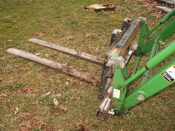

I bought these at a consignment sale for $85. The pins, hooks and re-enforcing straps were around $63 from JD. The channel was bought at an estate sale. I figure all together they cost around $160.

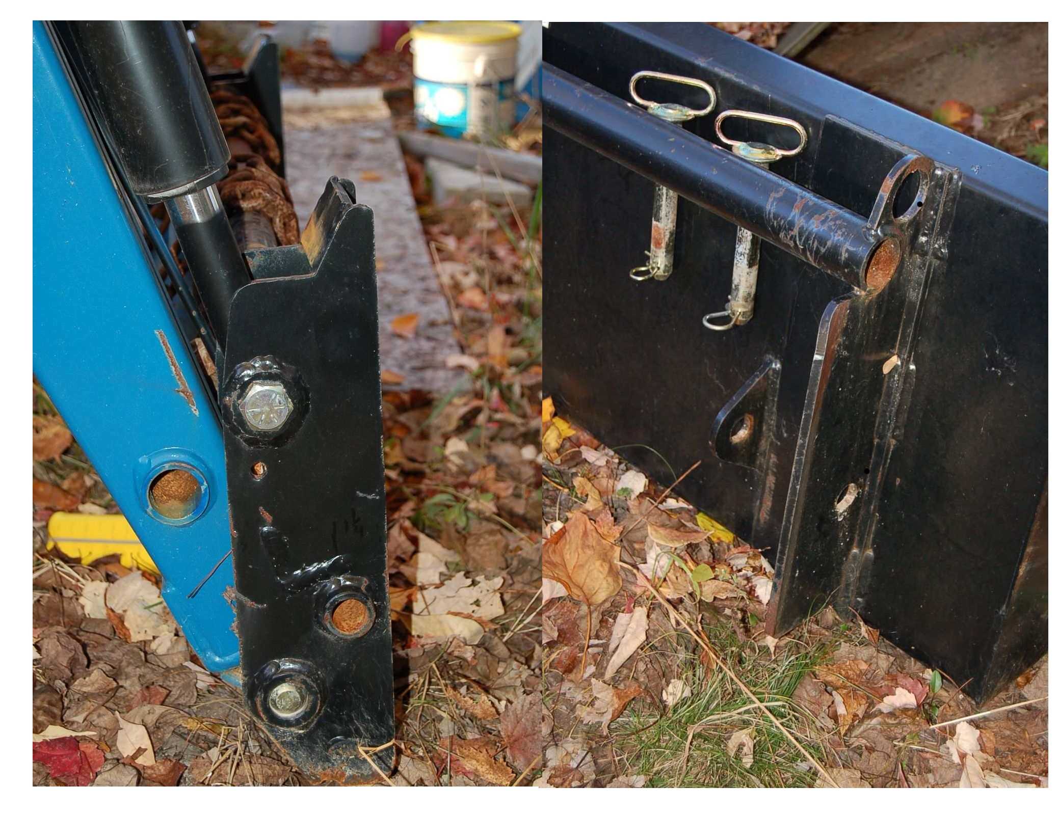

I live up by bloomington and I'd be interested in learning more of the $500 pallet fork attachment. Right now it's a toss up getting a FEL grapple or Pallet fork attachment. I'd still have to spend about $200 to get a quick attach bracket from koyker. I need to get one and take it to a weld shop to see if they can make em cheaper.. I'm sure they probably can.

Didn't know BIM was still in business. I usually go to JB salvage.. I haven't really looked for any of these, since I'm in the middle of getting a backhoe working on my tractor. I'd probably work with you and getting a QA from Markham, but if you look at the attached photo I happen to have a what appears to be a proprietary type attachment. I called Koyker in December an was quoted about $180 including shipping cost. I'd like order two of these. One to use on the Pallet frame or what ever, and another to have around in case I need more. I like to take one of QAs to a weld shop and see what they would charge to weld one up.

My bad.. I just read your message closer, any you're talking about the frame that the forks hook to not the QA frame.
That would make about $600 QA pallet fork. Not bad. Let me mull it over and keep me posted to what you decide.

I'll end up with a skidsteer QA fork setup for $75+200+105=$380. That salvage yard had one pair left yesterday, FWIW. Have you considered buying an aftermarket SS adapter to fit on your loader? It might payoff with resale value and/or being able to use your implements on your next tractor.

That's pretty cheap for the skidsteer QA fork.
Yes I have thought of converting the loader to SS type. It's just that I'd have to then convert the loader bucket to SS. I guess I need to sit down and figure out how many other implements I might want to attach to the loader.
