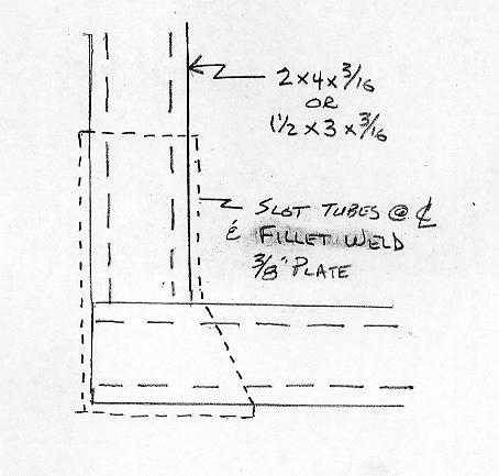

I just purchased a Kubota B2630 Tractor with FEL. I have a welder and a metal saw. I'm now considering purchasing the Kubota quick attachment for the bucket. I plan to make my own pallet forks. I will make the forks that will utilize the Kubota quick attach system. I want to make my forks as light as possible but strong enough to lift up to 800 lbs. I will make the forks 48" long. Will 1.5 X 3 x .125 be strong enough to support this kind of load?
/ Homemade Pallet Forks #2
Be careful with the 90 degree joint. There is a LARGE force there. 800 pounds at 2 feet out is 1,600 foot pounds of torque. If your tractor has 1,000 pounds of lift and someone just hooks the end of the forks on something that heavy you now have 4,000 foot pounds pulling on that joint.:eek:
Thanks for your feedback. Most of the load will be distributed evenly. I will reinforce the forks at the 90. I'm concerned that 1.5 x 3 x .125 may flex. I don't plan to lift anything at the end of the forks.

I'm picking up the steel to make mine tomorrow. I'm using 2x4 3/16 wall and thats for a BX24 that will lift less than yours. The size of yours is too small in my opinion...why not go with the bigger stuff? Cost and weight isn't that much more to be safe. Weight of the 2x4x3/16 is 3 lbs more a foot than the 1.5x3x.120< note my spec sheet doesn't show .125 as being "standard". Or if you really want 1.5x3 the 3/16 wall only adds 1.5 lbs a foot....
20' stick of 2x4x3/16 is $105 locally.
/ Homemade Pallet Forks #8
I've seen this joint stiffener used quite a bit when structural engineers want to beef up the tube steel connections in buildings. The tubes are slotted for the internal gusset. The gusset protrudes the outside face of tube by the width of the fillet weld, in this case 1/4". All the meeting faces of the tube to tube surfaces are welded (bevel the vertical tube for full pennetration) then both sides of the gusset is fillet welded.
The joint can be even stronger yet if a cap is welded on the horizontal tube.
And stronger again if the vertical tube is set with the wide dimension running in the same direction as the "fork" tube. IE. sketch is drawn with both narrow faces in the same direction. Rotate the vertical tube 90 degrees and the narrow face shows on the horizontal tube and the wide face shows on the vertical tube.

Thanks very much for all the information. Yes I was thinking of 1.5" X 3" X 1/8". Maybe I should go with 3/16" instead. I may also make the forks 36" or 42" long. I was going with 1/8" to keep the weight down. It would also be easier to work with(drill, cut etc.).

I would be very concerned with 1/8 inch for a lifting application. Not to say it CAN'T be done as we all know strength of the material is directly proportinate to the amount of stress we put it under.
For my puropouses under no circumstances would I attempt to use anything smaller than 1/2 inch material for forks.
I am a bit of an odball as I break everything I use at some point. What I think you need to be more concerned about than the vertical lift is the push load applied to the forks when they need to push into or under something. your tractor moving forward will exert far more pressure that your lift capacity.
Lastly If you are near southeastern Indiana I have a distributor that sells brand new 48" pallet forks (real ones like you use on a forklift) for 150.00 a set (that is 2) I ended up getting my entire rack and fork set from him for under 500.00 Figuring my time and materials I couldn't build it that cheap.
Forgot to mention in my first draft of this. Some may say that the manufactured pallet forks are not 1/2 inch thick for the smaller ones. This is correct, but the reason is they are a tempered material. the same thickness of material in cold rolled dosen't have near the strength as the material they use. I have had to blow holes in the end with a torch because I couldn't get through them with a cobolt bit.

My loader arms are not 1/2 inch they are 1/4 tube and gussested at every bend and doubled by 2 (two arms). I don't want to argue engineering, heck I probably spelled it wrong, but comparing the forks to the arms isin't compariing apples to apples. If you are only lifting 400lb I guess it would be fine, for my purpouses A real pallet fork is the only way I can go.
1/8 box is much stronger than plate, but I still think it is gonna fold up. These smaller tractors may not put that much force on them. The smallest thing I have is 57hp. It may be fine for his purposes. I had a 155d Yanmar years ago and it had more Hydraulics than the tractor had weight. I was routinly amazed with the ability and wouldn't want to weight it down with "real" palet forks. But I think 1/8 box woul be be found lacking on it.

My tractor is 26 hp only with a lift capacity of approx. 800 - 900 lbs. I know it will likely lift much more. I'm amazed at the strength of 1/8" tubing but will go with 3/16 or 1/4 tube and keep the forks around 36" long. I will make fork extensions to lift my docks.
