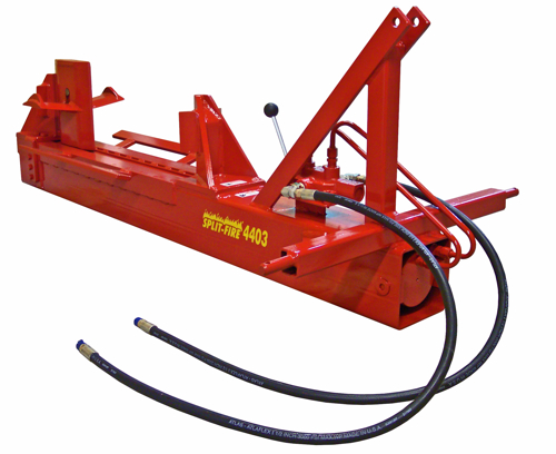

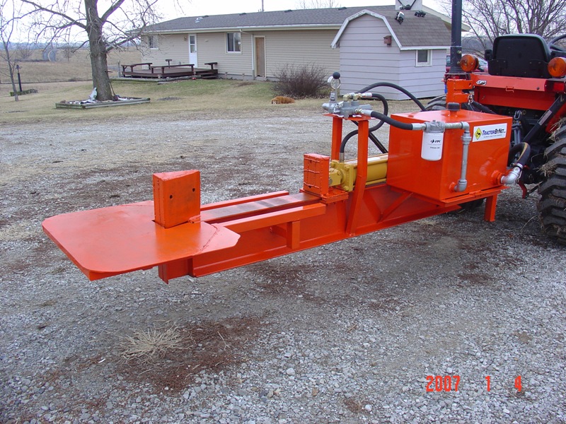

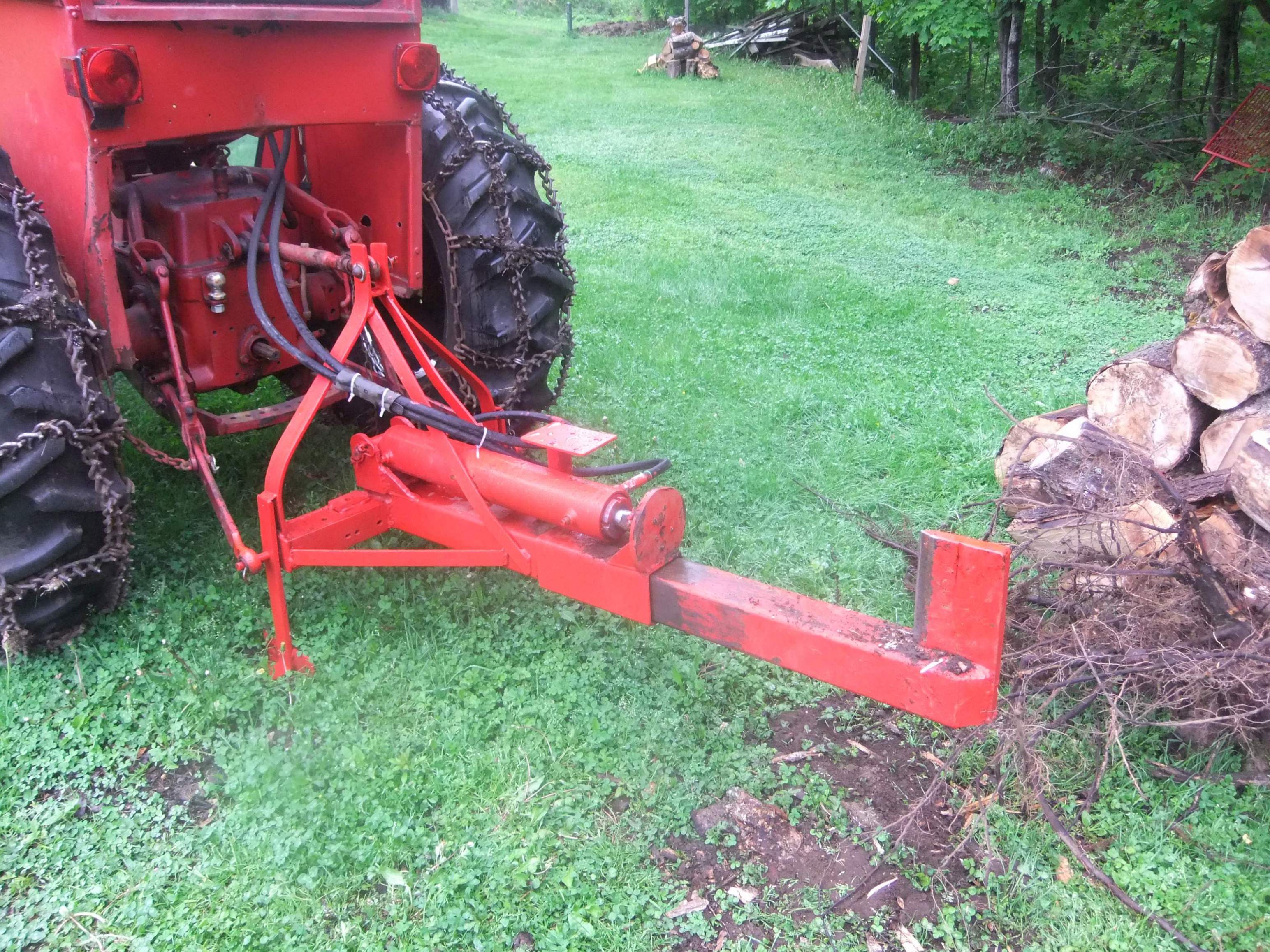

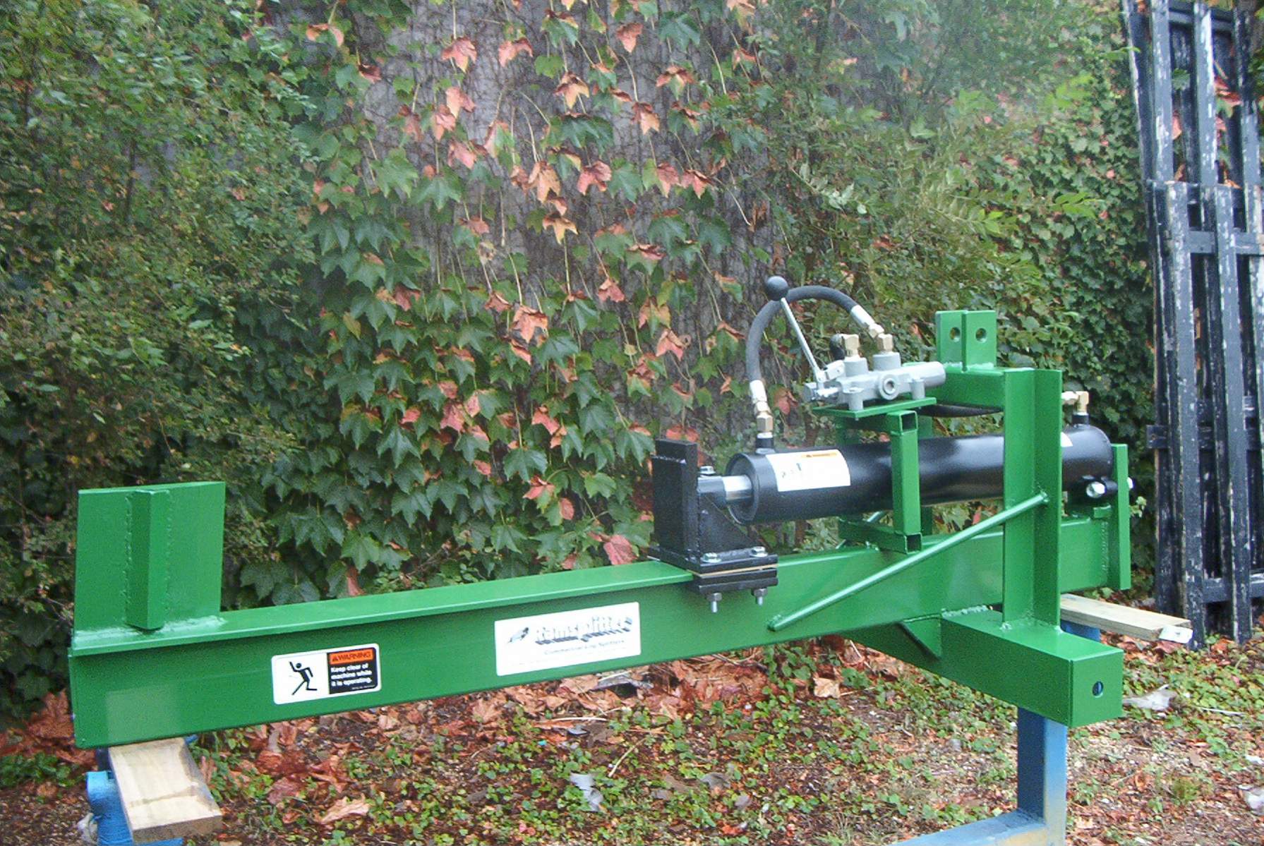

Here are a few 3pt log splitters to give you some ideas.
The first splitter is using his tractor for the splitter, but not a good idea. The others have their own valve.
The second red splitter has the hyd cylinder inside the tube, and the wedge moves back and forth to split both ways.
The last splitter is using a PTO pump for the hyd.
