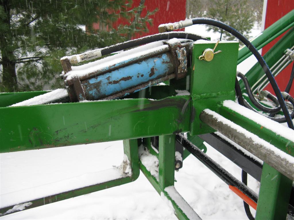

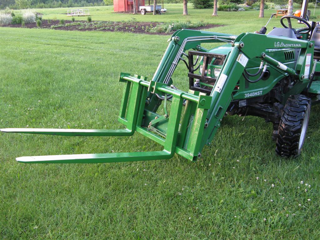

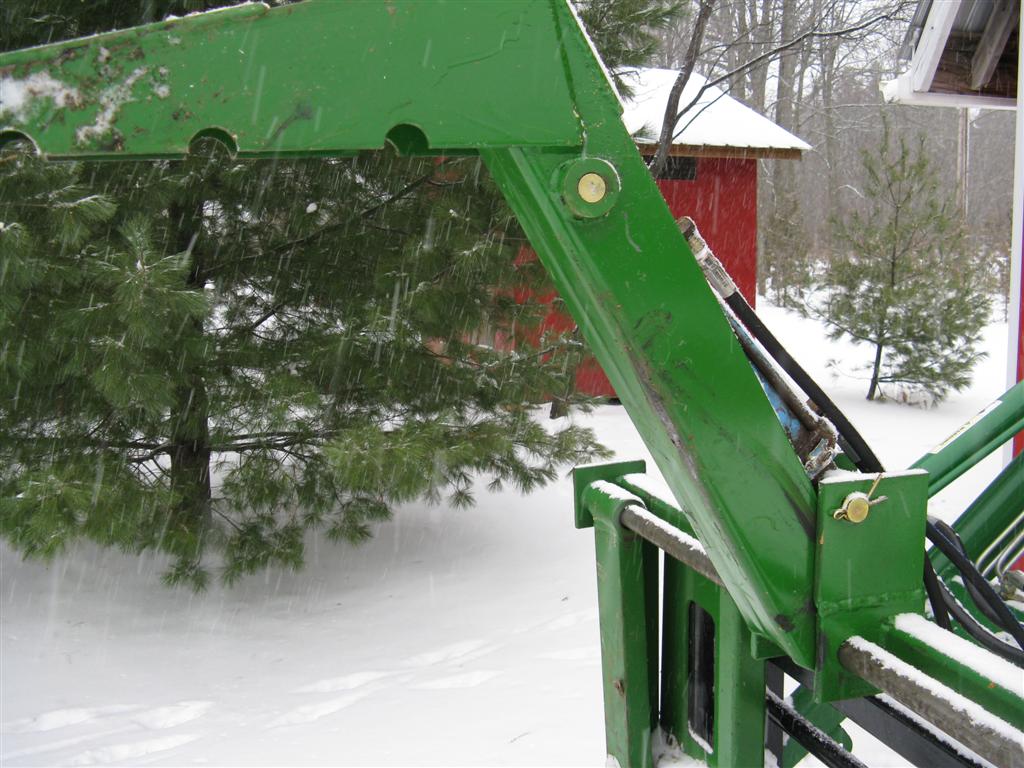

Grapple Homemade Grapple with pics and video
   / Homemade Grapple with pics and video #11
Very nice setup.
works wonderfully :thumbsup:
   / Homemade Grapple with pics and video #12
there are 2 common ways
1) run hoses all the way to the rear of the machine and use a rear remote.
2) use an electric diverter valve.
you can search for the diverter valve, its been written up many times with lots of good pics and ideas on how to actuate it.
