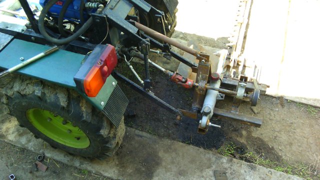

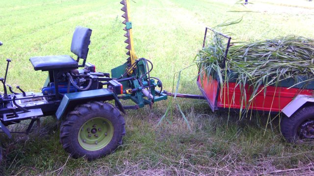

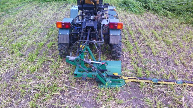

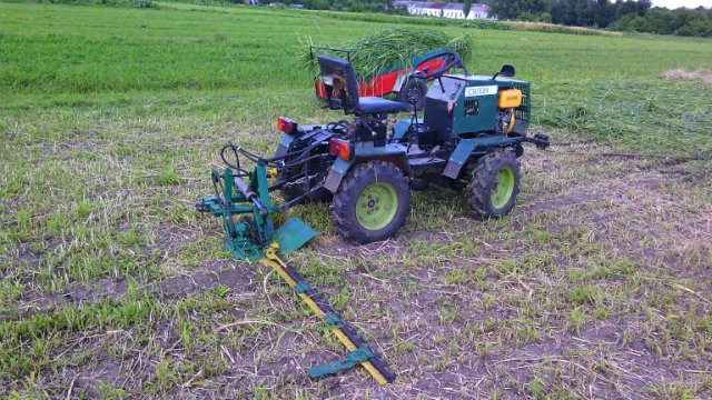

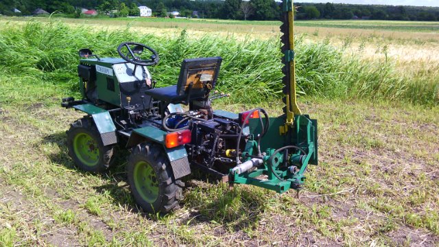

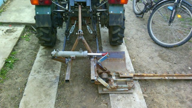

Also during this time I built a new mower with hydraulic cylinder.
5b29437673a0.jpg ba4c22ab11fb.jpg 32be8a9fcbd0.jpg 9c367b8549eb.jpg 9f54101c268a.jpg 72721ceb5abb.jpg dc6de7c6ff59.jpg

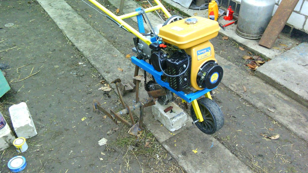

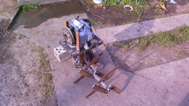

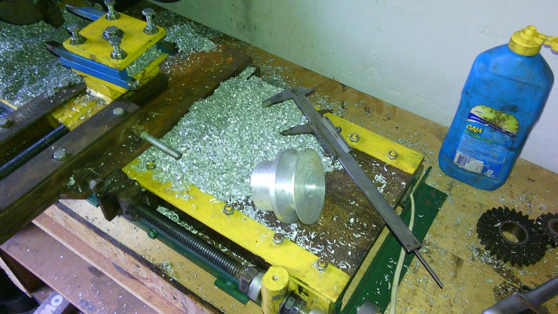

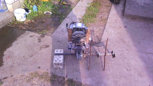

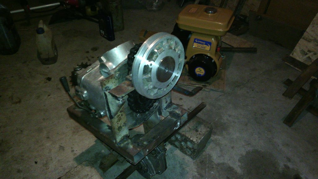

Hi. For my homemade tractor daily is work .

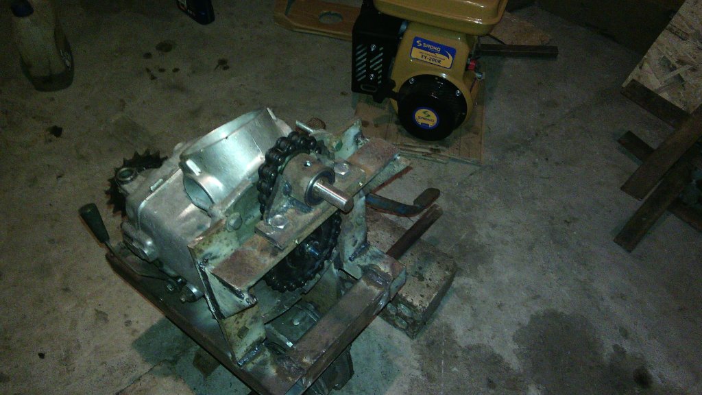

I graduated from my new project built homemade walk-behind tractor. Chinese Engine 5.5 horsepower, transmission of the motorcycle.
Walk-behind tractor has this description:
speed
1 - 5.4 km/h;* 2 - 8.6 km/h;* 3 - 11.5 km/h;* 4 - 15.1 km/h;* Reverse - 5.3 km/h;
speed cutter
1 - 51 rev/min;* 2 - 81 rev/min;* 3 - 112 rev/min;* 4 - 144 rev/min;
9001d11a65da.jpg ef4e2b75bc18.jpg 35f04f57af1b.jpg 2556aa0a5adb.jpg 777f78a07113.jpg ba3650ee0977.jpg 8c1f15c0f8db.jpg 0db0d34dd5f0.jpg 04382bd36c80.jpg 560cce2dd3ad.jpg 8120ff1f2fea.jpg ba3f61ddb41a.jpg 0a54b1d67767.jpg 84ca9d16c924.jpg
